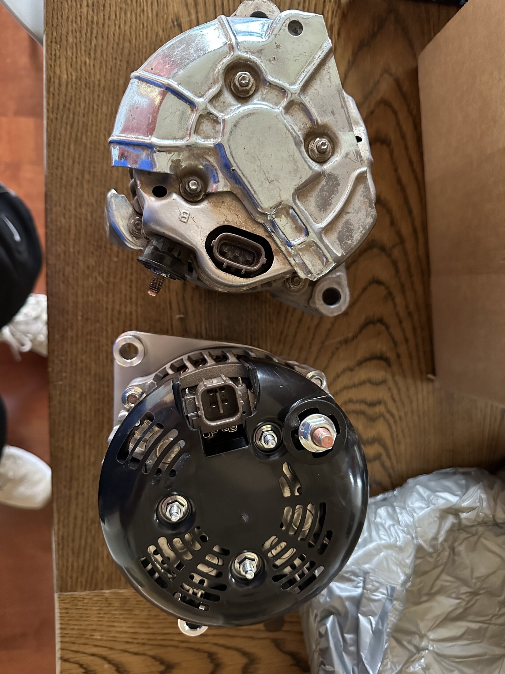

I used a BNR Alternator from eBay and have no issues.
(One 100AH in cabin and Group 49 in stock location under hood)
The BNR units are made in USA and seem well-built.
You want the 3-pin and not the 4-pin for your rig in your sig.

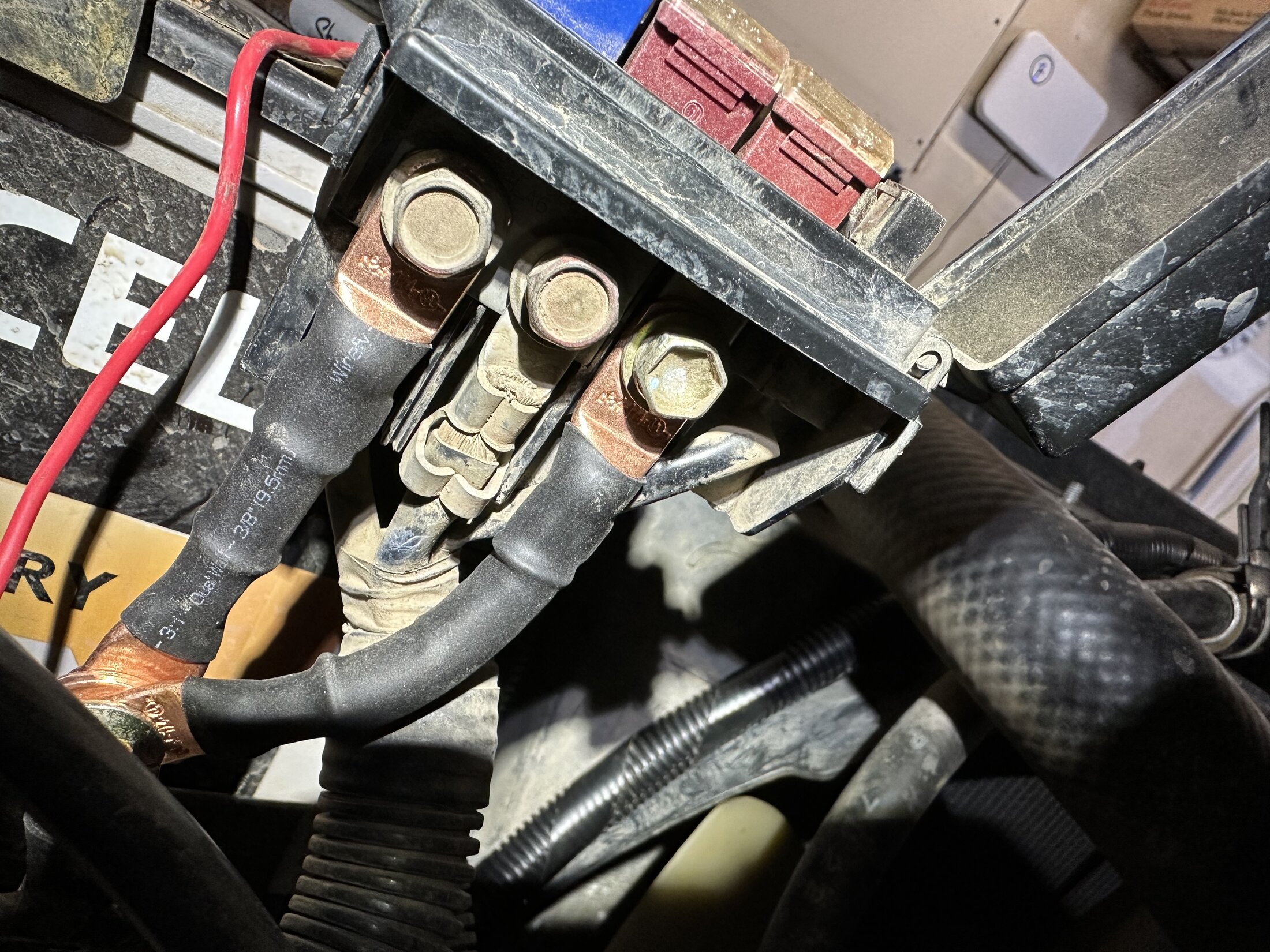

Did you upgrade anything else when you installed this? Grounds, main power feed wire, fuse, etc?
Yes, I ran an additional 2 gauge (welding cable) alongside of the main factory power feed (no fuse since the OE doesn't have one) and "the big 3" electrical upgrades.
Both the OE and 2 ga cable will fit on the back of the alternator and the terminal block near the battery.
I did make sure grounds were sanded to bare metal and I'm running the "alt-s" fuse mod = bumps voltage up 0.5VDC.
Copper lugs on the welding cable and heatshrink the ends.
Hammer crimp tool for lugs.
Hope this helps!

I also upgraded all the big wires and the wire from the alternator. And added another fuse and path for juice to the battery. I think that alternator fuse at the battery was rated at 100A, and the new alternator could potentially supply much more than that. I also had to wire in a new plug at the alternator.
Hope this helps!
