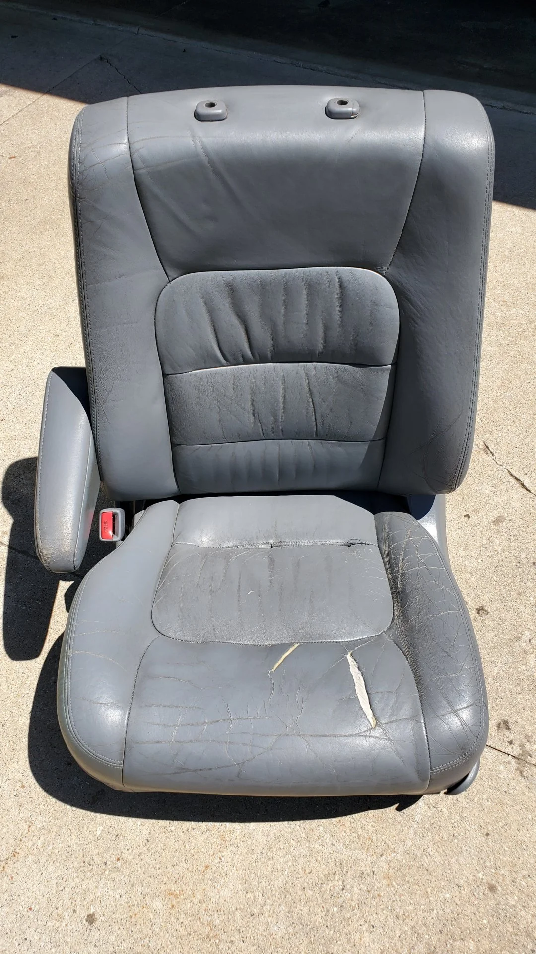

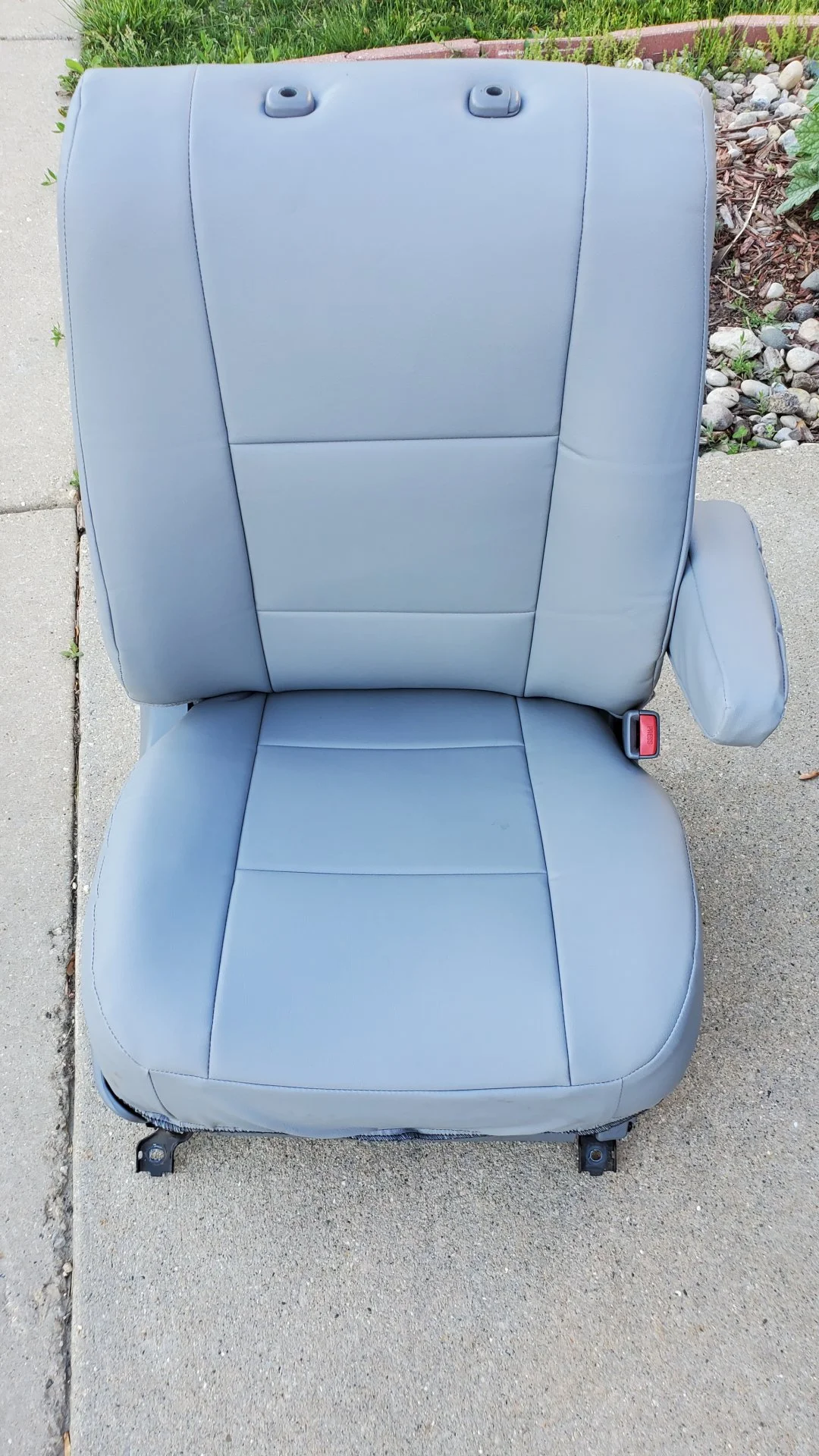

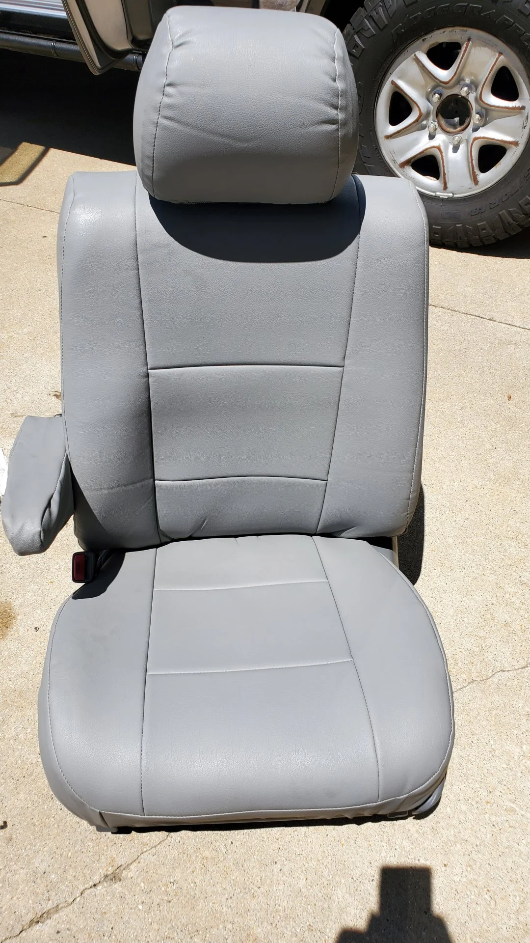

New seat skins/covers came in the mail. These are custom made for our trucks and are really hard wearing (I have used then on my other one too!l
Before and after

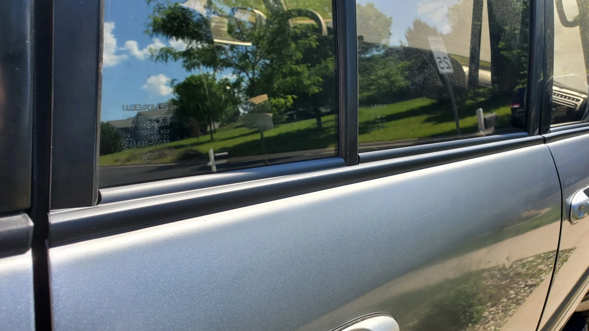

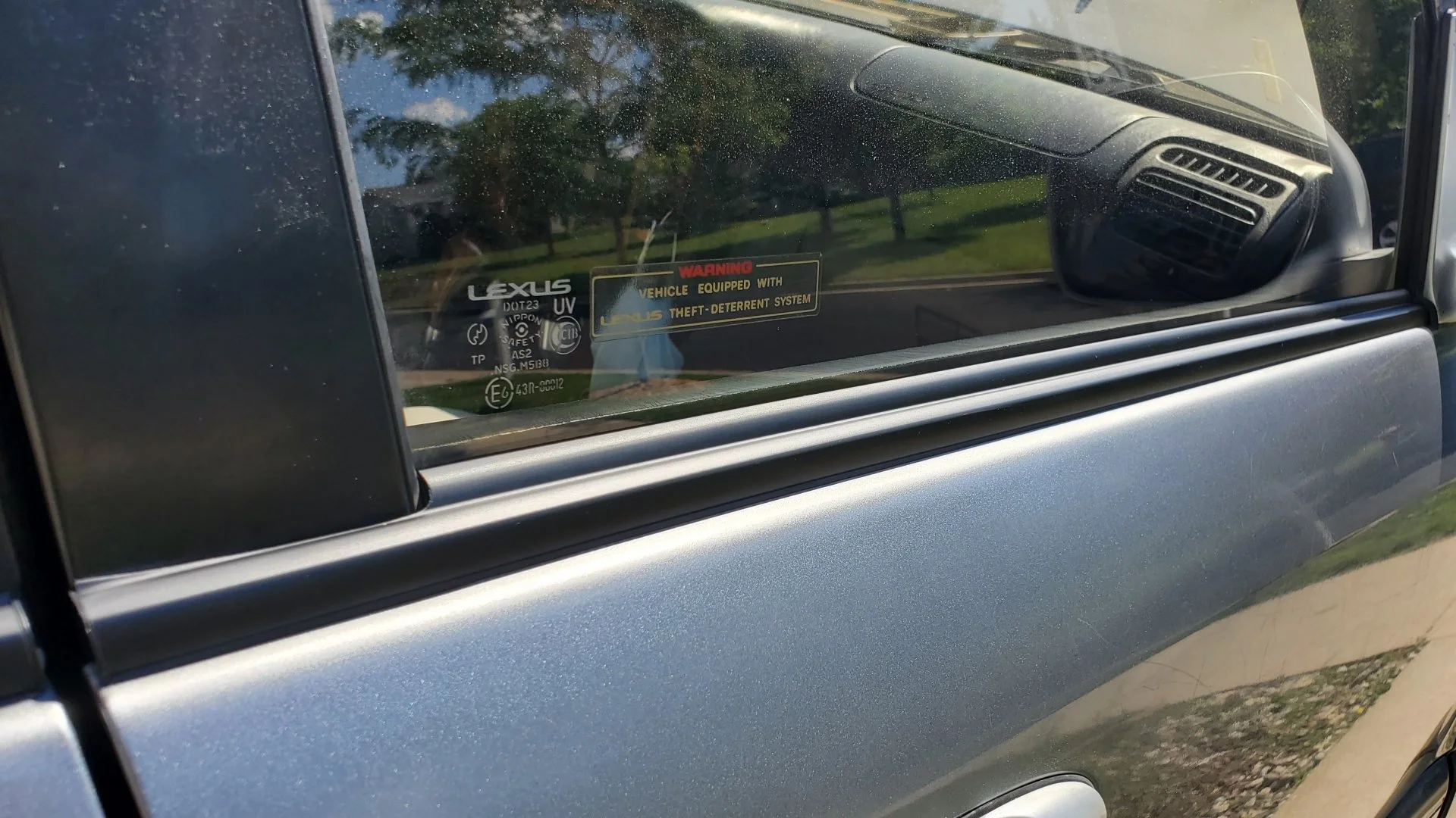

First order of the day was to replace the belt molding on all four doors:
Parts:
75710-60061 MOULDING ASSY, FRONT DOOR BELT, RH
7572060061 MOULDING ASSY, FRONT DOOR BELT, LH
7574060041 MOULDING ASSY, REAR DOOR BELT, LH
7573060041 MOULDING ASSY, REAR DOOR BELT, RH
This video was very helpful:
Before and After:

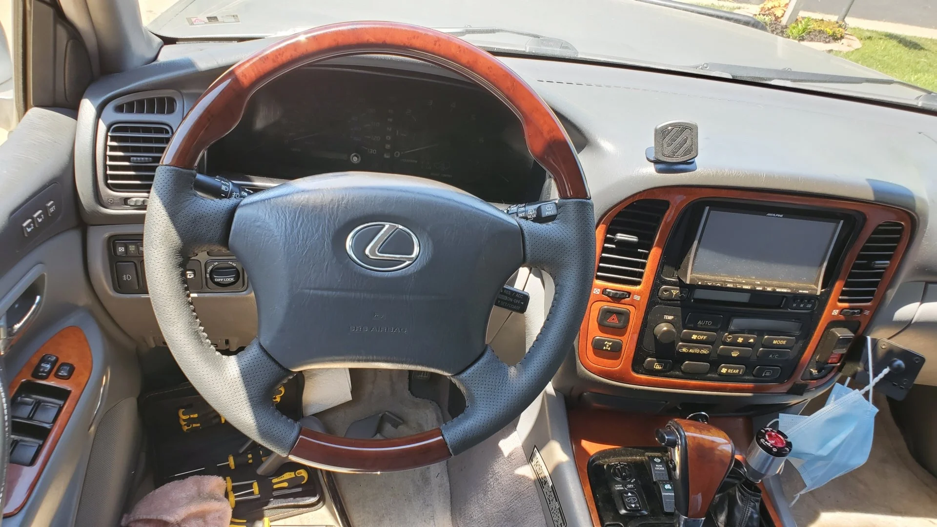

The new steering wheel matches the rest of the interior almost perfectly!

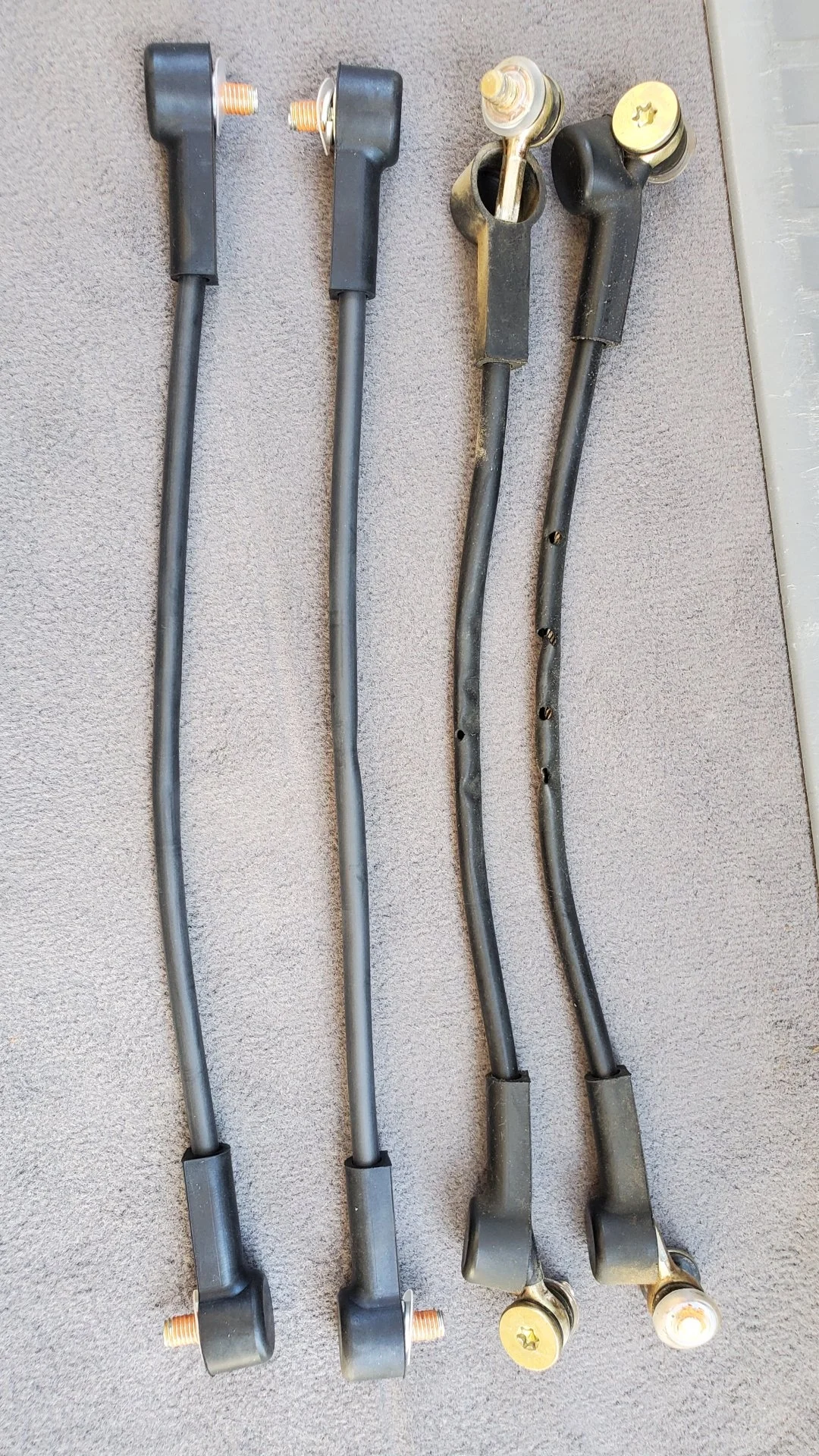

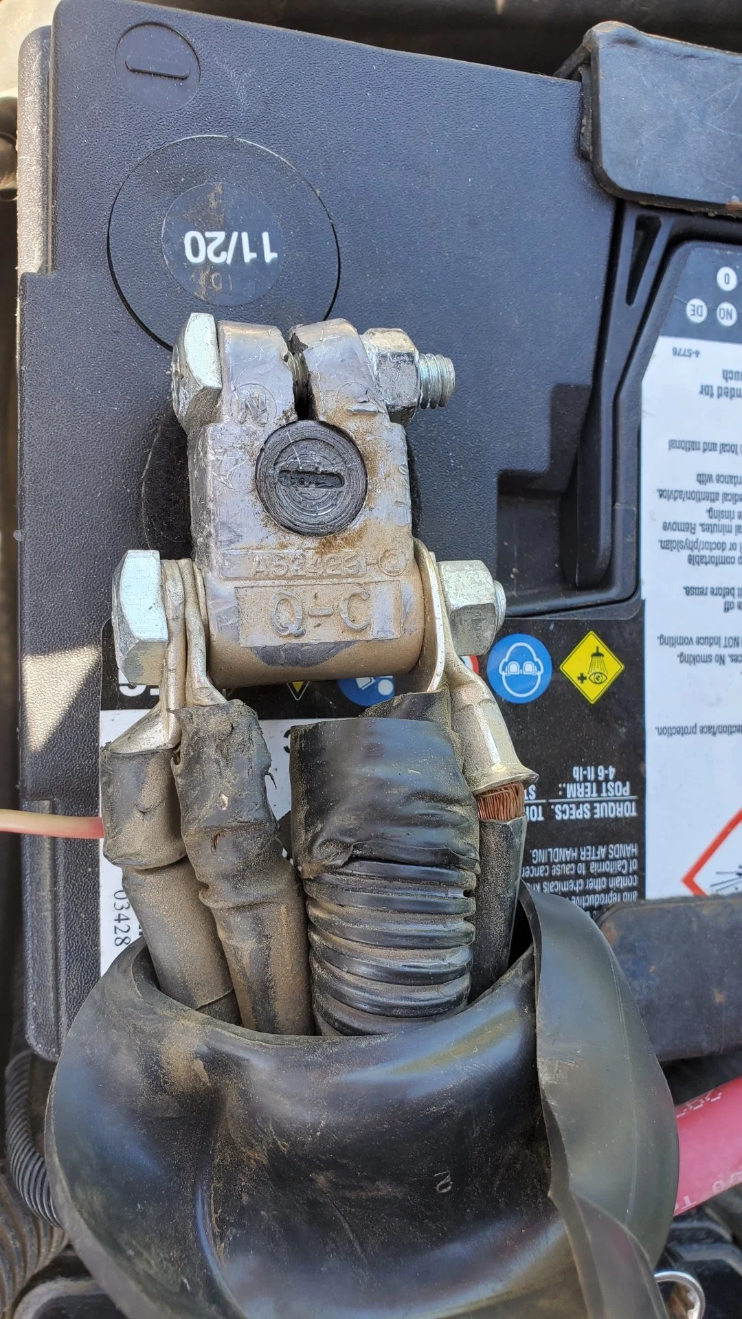

Replaced the battery terminals on primary battery. It's now much cleaner and better organized!
Very clean battery terminal set up! I've thought about changing out to that type of terminal but have been nervous about the material they are made of. Did you have any concern of stripping out the material when tightening down the cap screws?
These are actually threaded studs with with nuts - and no they seem plenty strong. I was not gentle with tightening them because I can easily return them on Amazon if they break!
The main body appears to be machined from a single piece of aluminum and the hardware appears stainless steel (not 100% sure on that one).

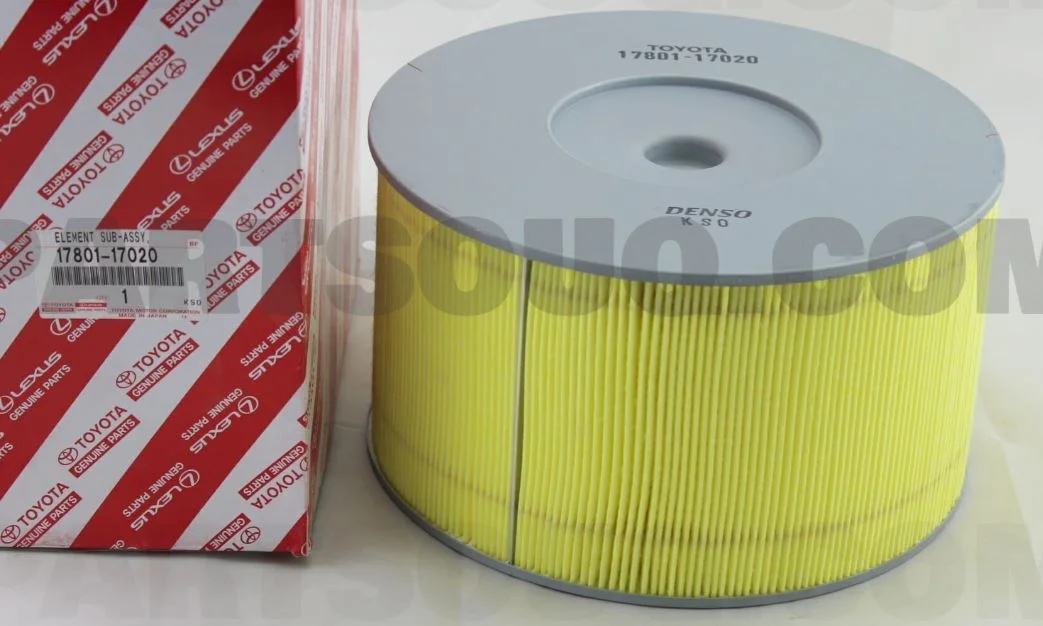

  • replaced the air filter on this HDJ-100 version cyclone air box that PO installed.

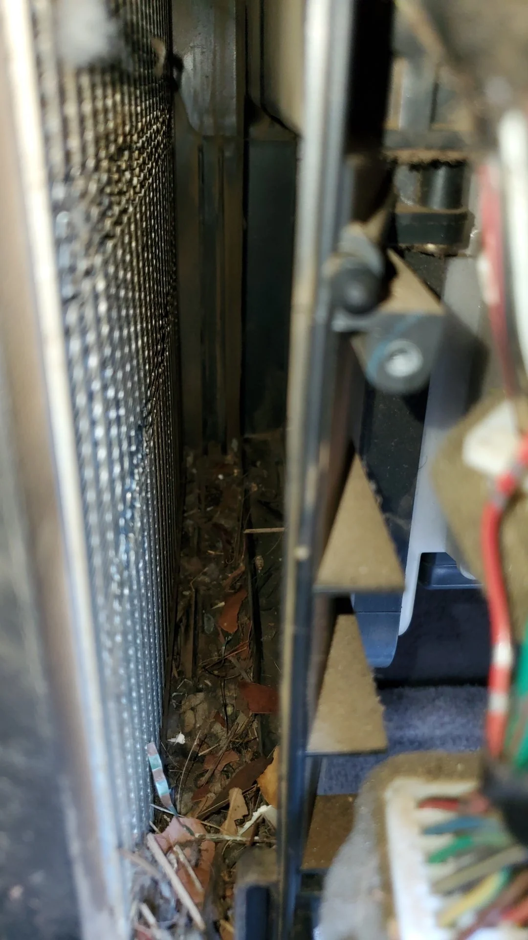

  • pulled AC filter cover behind the glove box because the seal had failed and it was leaking water on the passenger footwell. Found a ton of mouse turds and other crap in there, cleaned it all up and put in a pair of charcoal activated filters in there. Used the Toyota FIPG to make new seal. Hopefully this will be the end of foul smell in the cabin.

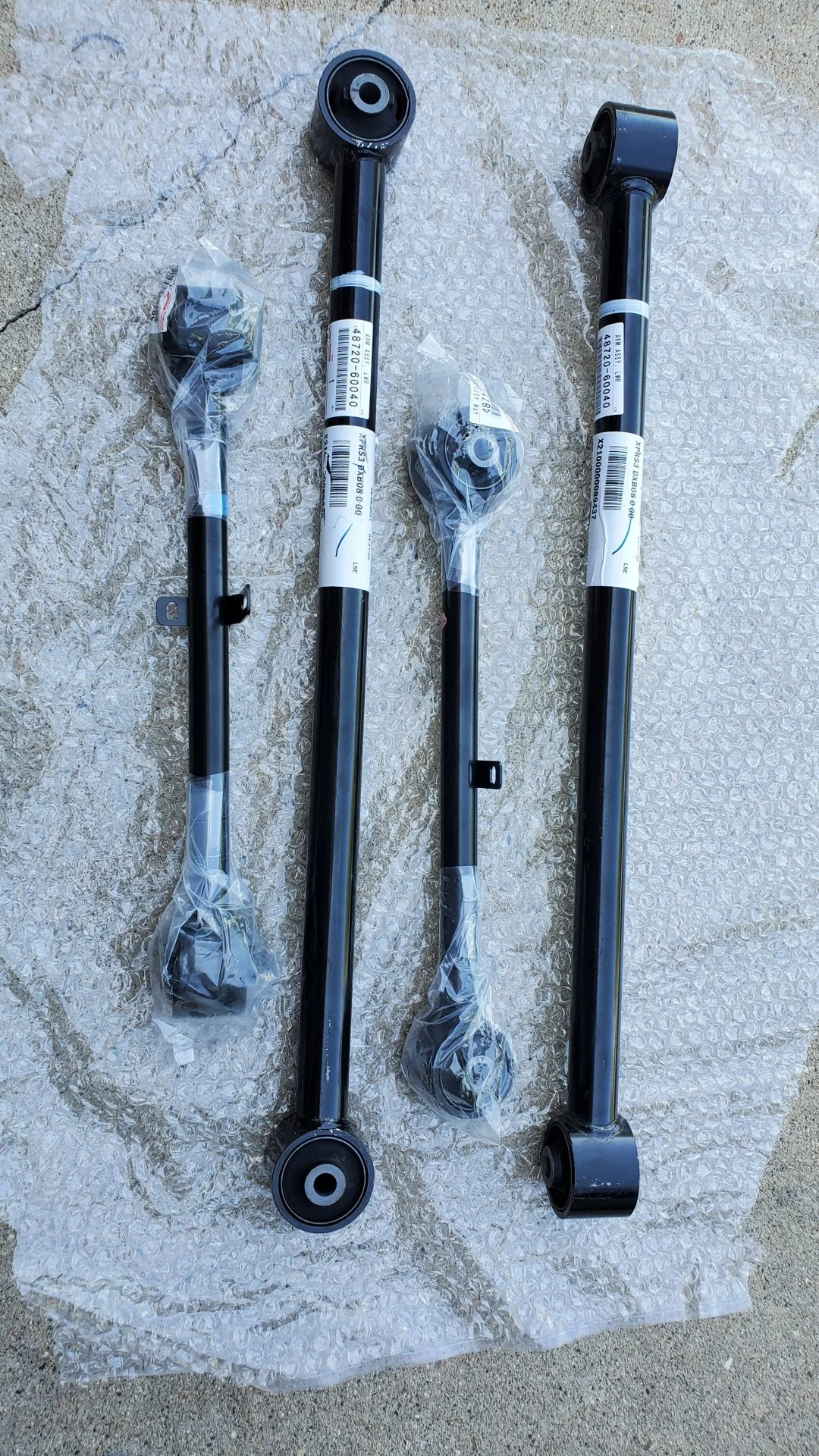

I was hoping the the rear end jiggling side to side at the slightest provocation would be cured by the new rear control arms (well 3 of the 4 new control arms) but unfortunately that is as bad as ever. Since the AHC pressures are within range, I am wondering if the rear is over-spring by the LC springs instead of LX specific weaker springs!
I plan to replace the one remaining left rear UCLA, then disconnect the temp sensor for AHC pump and then check the pressures again.
