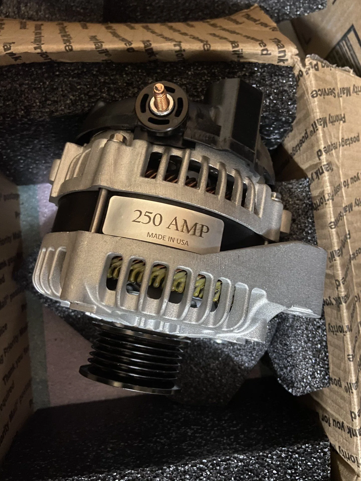

Well, I decided to swap out my OEM alternator with a brand new made in USA unit from the people at BNR
I got the 11087 for my 2004 LX = 250A (4 pin connector)
BNR did a great job packing around the alternator with numerous pieces of high density foam to insulate during shipping.

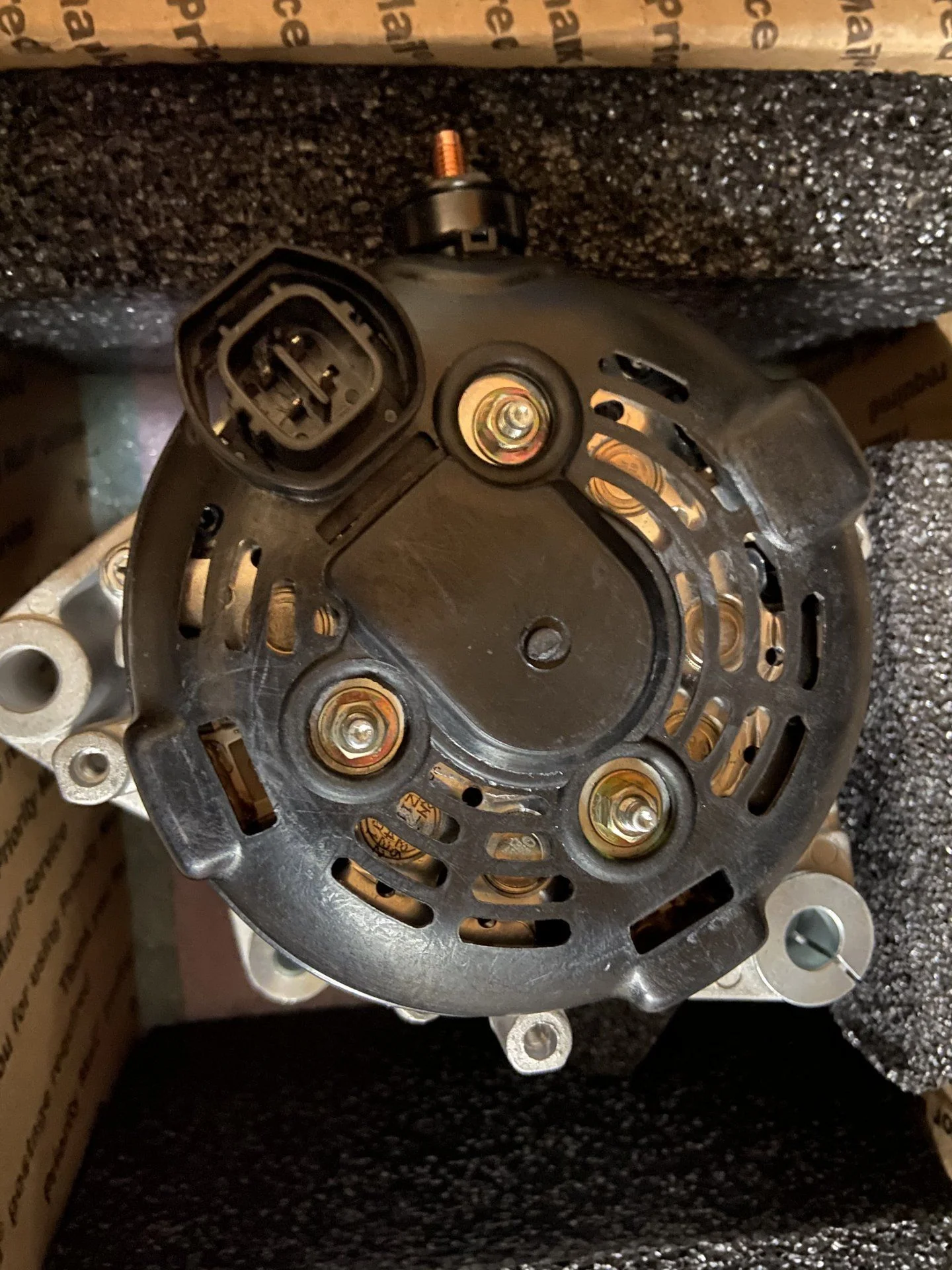

I also installed a 2GA copper welding cable (made in USA) with copper crimp on terminals in addition to the existing factory positive cable.
I was even able to get the plastic protective cap to fit back on the alternator even with 2 cables.
I routed my 2 GA cable right along side the factory cable, secured with zip ties and back to the battery.
