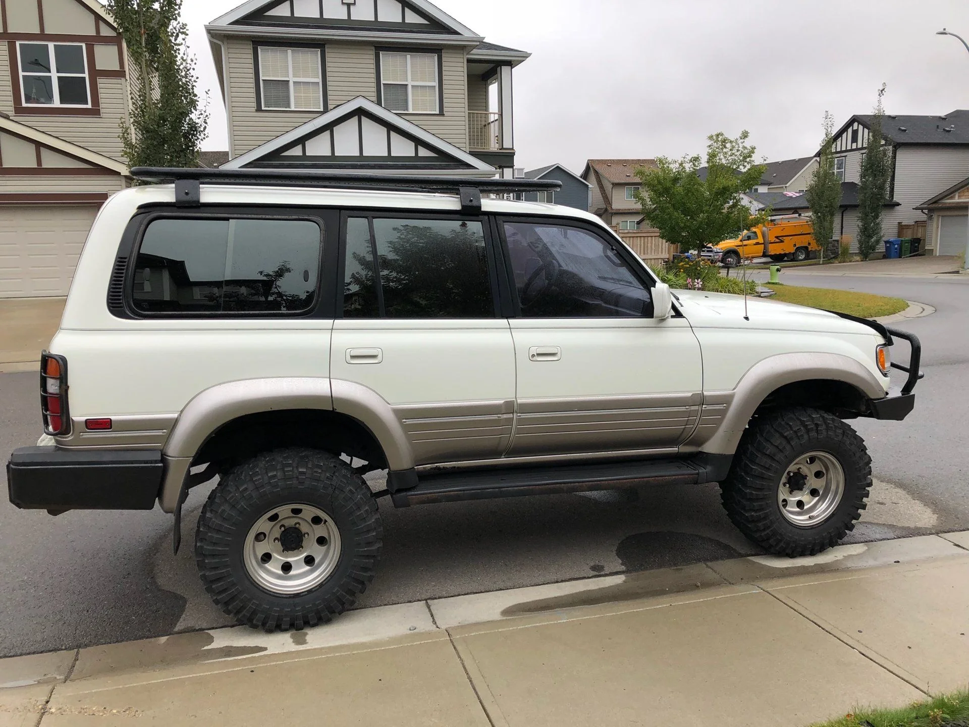

After a few months I came across this
1997 3x locked Lexus lx450.
6” slee
35” bias ply Trepadors
Arb bumpers front and rear
An extremely clean frame and body
I almost instantly fell in love. Despite the clear work it needed.

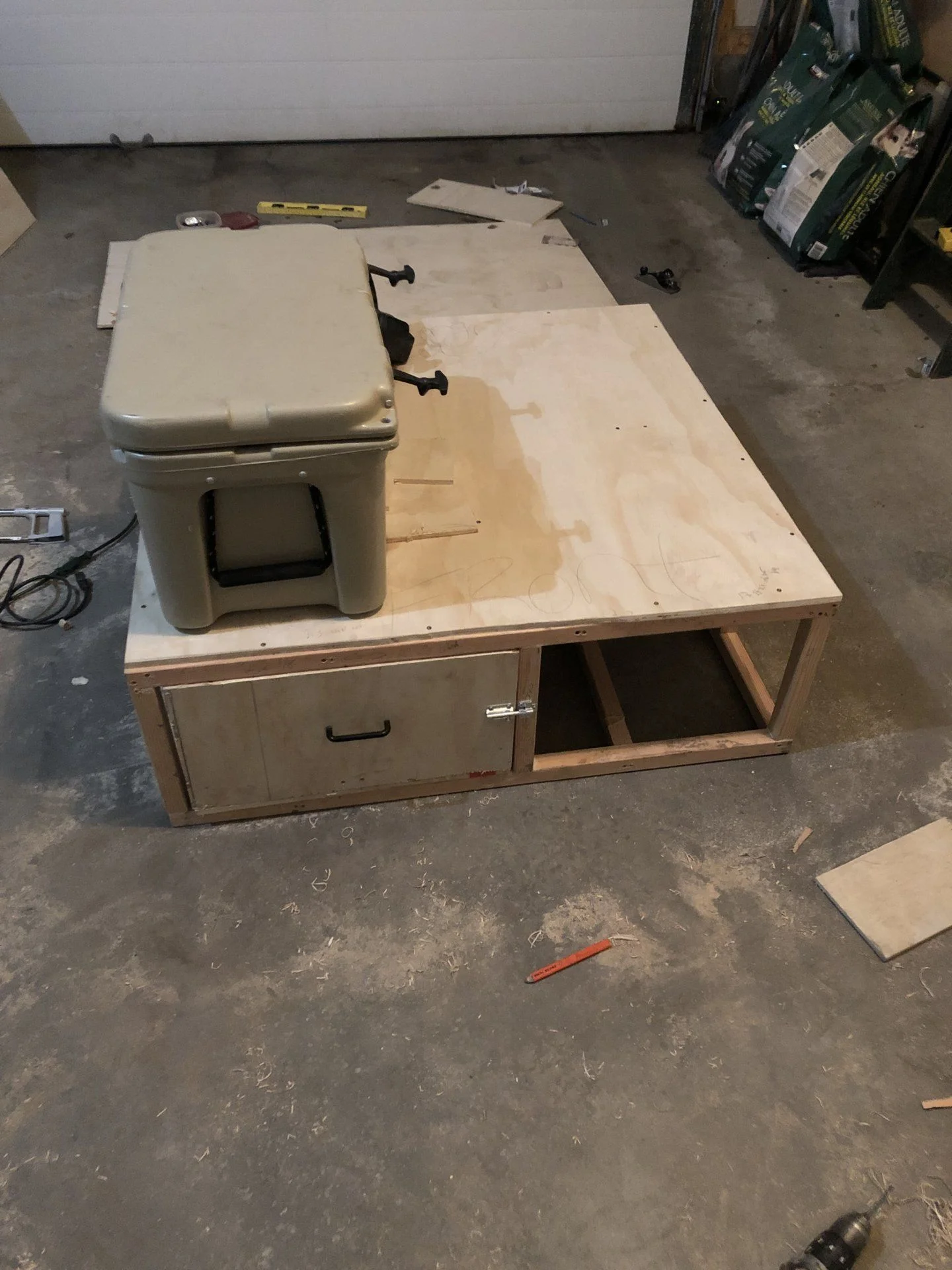

What I wanted now was some form of rear storage. The thing came with the biggest sub box I’ve ever seen!
Started with a 2x2 Douglas fir frame
Used 1/2 and 3/8 plywood to construct the drawers.
Ignore the beer fridge girl:beer:;)
1971305
1971307
In its final position

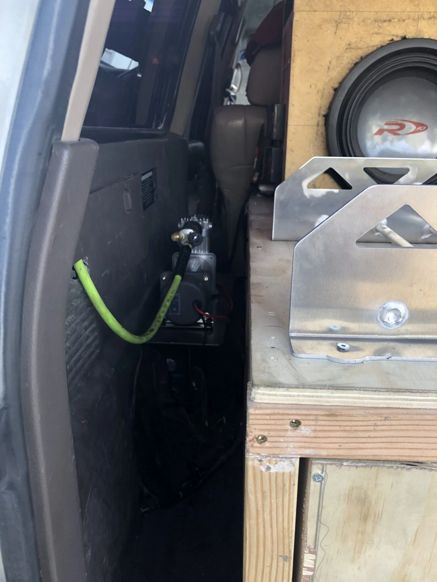

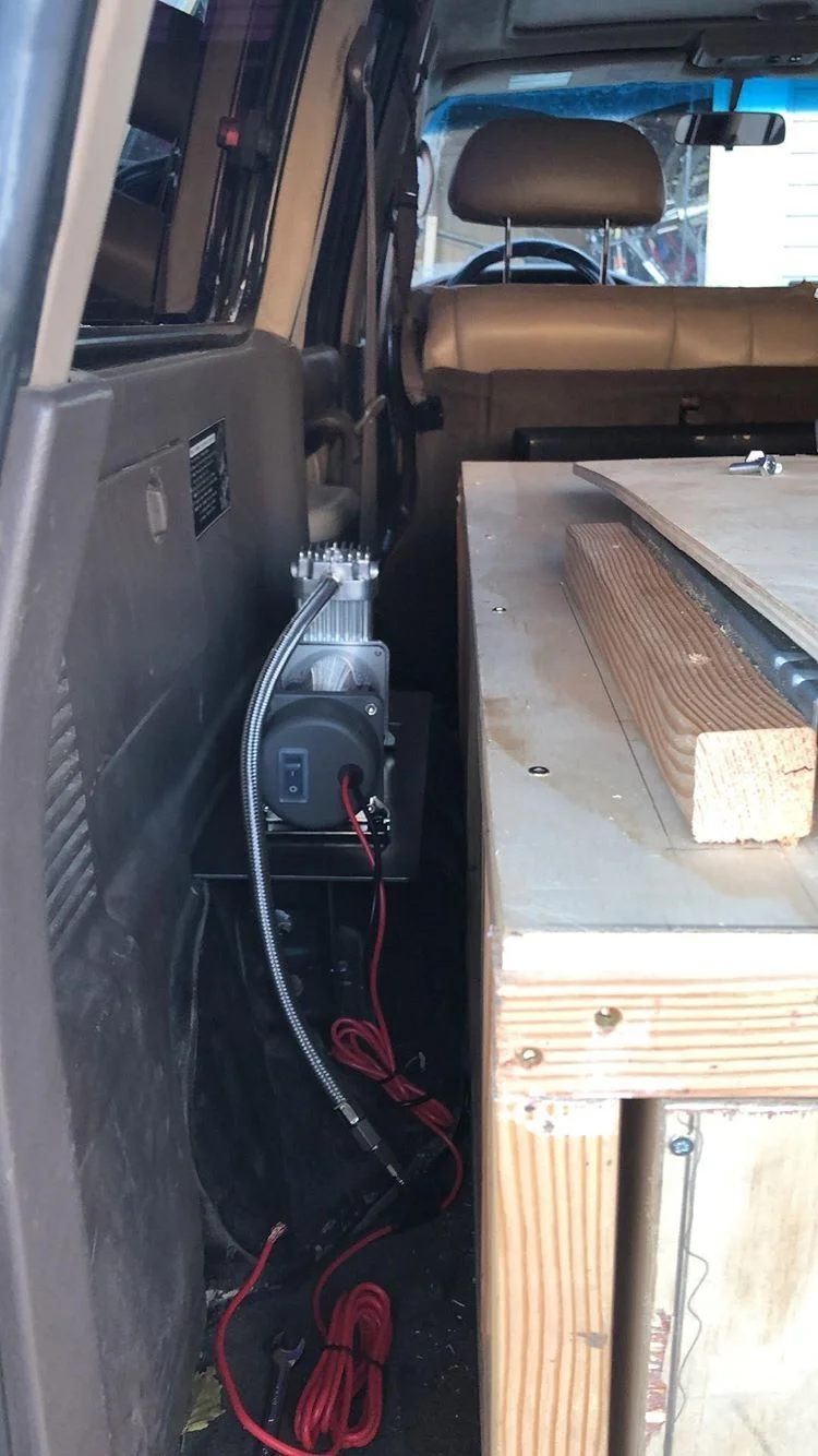

Tired of using Jeep buddy’s arb dual and couldn’t stomach spending the cash on one. I figured I’d try a viair 400h. Pretty impressed with the thing honestly.
1971319
Mounted it on a small plate I made at work.

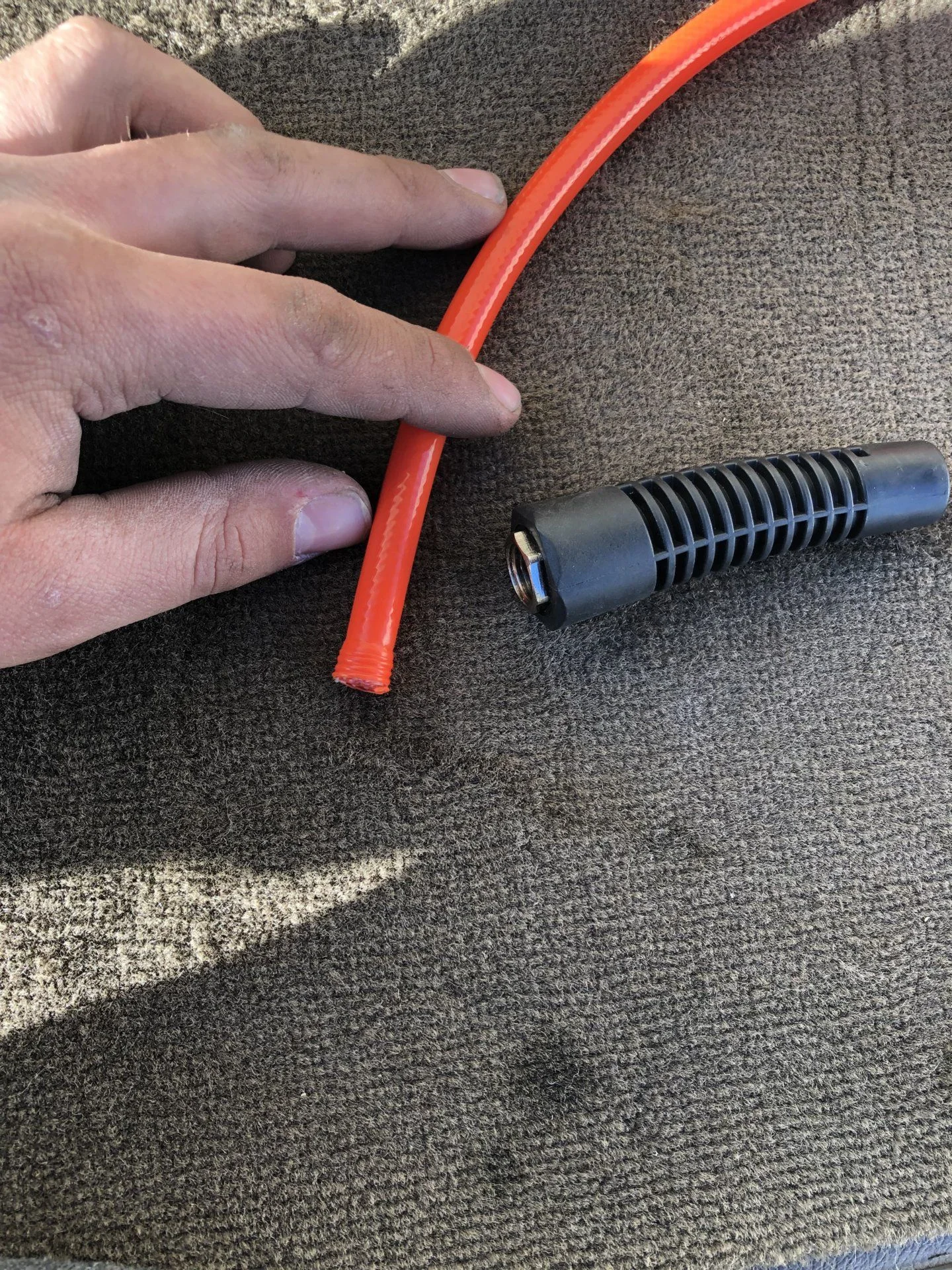

Had a small run in with an arb hose, had a 115 psi pressure release valve on the compressor end and and open flow air chuck on the hose end. This happened.
1971320
Hose blew clean out, had only ever filled 2 tires with it. Luckily I got the 4wp extra whatever it’s called warranty. They replaced it.

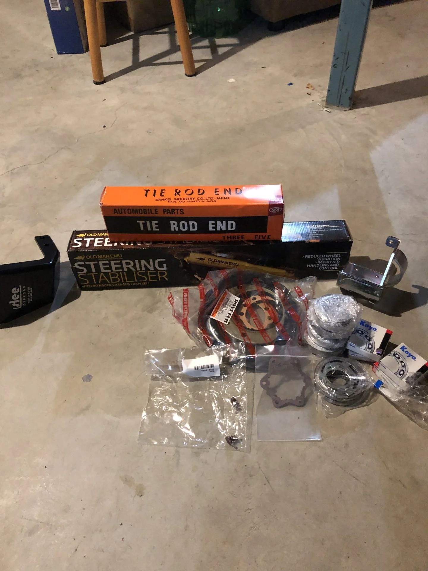

Rebuilt my knuckles
Steering and brakes.
Next weekend will be oil pump and coolant system refresh.
No pictures of the front end work, my hands were a bit... messy.

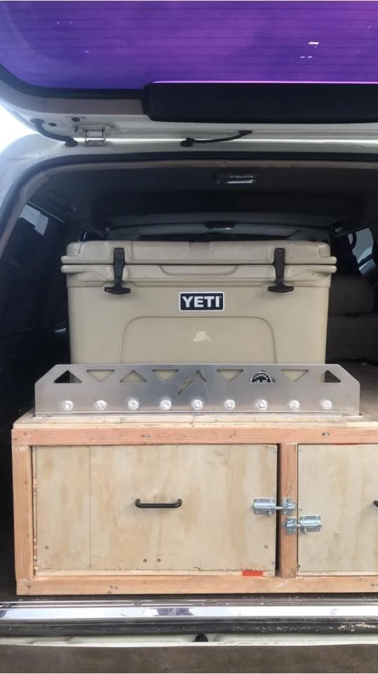

Built this at work for the yeti, instead of the stupid sliding thing. Aluminum for those who want to know

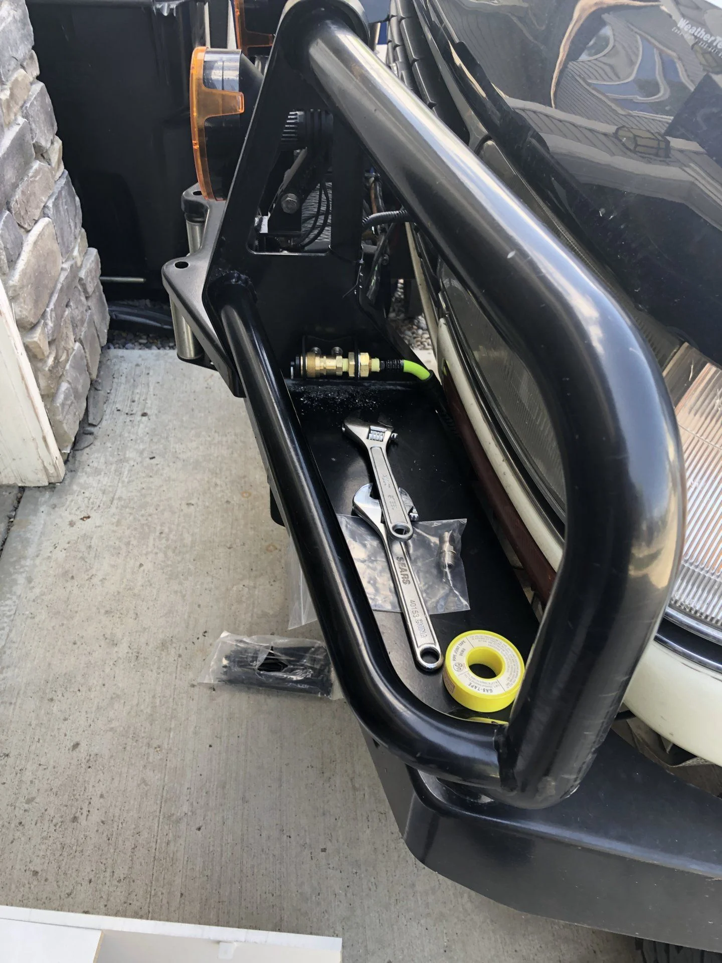

I did manage to route an airline from front to rear yesterday using @wits.end cool bracket.

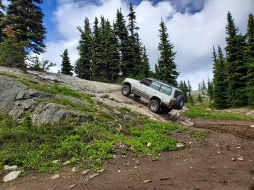

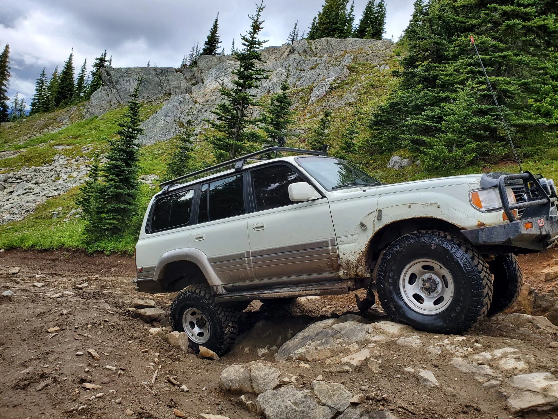

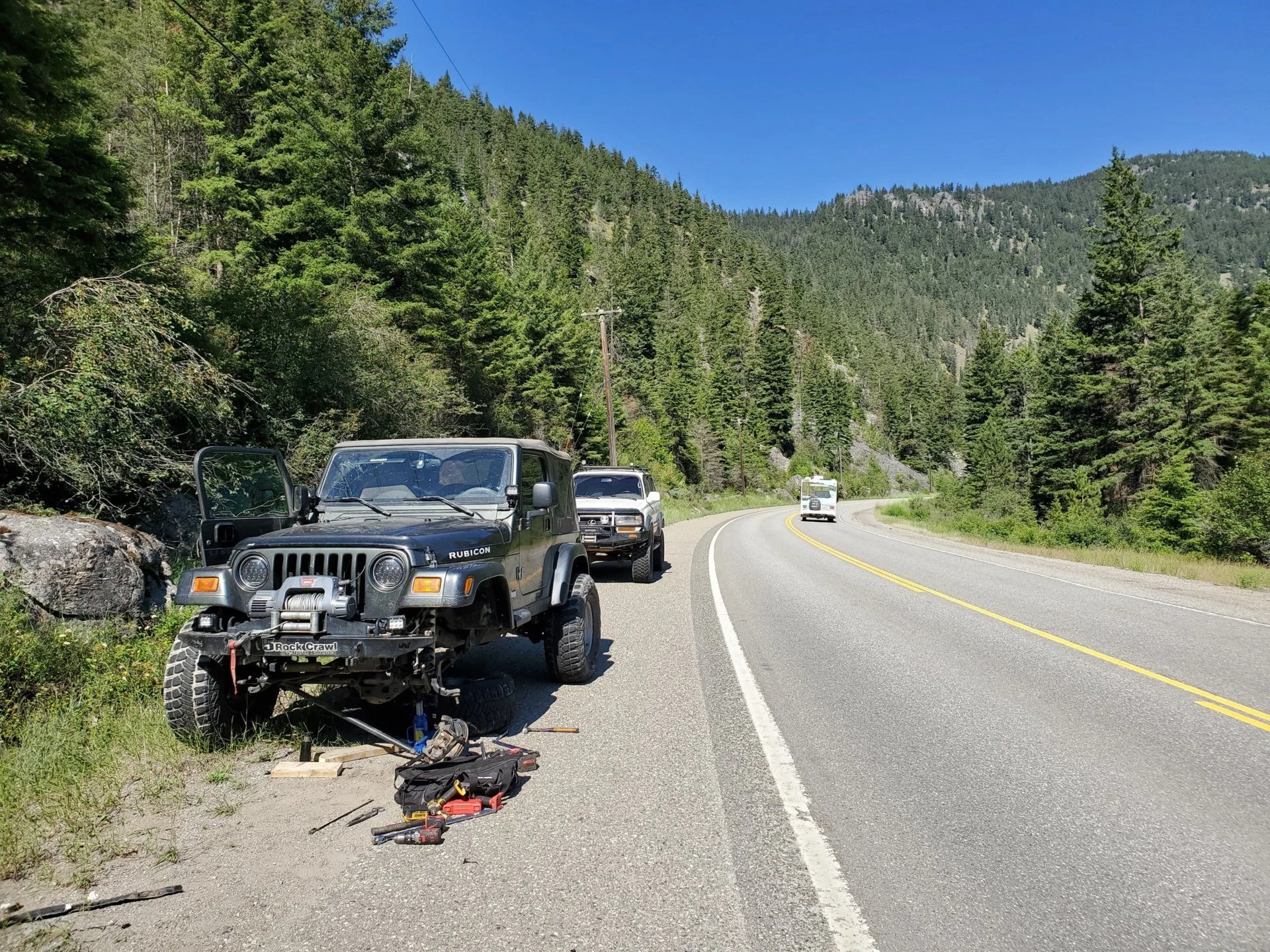

However here’s some photos of a 2000km wheeling/ adventure trip. Truck did great, fender flare was massacred, a fix is soon to come.
Silly jeeps always breaking. Blew up the u joint and ears on the end of the shaft and stub shaft. Thank god for a front locker.
The trip made me realize a few things. Catch cans on pcv and breather are going to be welcome addition, the slee 6” is tall for my liking so going to shrink to a dobinson 3” flexi and sliders would be a nice thing to have for sure.
