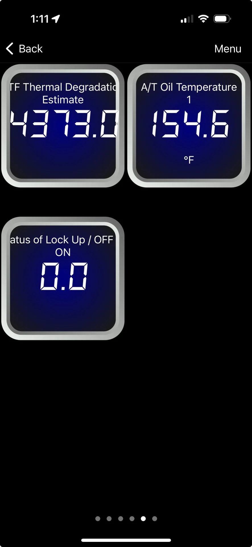

On to the next thing. I want to get a transmission service. After my hard work this weekend (utilized resources bc I have an 8mo old and had to get mother in law to help watch her and my time… I’d rather be mountain biking) I was set on a Lexus dealer drain and fill. Previously they quoted me $200 for a drain and fill and that seems reasonable with the cost of transmission fluid. Well… talked to the service advisor today after scheduling this and he recommended a flush which he describes as a non pressurized fluid replacement with Toyota fluid. It’s also warrantied at $4k (he quoted GX trans as 8-10k) if you continue with their “flush” every 30k. Big downside flush is $400 now after them telling me drain fill was $200 now drain fill is more than flush. I get the feeling this is crooked and just pushing me into a scheduled $400 every 30k.

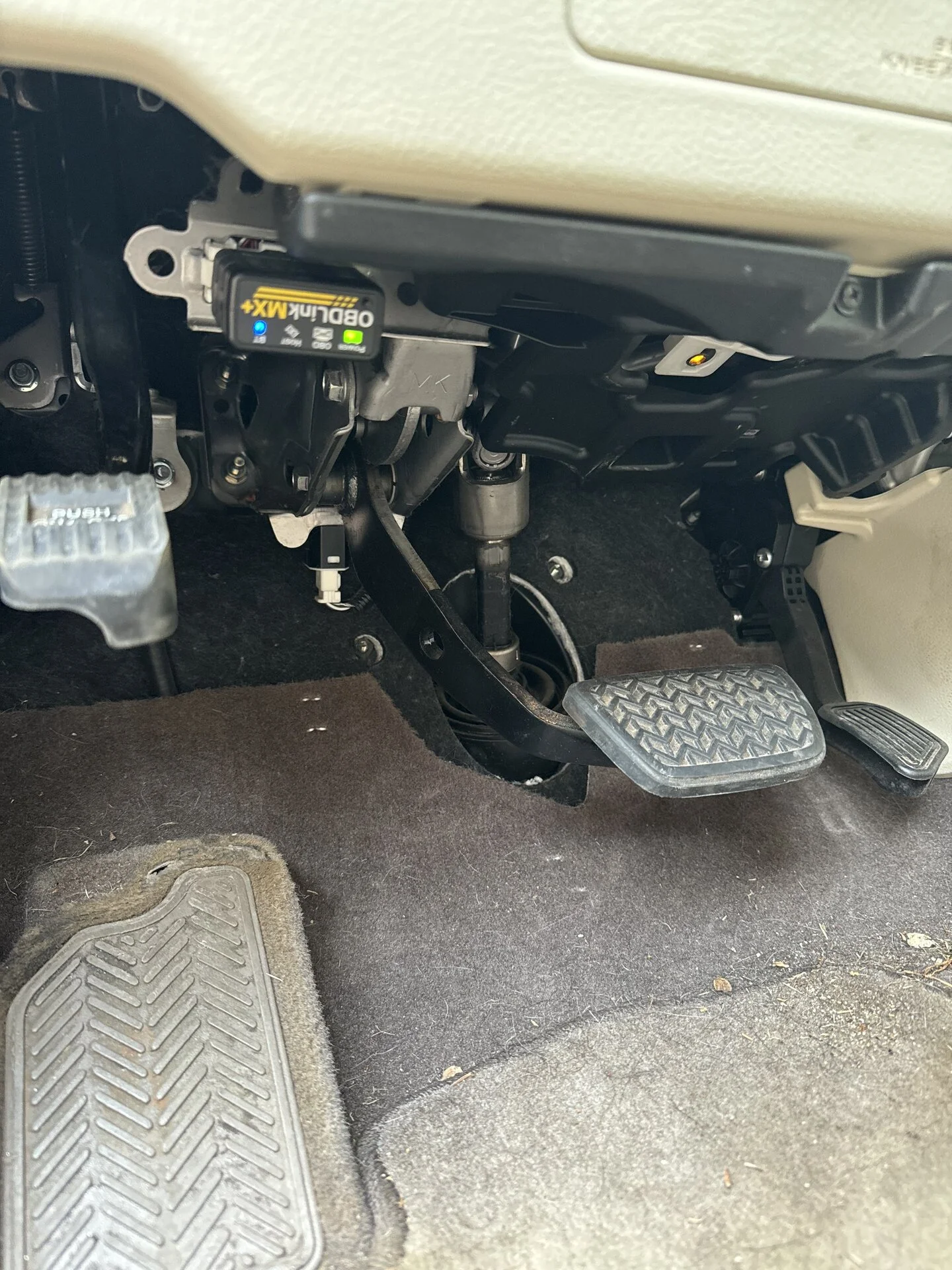

So with this I’m thinking about trying my own drain and fill with the obdII scanner again. I just need to take a little time to recover from last weekends driveway warrior work. I’m pretty handy and sure I can do it. But I’m also still sore from laying on the ground with less than ideal mechanic tools. I was just hoping I could pay for convenience. Obviously not the case here because I am not a cheap bastard but I am thrifty and concerned with budget. Ok I’m a cheap B. Definitely not target audience for Lexus dealership.
Thoughts? Should I cave or just pickup the torch buy the tools and make this b last forever with whatever the minimum maintenance cost is (aka diy). Once this trailer is gone hopefully the G will fit in the garage for this stuff so I don’t have to brave the elements and the neighbors. Im kinda into that idea right now.

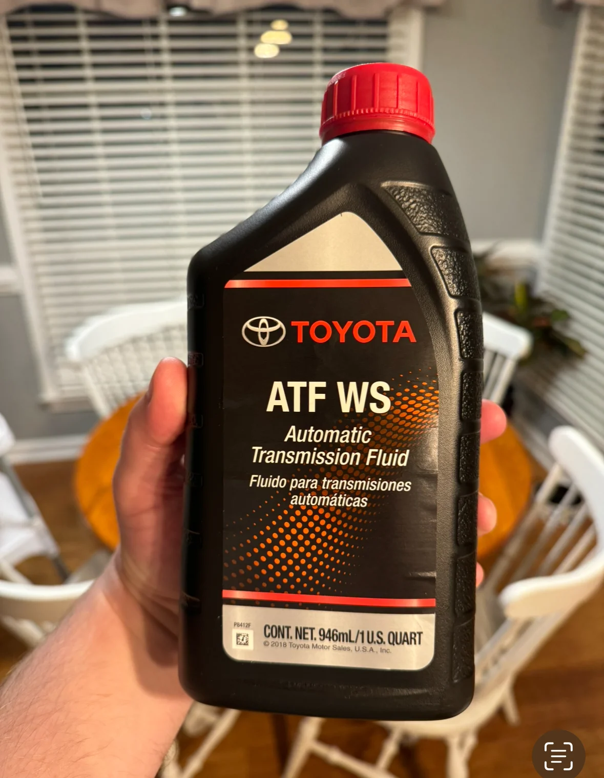

Oh and picture of the apparent liquid gold so this thread isn’t worthless.

View attachment 3553729Oh and picture of the apparent liquid gold so this thread isn’t worthless.
Shoot me if I am wrong but I thought the transfer case fluid was the "liquid gold". That is why I mentioned the Ravenol option earlier.
P.S. I'm not trying to be critical, just rooting for all the GX owners and trying to help them save money for the most important things!
Nope I’m not familiar with the correct jargon but buying this fluid versus the Valvoline maxlife alternative felt like I was purchasing liquid gold. When I do that service maybe I’ll learn what liquid gold really is 👍🏻
