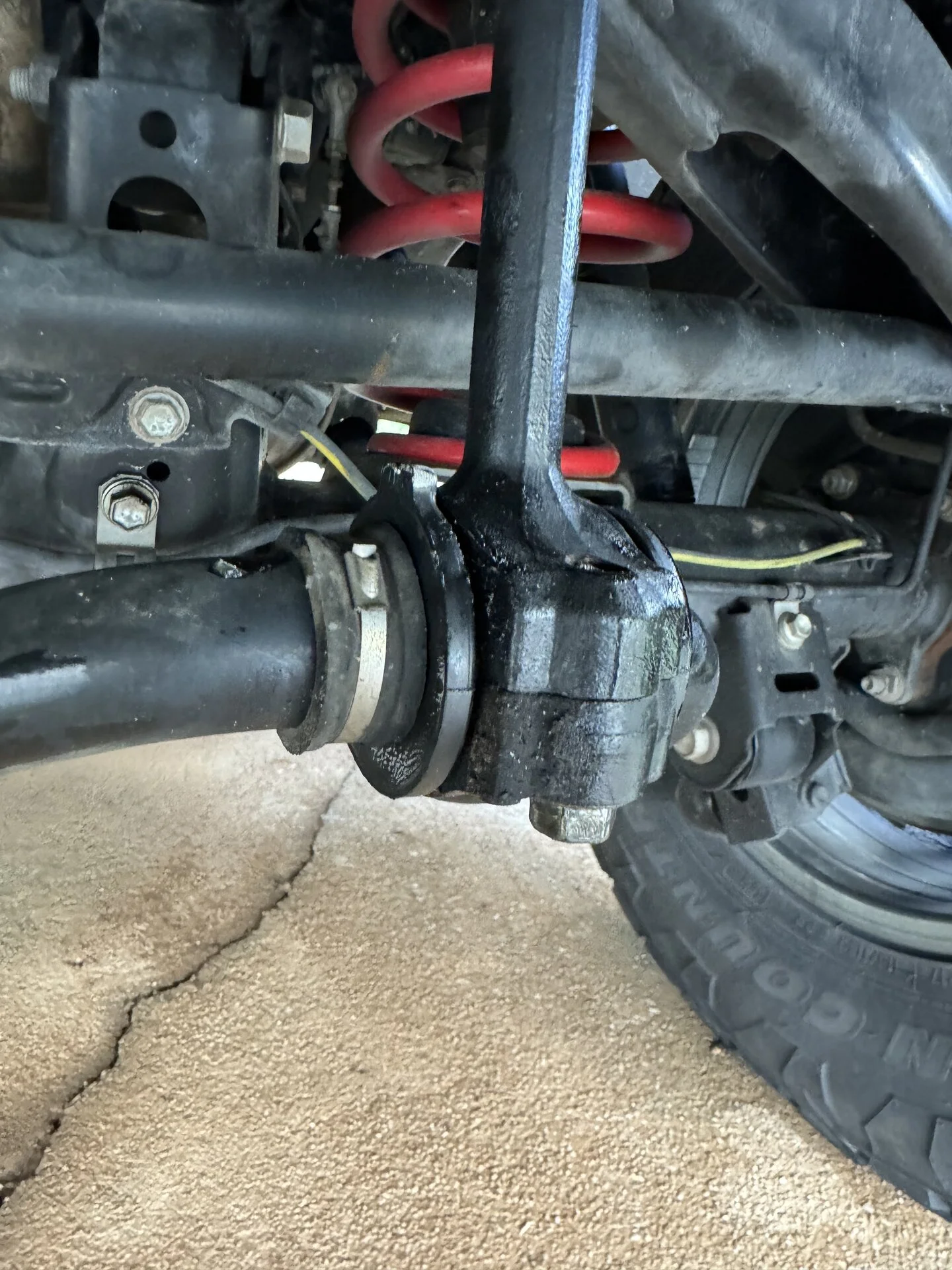

Watched a lot of videos on you tube and read a lot on suspension noise. Saw a mechanic hopping on the side step in garage to make it squeak so I tried this… rock solid in front no squeak, feels perfect. I’m a decent sized fella (230ish) and even leveraged with my long arms and roof rack. Very impressive no squeaks. So I went quickly in my head and thought what else could be moving. I’ve noticed my grill fascia moving when the fogs are on since the fascia cut I made a long time ago and I went up to the grille and wiggled it up and down… 🦫 there’s my squeak. Feel slightly dumb but also glad to have it diagnosed. Doesn’t bother me nearly as much because I know what it is and that it’s mostly benign.
Now back to rear clunk. I put all my weight into bouncing on it too and nothing. It seems to happen only at extremes of the suspension travel and/or high speed compressions. I also probably need to remove anything in the back or floor board to eliminate any possible interior clunk as well. Then will have to check some more mechanical things that can cause a clunk… sway bar end links, lower shock mount spacer play… etc. hopefully I find something dumb back there too. I guess it could also be the rear barn door under extremes or atrac activating due to loss of traction. The atrac thing would make sense in the extreme articulation scenarios but I also hear a noise from same area over speed bumps, especially below 40 F notably this noise is more of a whoosh noise than a clunk. Both noises are also a hard to reliably reproduce.

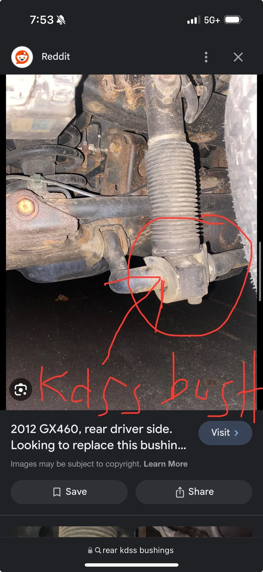

This is not my kdss bushing just a random one I found online. Mine look perfect compared to this example and it’s my non kdss piston side I suspect is the culprit. But here ya go for a visual.

I also have developed a squeak/squawk in the rear when going over bumps. Interestingly, it goes away when it's wet outside, so I'm thinking it must be something that needs lubricating, a dry bushing or mayb the KDSS bushing you mention, I'll have to do an inspection when I get home.

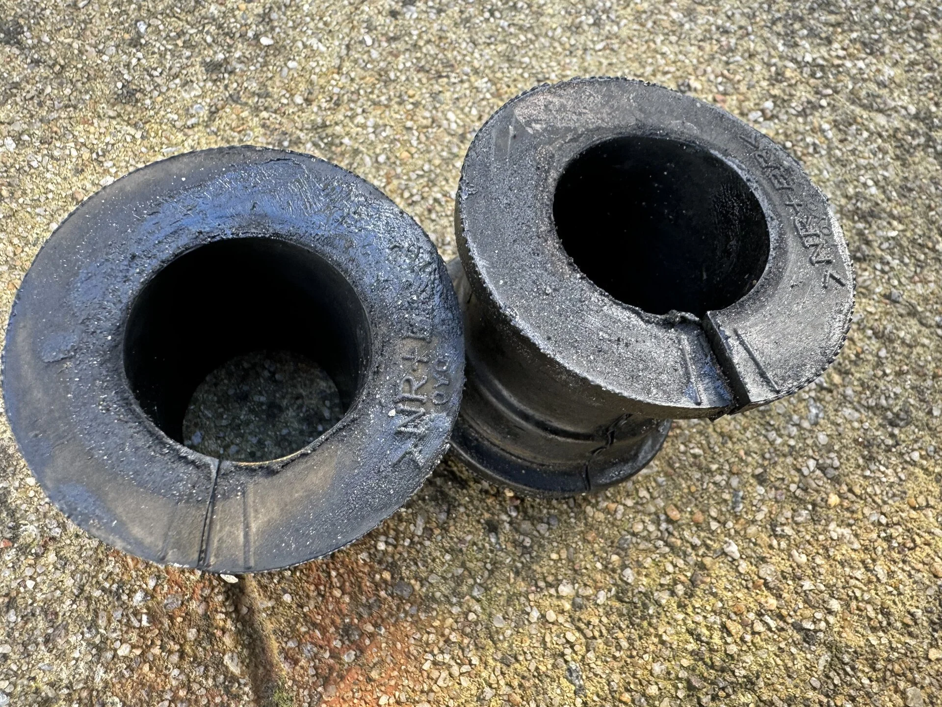

Thinking that passenger rear trying to hug itself was the cause of my squawk. Will find out soon. Super easy repair besides trying to squeez my oversized spare back in at the end 😮‍💨

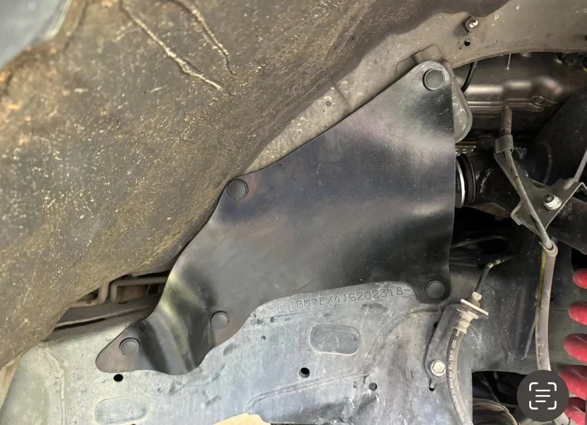

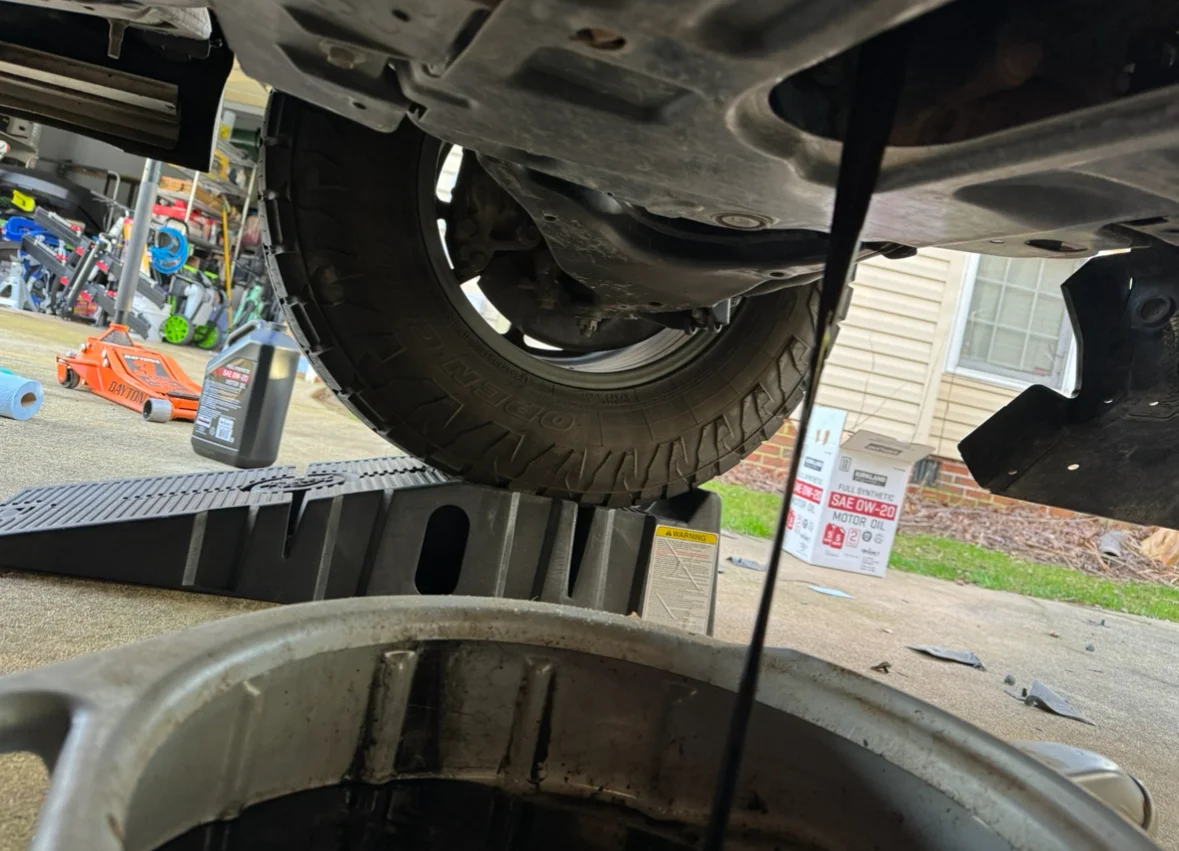

Got the rad rubber splash guards on and did an oil change too. Replaced all the filters (oil engine air and cabin air) with oem from dealership. Used full syn Kirkland 0-w20 oil. Kinda baselining my maintenance here. Will take in for a trans drain and fill. After hard work today have decided to just let dealer do that!

No squawking today!!! Cannot emphasize enough how good of a feeling it is to have diagnosed and fixed this. 🙌🏻
And only cost a small amount of time plus $35 in parts. God knows what a professional would have charged for this. And how many times they would have tried to fix something that wasn’t the actual problem. The Lexus dealership was going to charge $195 just to initiate diagnosing.
