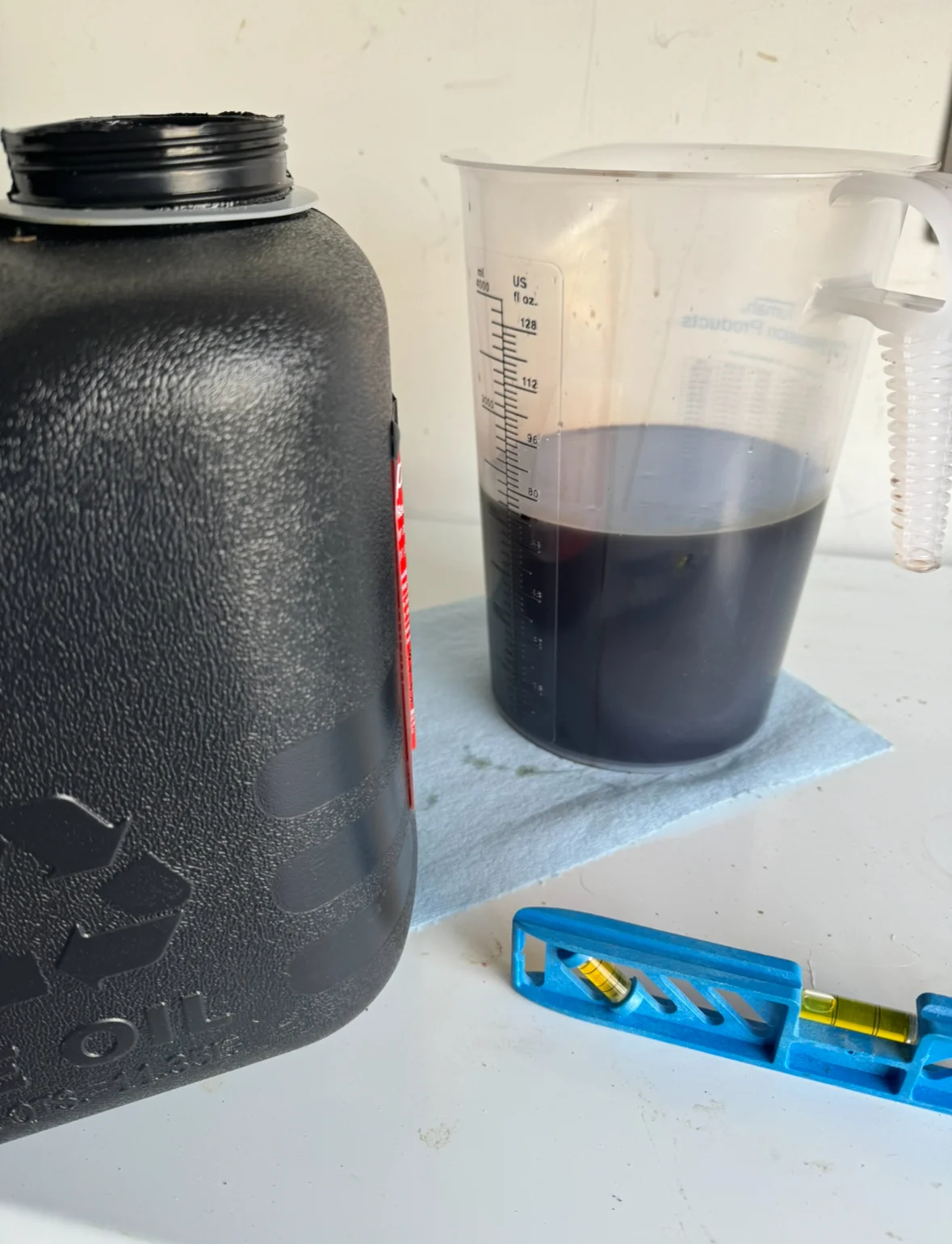

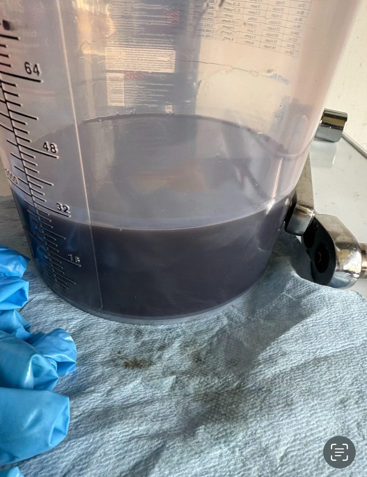

Drain and fill done. A bit of an adventure but should go smooth next time. I feel like it made a positive difference doing this. Over fill fluid still dark but less turbid and not as dark. This was approximately 25% fluid change. I’m thinking I’ll do it once again soon, but then skip to every 30k.

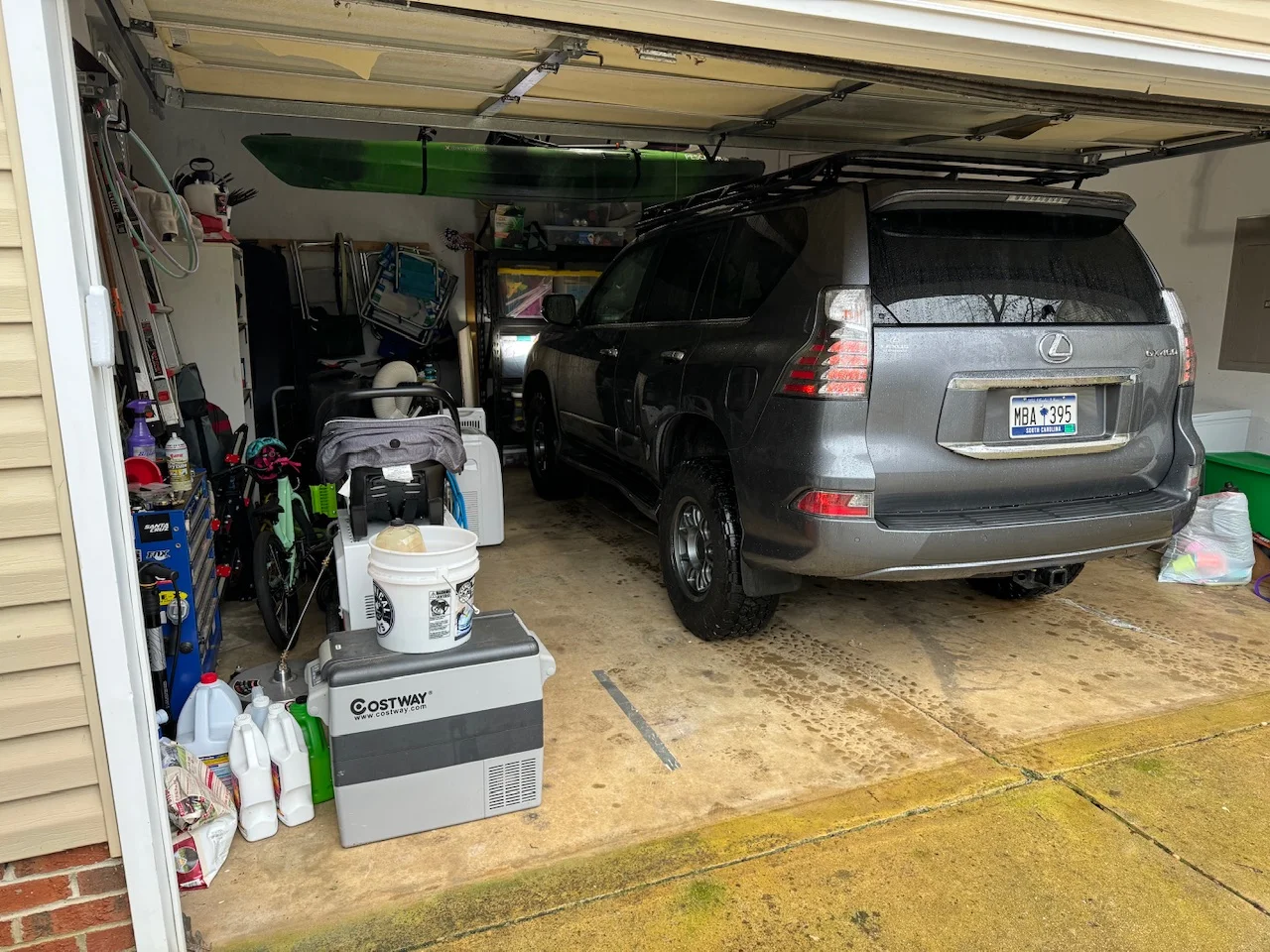

Trailer is sold and gone! First time I’ve had the GX in the garage since I installed the suspension lift in the garage. It seems so big in there. Looking to continue to declutter and purge. I’ve actually already gotten rid of a few things and reorganized again since this pic. Felt so luxurious leaving this morning with a relatively warm car, amazed the difference the garage makes for temperature even though you can tell I do need a new garage door. It’s drafty and letting vermin in. Add that to the list of home repairs I need to complete, it’s definitely not first priority right now due to bigger issues I need to address with my home. 🤦🏻‍♂️
