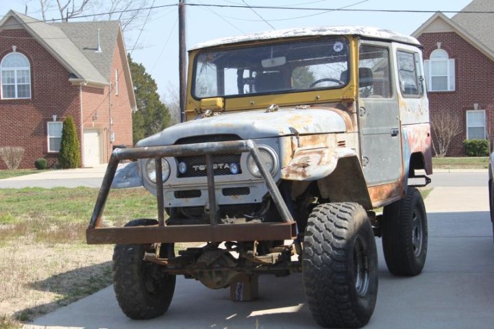

First off I'd like to introduce myself, since I've been in the 80 section most of the time until now. I've always wanted a 40 ever since I was in high school and one of the construction workers working there had a smurf blue 40 that caught my eye. It was mostly stock and one of the coolest trucks I had ever seen. Fast forward to today and I convinced my wife to let me buy one and build it. So, I believe I bought the ugliest most beat down 40 I could find. IMG_6828.jpg
I picked her up a the end of March and trailered her home. Thanks to DSLTOY helping me with the prebuy inspection I somewhat knew what I was getting into. I have spent the last month doing a complete tear down.
My goal with this build is to have a capable trail rig that is safe and comfortable enough to drive around town with an occasional short road trip.

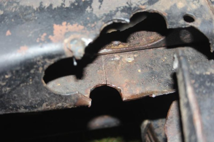

Saginaw conversion butchered the front x-member

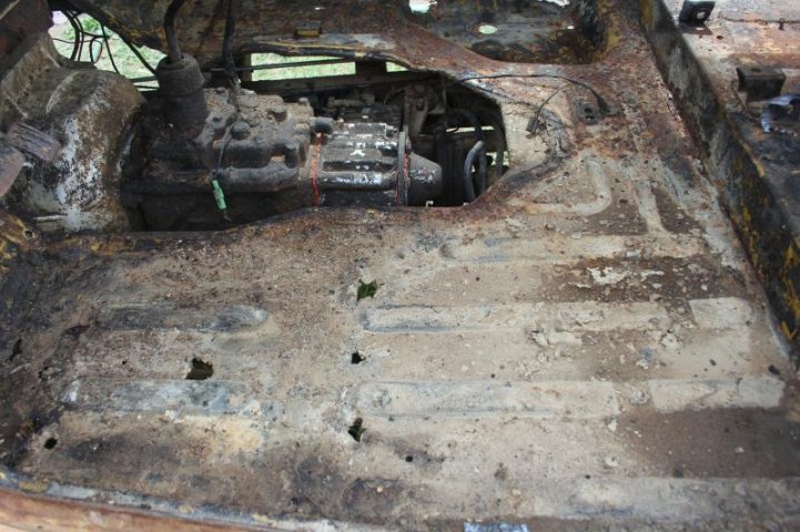

Rust

Well your mirror and bezel are upside down. You have a cool lunar suspension and you truck looks like BOB from the movie "The Black Hole".
I was waiting on the bezel comment. I've never seen 'The Black Hole', but my neighbors kid told me it looks like Mater.

I thought I had the worst "sagisawed" frame crossmember, but yours wins!

I like the matched set of tires: ... might pull to the side a bit, but that power steerin' takes care of that, huh?
BTW, here's a pic of my "Billy Bob"! Won't say how he got that nickname. :grinpimp:
Poor man's Cruise lean fix. Look how level that baby sits!
