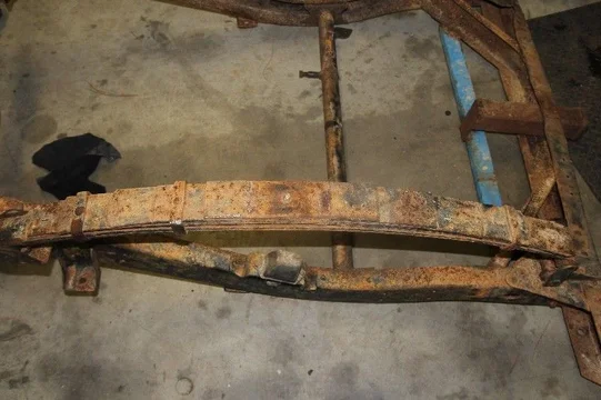

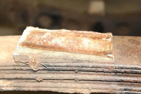

Also, I have no idea what spring I have. I think they maybe 40 springs with some add-a-leaves. There are seven leaves front and rear, some are tapered some aren't. I want to loose some of the height from the pics up top. What do I have going on? Also, I'd like to flip the rear springs for increased wheelbase, if these are OE springs with add-a-leaves.
