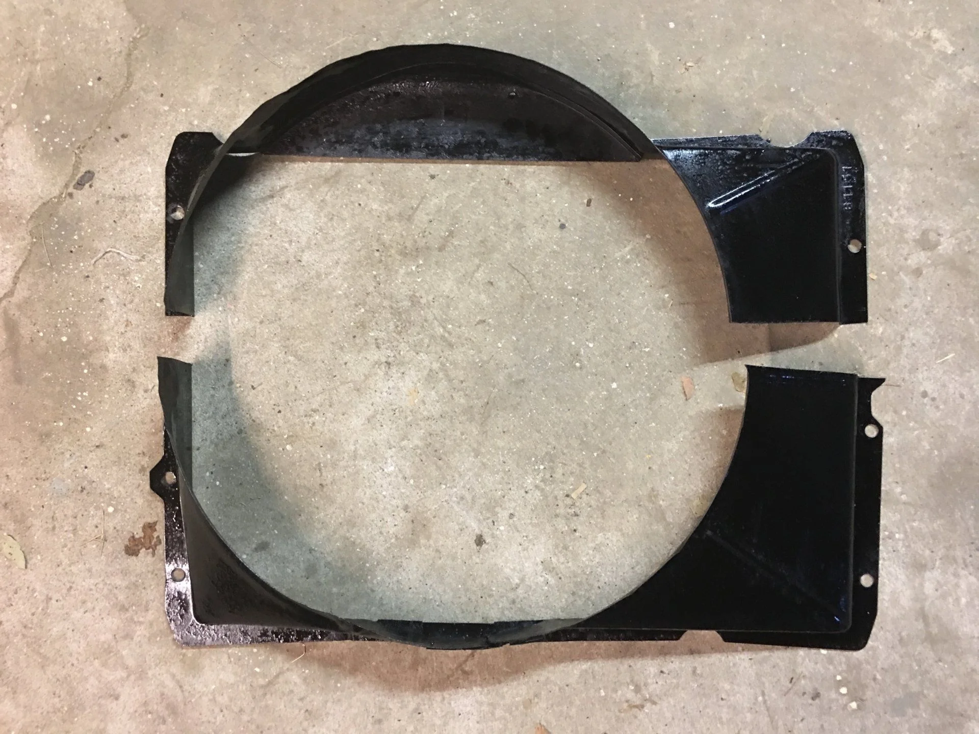

Busy weekend with the holidays. Didn’t get much done, but I did get the fan shroud back into useable condition.
When I brought the truck home it was tossed in the back. It had been removed by someone who cut it at 6:00 with a torch. Today I bent it back into shape, welded it back together - then promptly chopped it in half at 3:00 and 9:00.
full

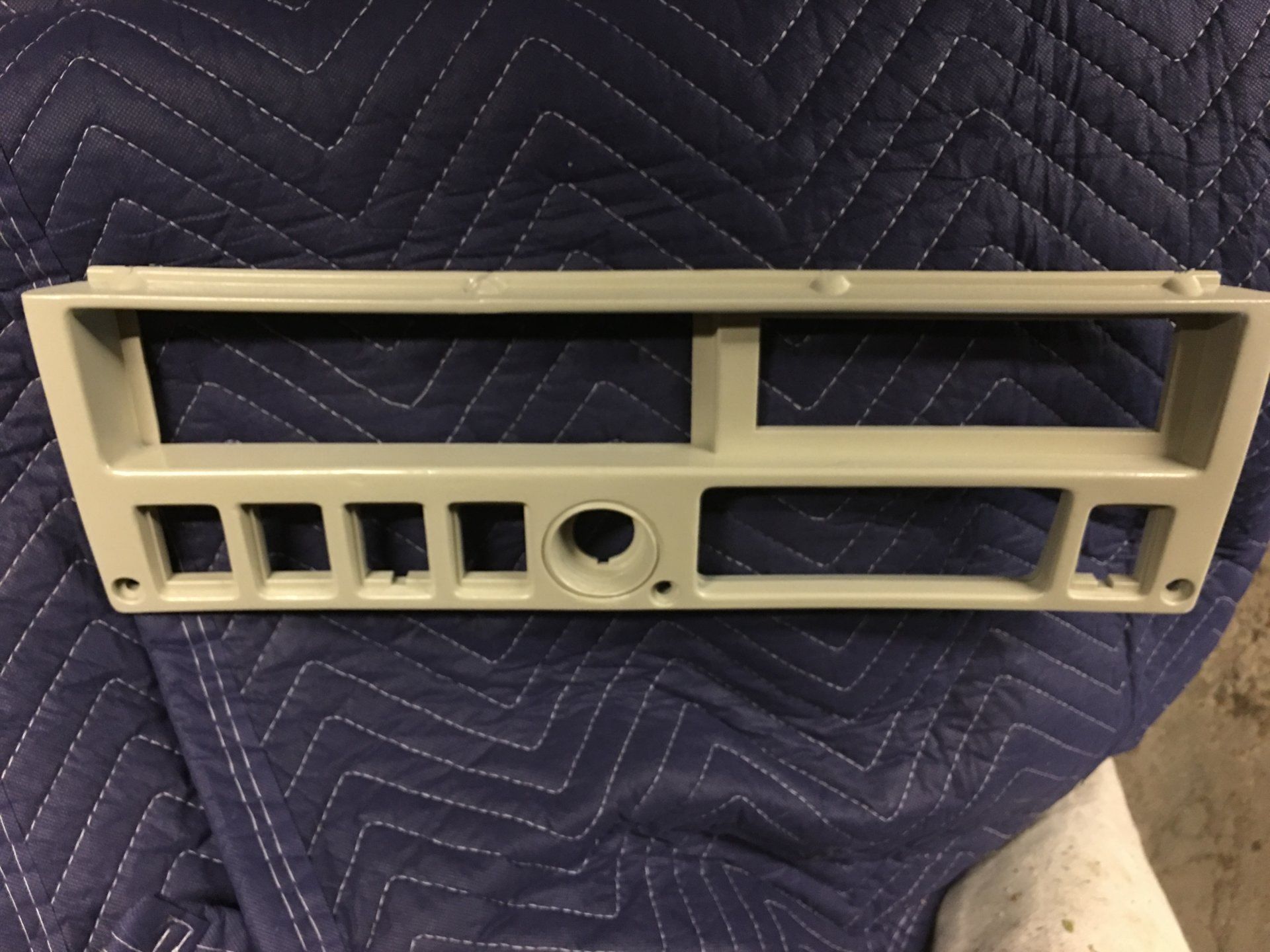

Also, sprayed some krylon fusion on the bezel. It’s now got about 4lbs of JBWeld keeping it together and mending the various cracks. I’ll let it harden for the week.

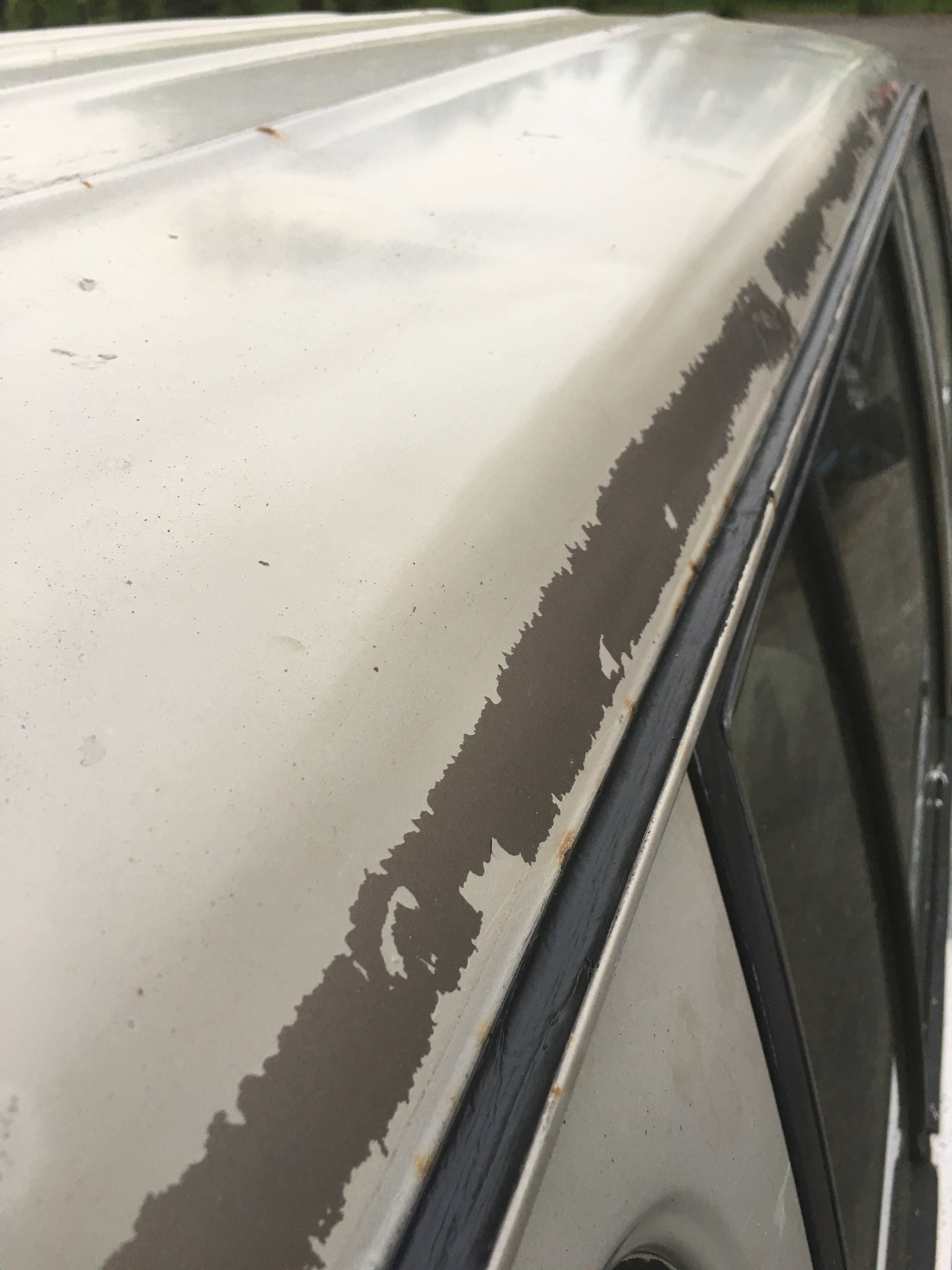

Turn for the worst today. There are a few rust bubbles above the gutter over the hatch. I’ve been planning on cutting and welding patches in. I dug into it today - it’s a bit worse than it looked, but behind the rust is all mouse nest built out of headliner padding. So the headliner is junk and needs to come out. Its free of tears and was one of the few redeeming
qualities of the interior.
So it sat for most of the winter while I was busy doing other stuff. Last week I grabbed a pair of front doors for it and got the bezel and switches back in the dash.

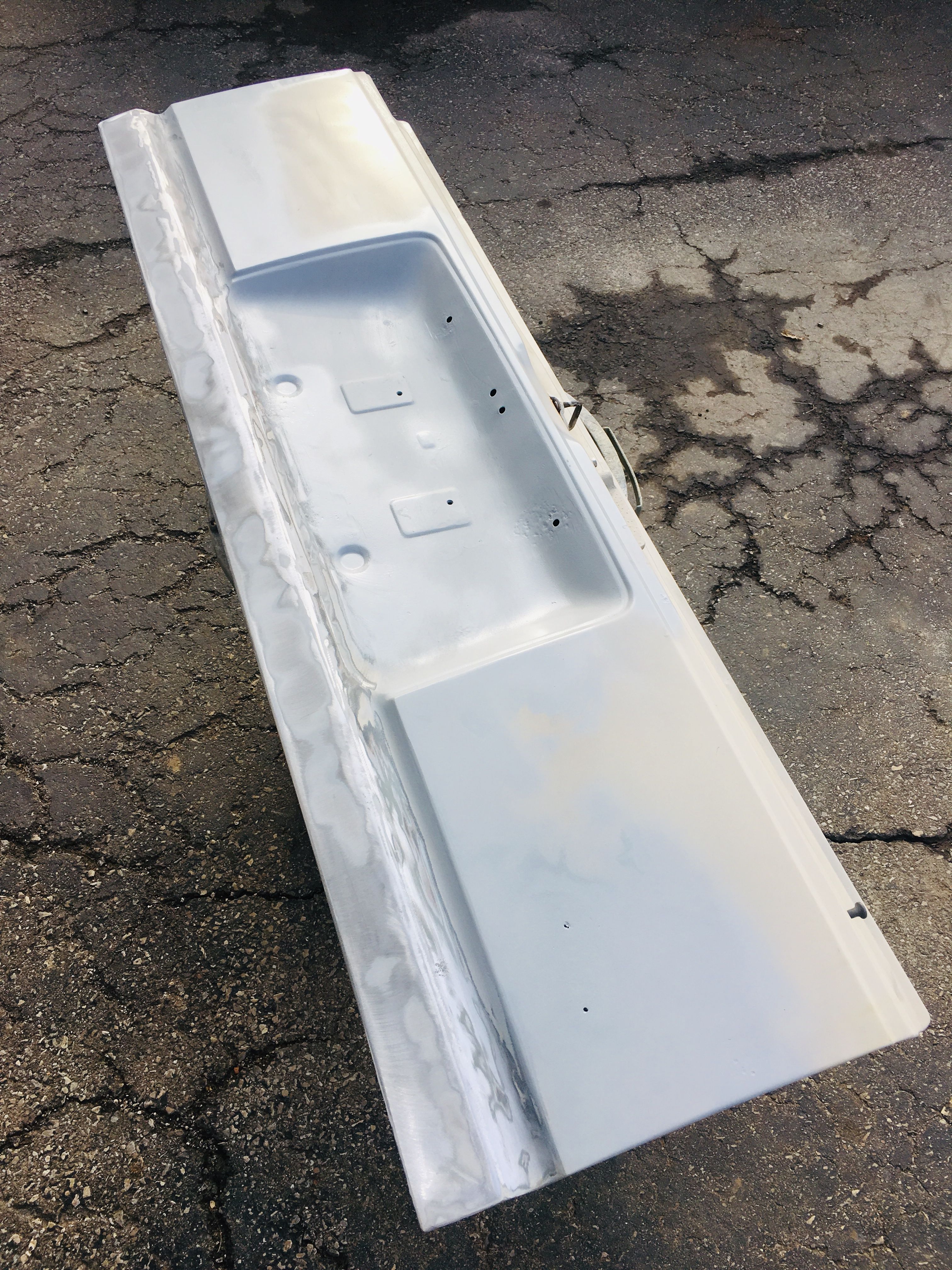

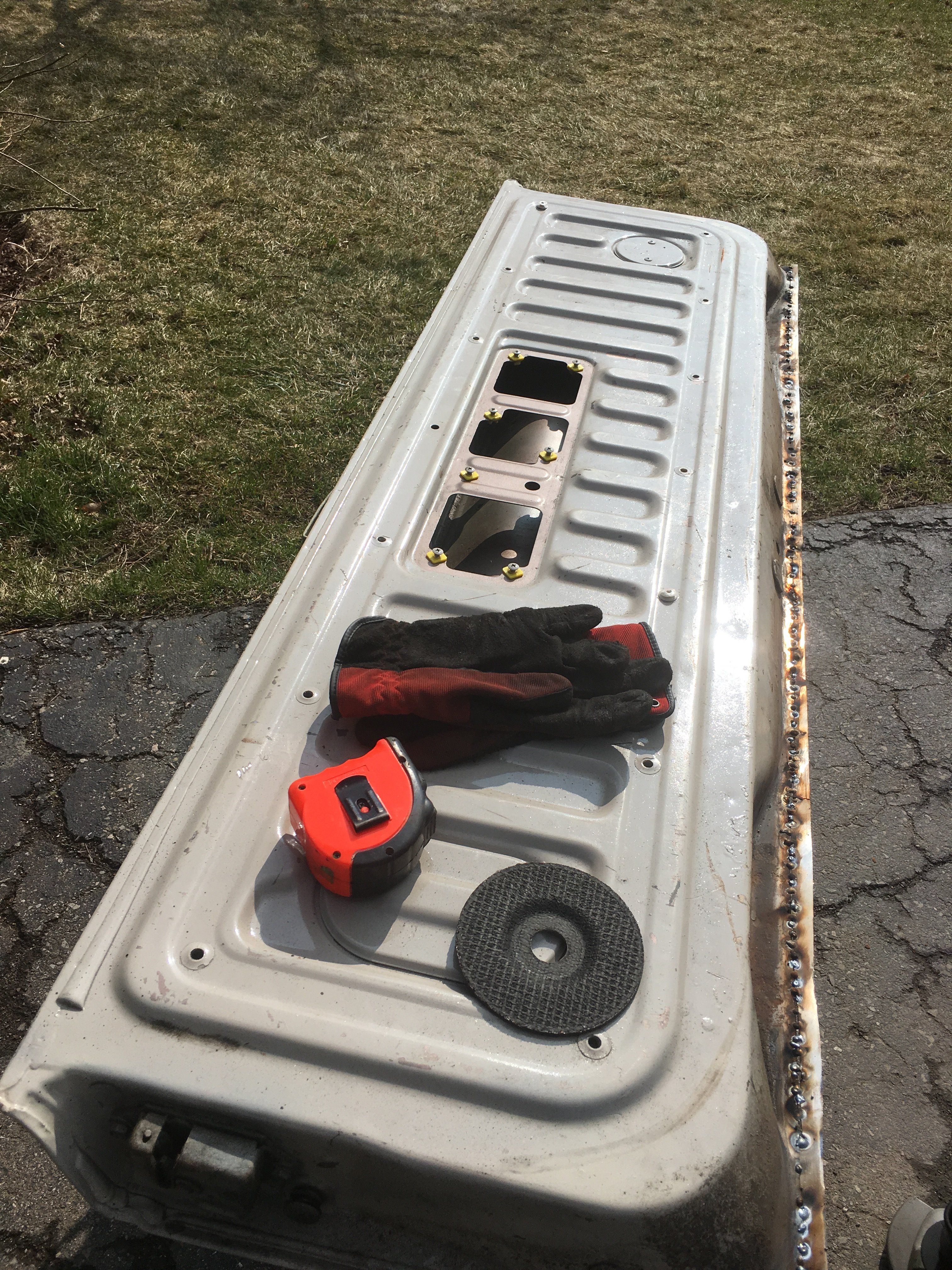

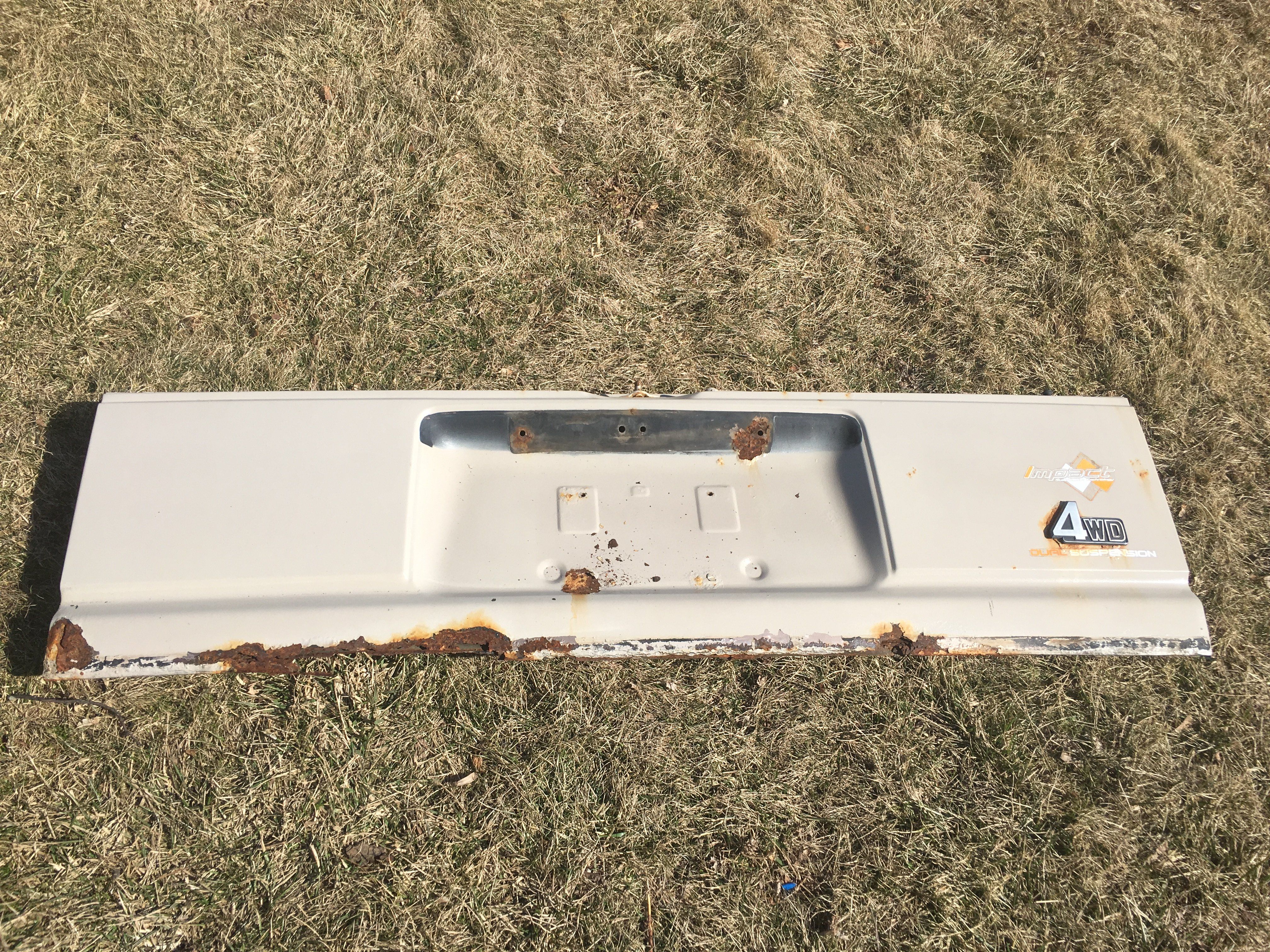

I probably should have taken the guy with the doors up on his offer for the tailgate, but I decided to take a shot at fixing this one. Tried to remember to take photos, but didn’t really.
Pulled it off the truck:
full
Peeled the bottom 2” off.
full
I briefly considered just omitting the 3/4” of metal that had rotted off the inner structure and making the tailgate shorter, but figured I should at least try to do it right. Started tacking a strip along the lower edge of the inner structure. I’ll finish welding it later tonite:
full

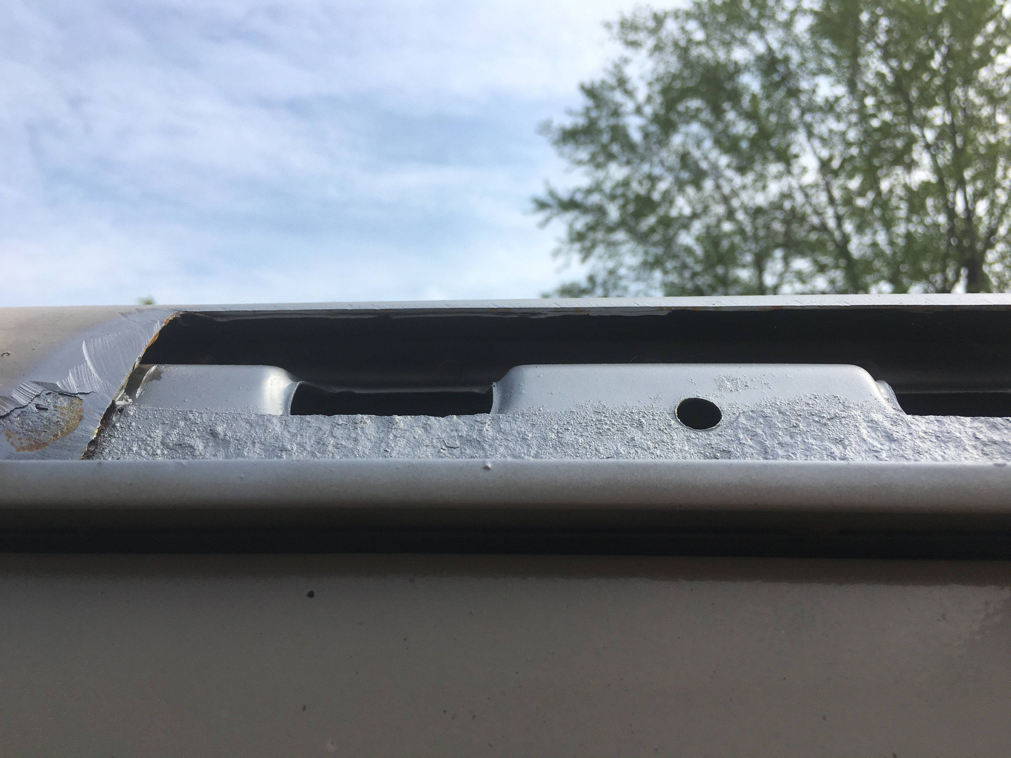

The factory seam sealer in the gutters was dried out and cracked. I chipped out the passenger side with sharpened flat head, taped above the gutter and laid down some new stuff.

The old stuff was so dried out it was maybe 15-20 minutes to have it out of the entire gutter perimeter. Other times I’ve not been as lucky. I used a 40 grit flap wheel (because that’s what was on the grinder) and cleaned up the few rusty areas. Sprayed some rust converter on the rust areas.
The seam sealer was this: PRO FORM - Products
I had the tube open from another project a few weeks ago. Laid it in from the tube and with a nitrile glove on, smoothed it with my finger. The masking tape (and pulling it off as soon as you’ve run your finger through) is key to keeping it crisp looking.
