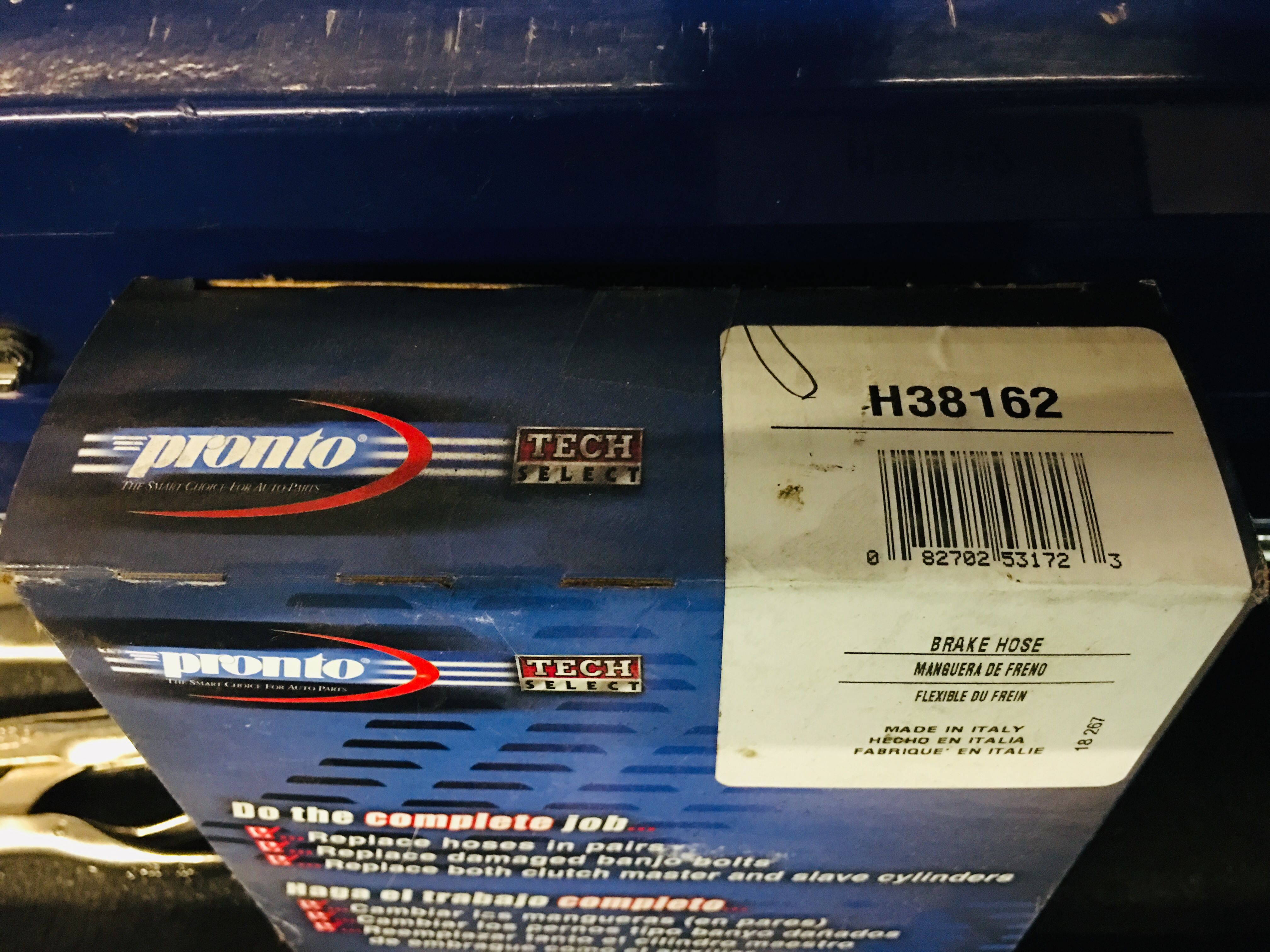

Back in the early winter I blew the brake hardline to the left caliper. I assumed it was rusted out. It was actually just fatigued from being hamfisted by whoever did the brakes last and the 90 degree fitting on the backing plate was also stripped. I simplified the system with the 74-79 Corolla brake hose I’ve seen referenced here. This is what that looks like - no contact anywhere lock to lock:
full
Here’s the hose part number. I got this for $18. Made in Italy:
full

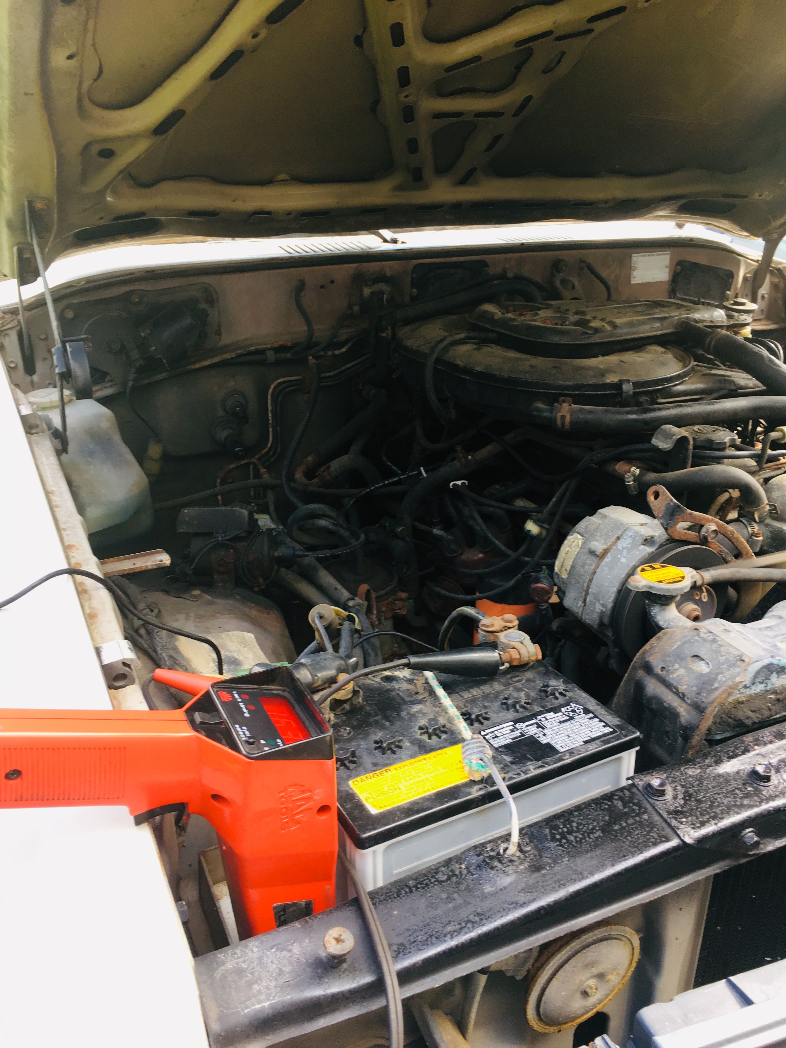

Spent some time tonite letting it run and idle. I stuck a coolant funnel on it and blasted the heaters (rear is still plumbed in and working in this one) that got a few bubbles out.
It starts right up on choke and eventually idles around 700rpm or so, but the idle is rough - lots of pops and sputtering. When I shut it down the carb fan kicked on, I hadn’t noticed that before.
It’s got a gutted smog pump, the air rail is gone, and the exhaust has been replaced and no longer has the air pump connection. The rest of the smog stuff is intact. I’ve yet to go over the vacuum hose routing, but I’m sure it needs work.
I’m going to work on the tune up this week. Ideally I’d like to smooth out the idle.

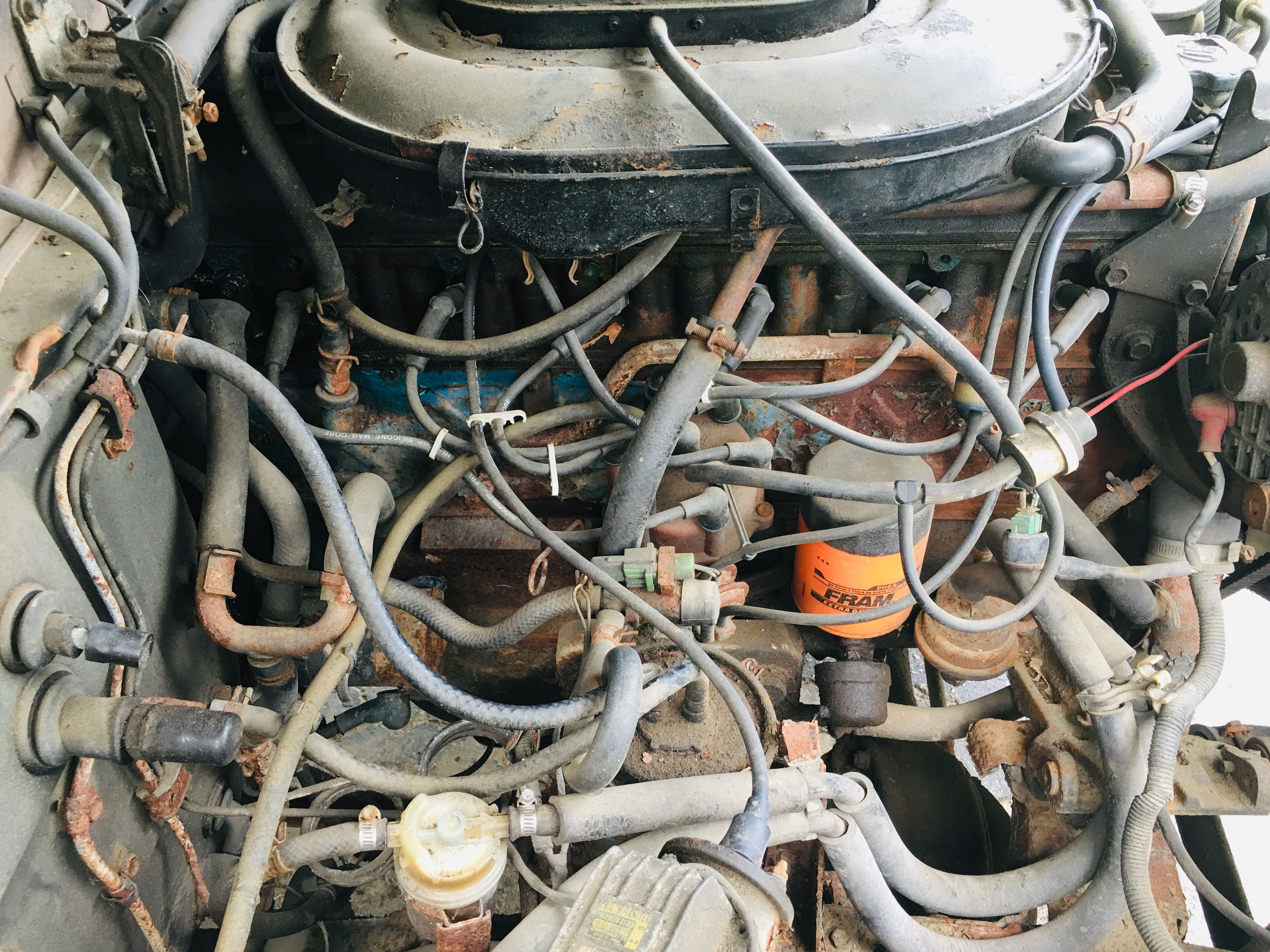

Anyone who wants to analyze and offer up vacuum hose suggestions feel free:
full
full
full

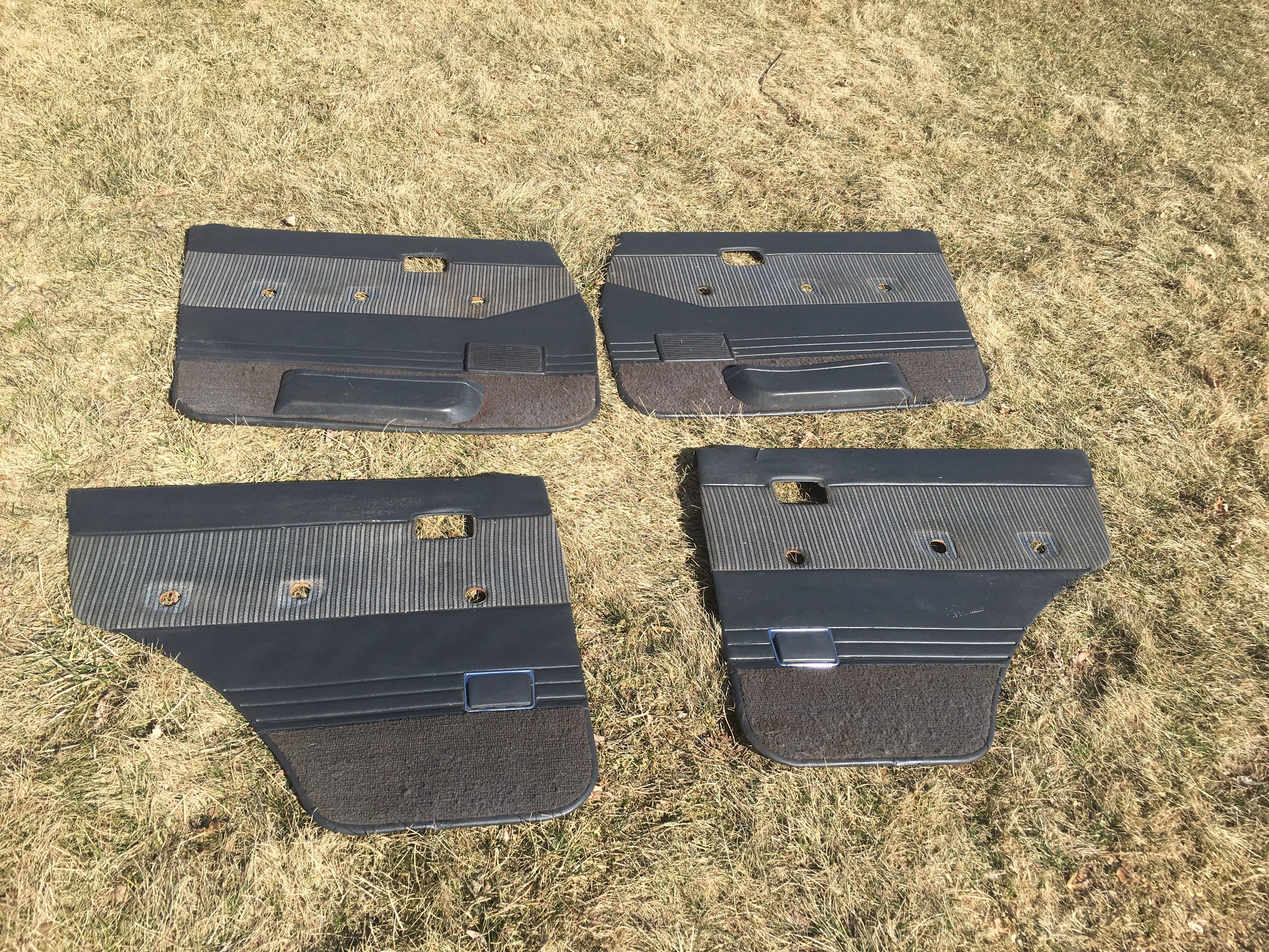

In buying a full set of doors I ended up with spare interior pieces and trim. I see lots of requests for door cards in part out threads, but posted on their own, no interest. Granted these aren’t mint. I previously tried to give the complete headlight washer setup away, and after months of no replies tossed it, closed my posting here and had a guy upset I ditched it.
Sort of a last ditch effort, but I don’t like clutter and am ready to send these to the dump.
I also have the window scrapers with stainless trim if anyone needs those.

Despite this. I spent some time yesterday morning sorting out vacuum lines. I put a few feet of new rubber in, replacing anything split. There were open ports on the carb, direct vacuum to the EGR... lots of stuff routed incorrectly. I haven’t tested any of the components yet, but at least it’s routed properly now based on the 2F Emission book.
Someone prior to me removed the linkage for the A/C idle up. I’ve now removed the vac lines and plugged the vacuum port for it.
full
full
