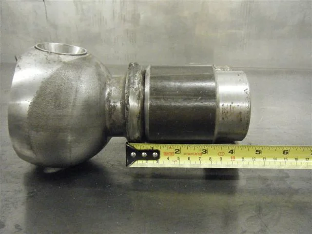

Here is the spacer I am talking about.
How much for custom inners?
Clint
This would be the proper way to widen the front axle. I wouldn't want to use wheel spacers on the front to modify track width due to scrub radius issues, and possibly swinging the tire in to the kickpanel, etc.
With the above pic, to widen the axle housing, I would want to widen only one side, the short side. Then shorten and re-spline a spare long side axle to work on the new longer short-side.
Keep the long side stock 80 length. One less part to worry about when it comes to spares and/or replacements. Stock on one side, semi-custom on the other.
A this point, we are half-way to a cut n turn, might as well do the other side too to correct pinion angle vs caster angle.
