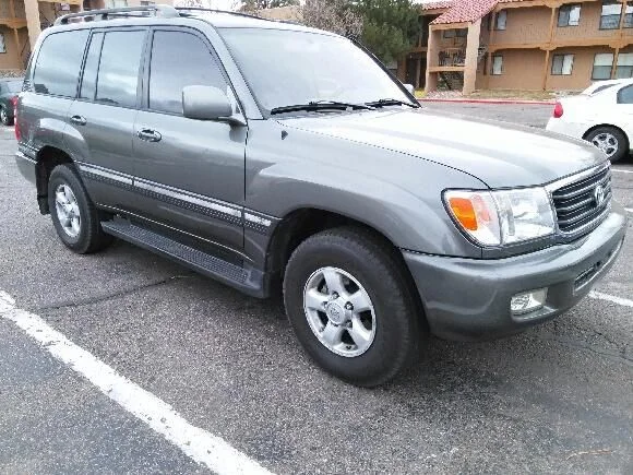

I looked at the second one (white LX470 in Gilbert). I think the head gasket is damaged because the coolant system is at high pressure when the engine is running. The radiator hoses are bulging.
Current owner said they had the radiator replaced because it was leaking....I noticed that the heater T's have been replaced too (shiny-new worm-type hose clamps) so i suspect they lost a "T", engine overheated and then blew the radiator. Fan clutch is also seized.
AHC is toast too. When I tested it from N to H, the LX did a little dance at each corner and then gave up and turned AHC off and flashed the "off" light.
Wow, sure doesn't sound "excellent" as the title suggests...
