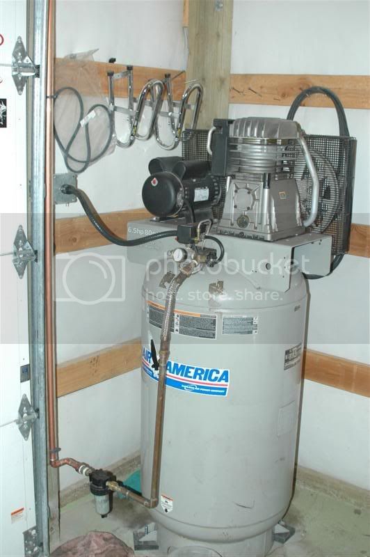

You can also post a picture of your compressor. Just really interested in what others run. Feel free to elaborate on positives and negatives.
Here is a picture of my compressor. 4 cylinder 80 gallon unit with a 7.5 hp motor. 220. Just got it and don't know how well it will do with air, but I'm pleased with the price I paid $500.

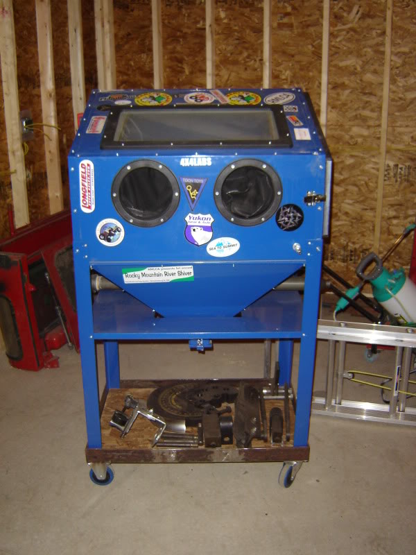

Nice looking cabinet, make/model info pls!

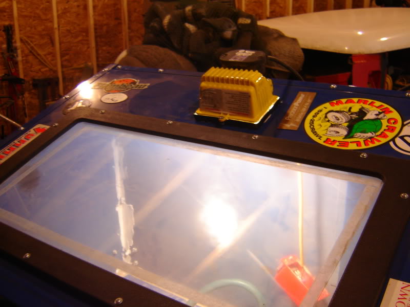

Princess Auto special (like your harbor freight) I use silica sand 4 and 7 and sometime glass beads. My 7.5hp 20cfm compressor barely keeps up. I caulked the inside and have a shop vac attachment on the side. I also cut a hole in the top for a real halogen light.

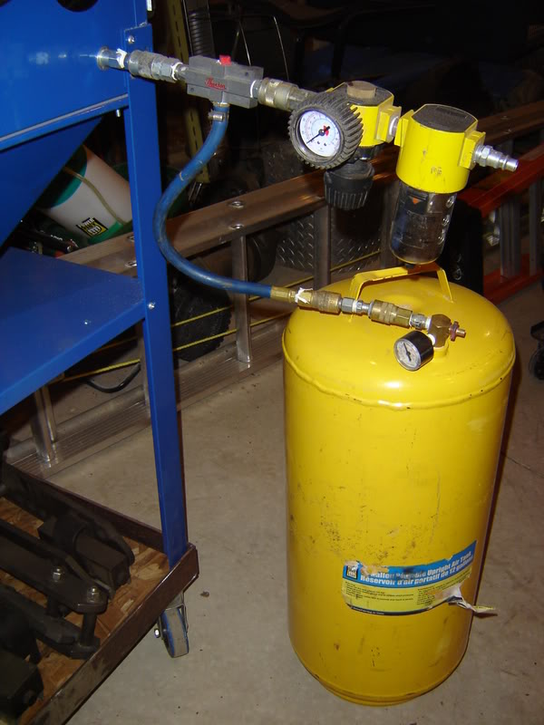

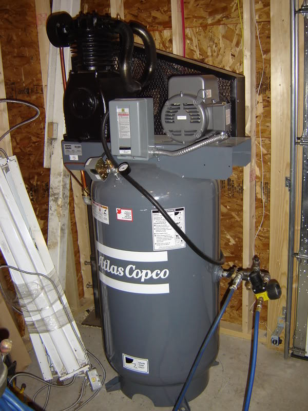

With a Atlas (rebadged Devair) compressor that can barely keep up. It has a franzinator and condenser on it to keep the water at bay:
and I some time add this right at the cabinet.
