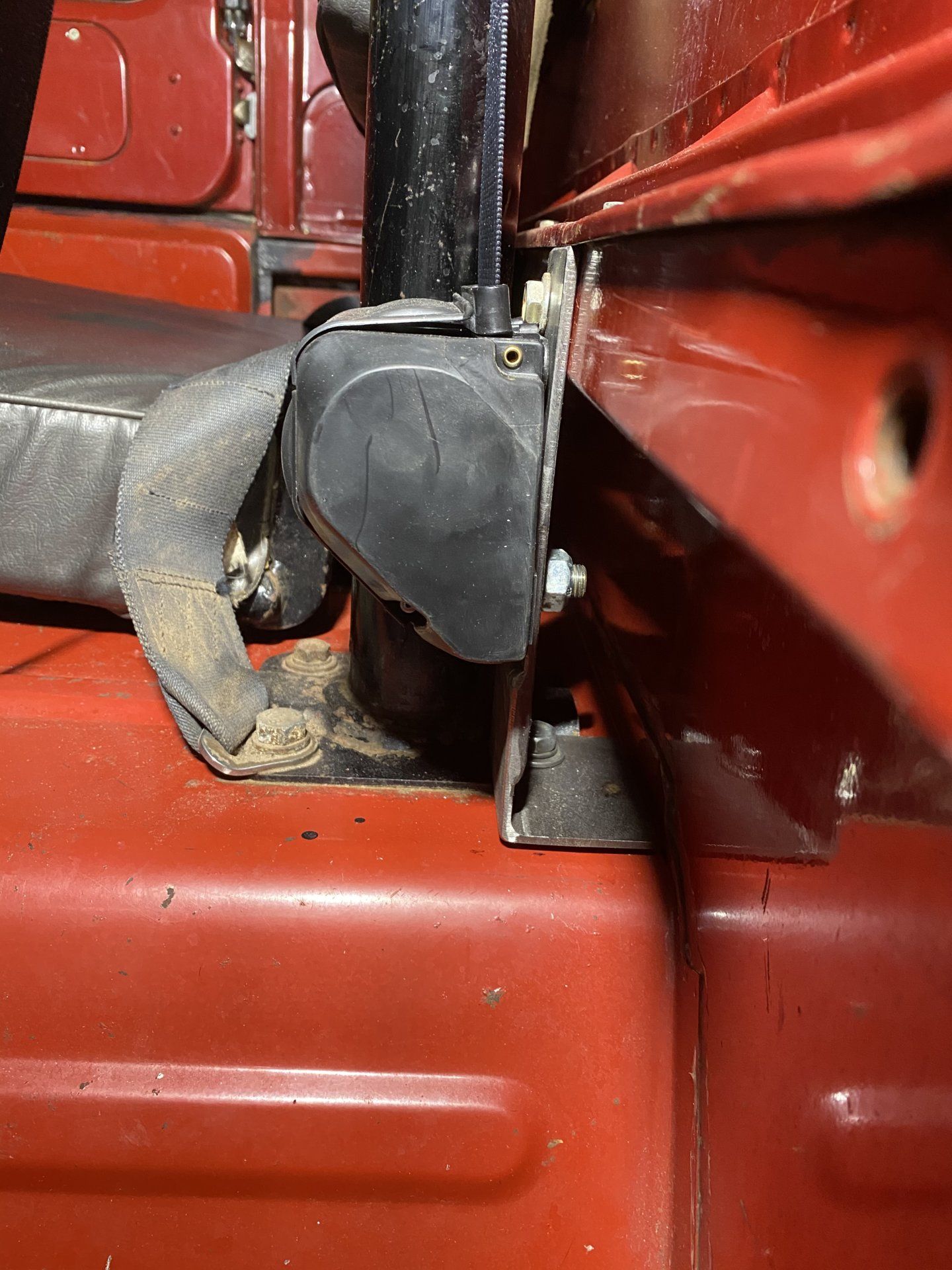

Here is the bracket I made for the driver side. Just angle iron cut with a grinder. I tied into the OEM roll bar mount on the bottom and the captive nut in the tub rail. Rock solid and just about perfect angle for the retractor.

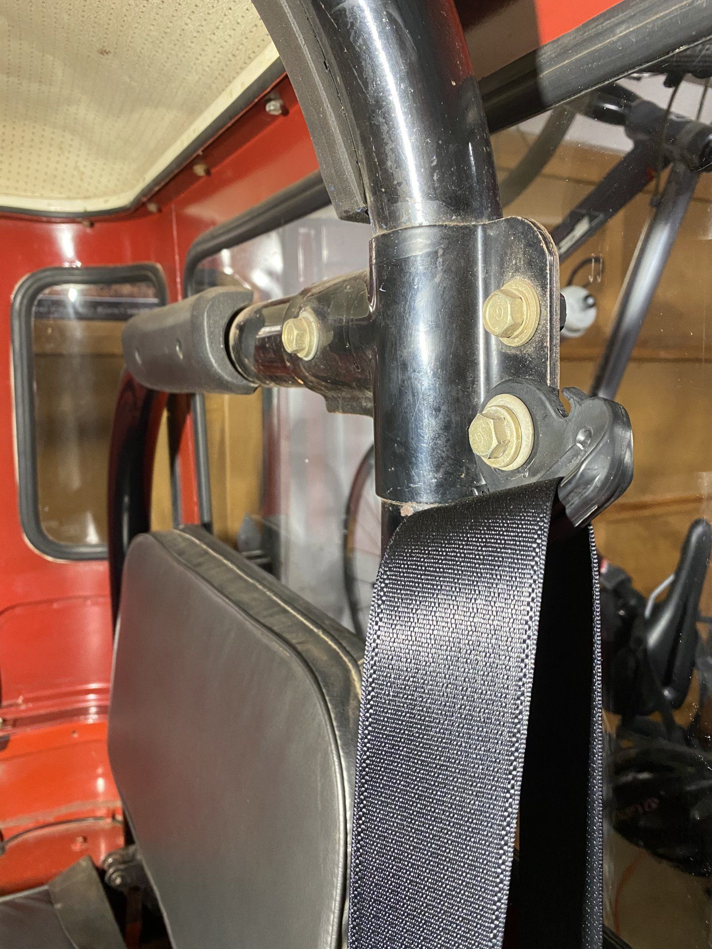

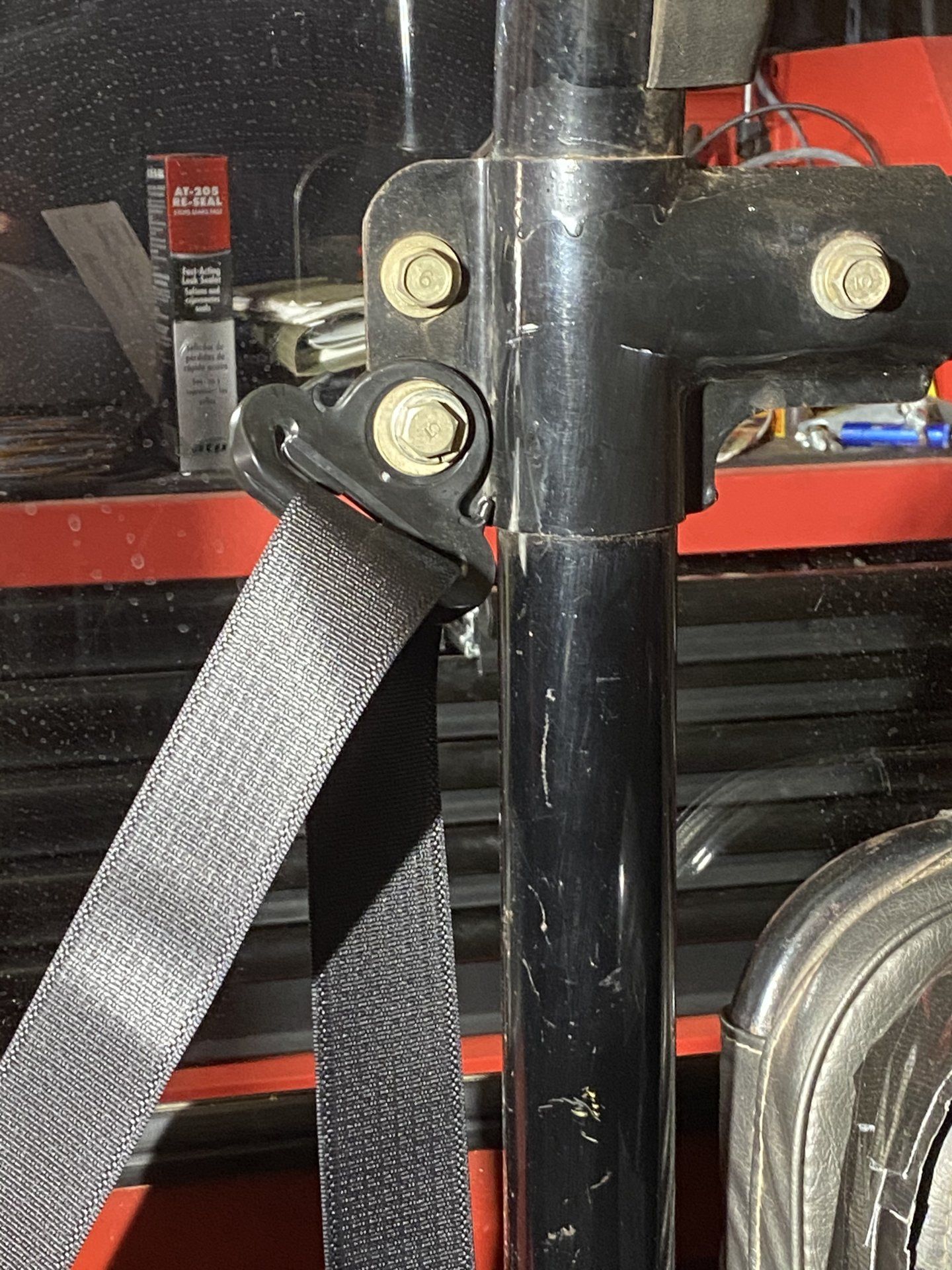

The issue is mostly with the top. I bolted the top mount to the roll bar, as my hard top doesn’t have the mounting spot on the B-pillar. Even if it did, it sucks to have to remove the seatbelt to take the top off. As it is, it sits at a weird angle and doesn’t let the belt slide freely enough to retract easily.
I mounted the DS receiver on the floor using the seat mount bolt. It has to point to the rear, so I zip-tied it to the seat to keep it where I want it. Not ideal or permanent, but ok for now.
