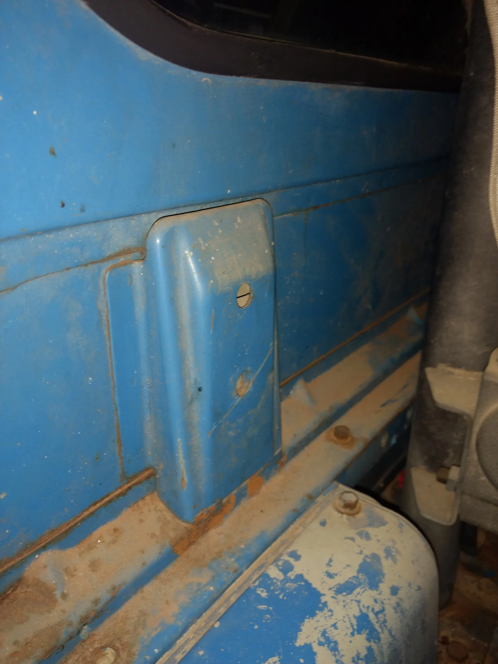

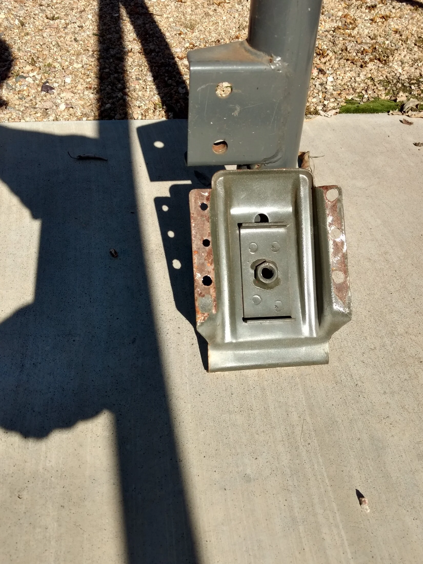

US model had three point seats starting 1/76. Up to 2/78 the seat belts used the hard top to mount the seat belts. At that point the roll bar was needed up (should be beefed up but auto correct keeps changing it to needed). 73 model hard top had the thread nut at the top for three point seats in other markets. This bracket was mounted hard top 1/76-2/78.
Not sure if there were used prior to 1/76 but I did remove a set of these brackets from a wrecked 84 HJ47RV from Australia.
