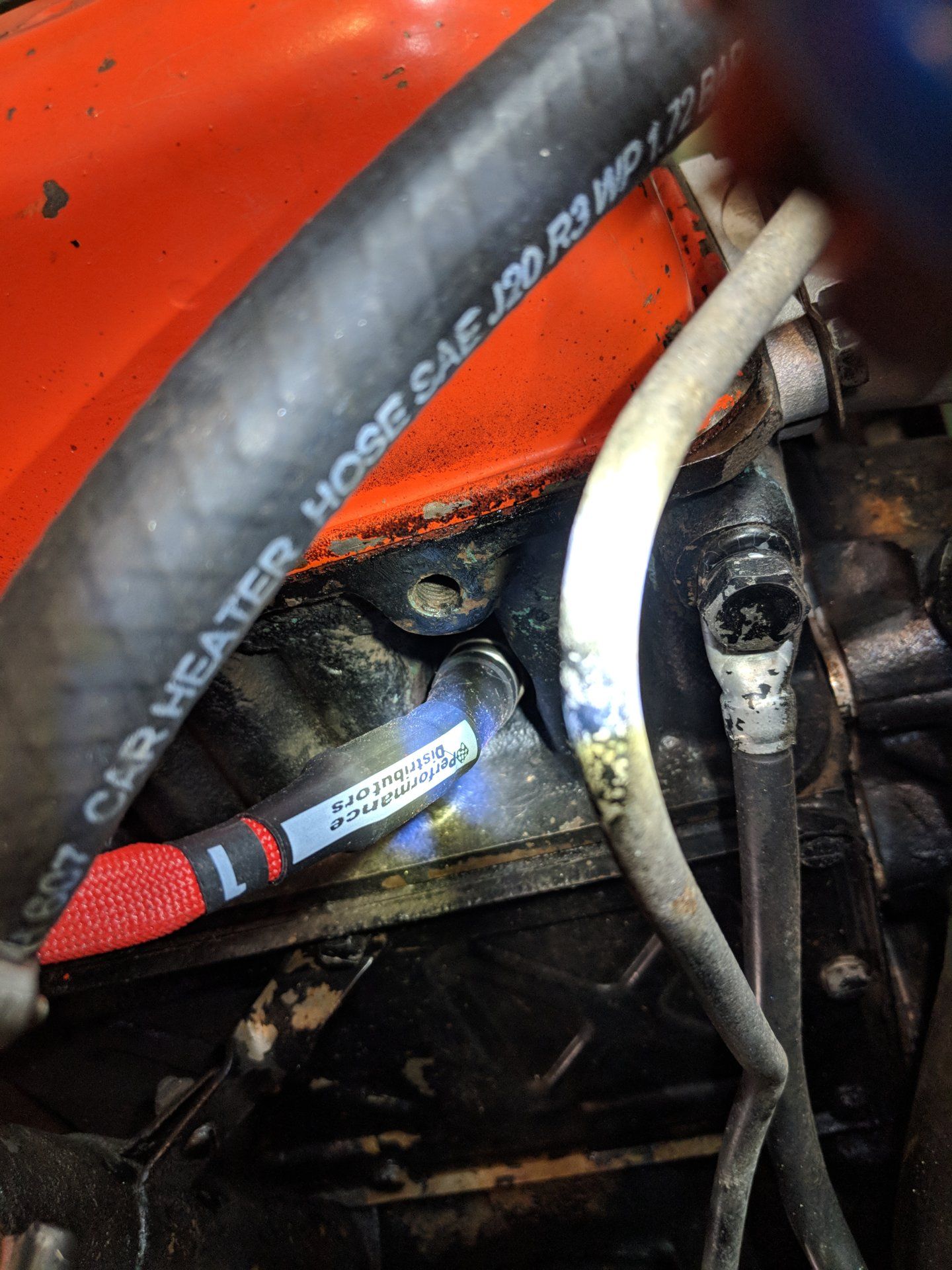

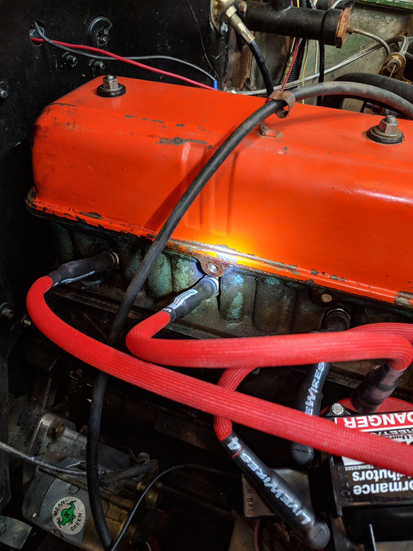

I do not see any hooks on my F. I did find some threaded holes on the passenger side of the head, but nothing on the driver side... though they may be under the manifolds?

I can't imagine that both of those holes are for hooks... that would be an awkward pull from one side of the engine!

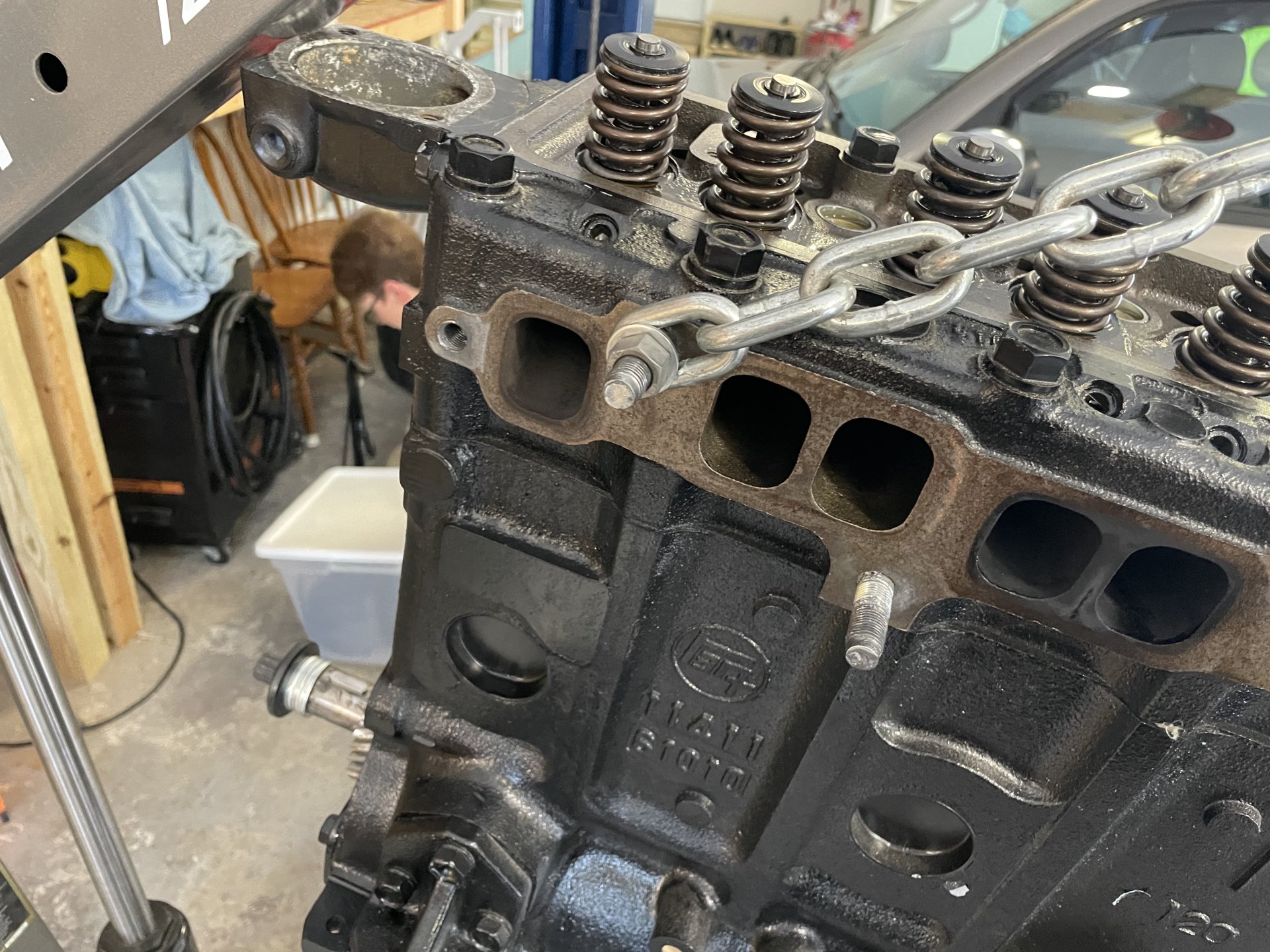

Reviving an old thread, but figured I’d add my contribution. I didn’t have hooks on mine when I bought it, so I made my own. Hooked up to passenger side head bolts to counter the lean from transfer case.
3’ length of chain, and a couple of shackles. Perfect angle…lifted off the front and rear motor mounts at just about the same time.
