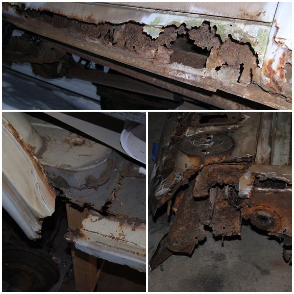

Wish I would have known about that stuff before my 55 rotted away (during my time in Missouri). :(
Unfortunately that steel on your 55 would have rusted away no matter what you did. They just weren't built to stop rust back then because most people bought new ones every couple of years.

Good Lord! WOW, I almost cried looking at those pics! I wish that they would build the LC from an Alum body on a galvanized high strength steel frame. Lighter, stronger, no rust... probably more expensive as well. Kinda what Ford is doing with F150 now.
