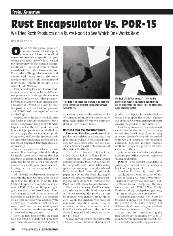

although not as prevalent in our community as POR 15 or Rustbullet, I have heard realy good stuff about Eastwoods Rust Encapsulator paint
also, they have a good write up on a head to head with POR 15
