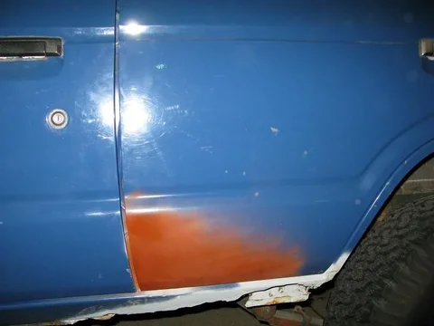

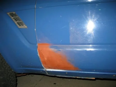

Here is the current status of my doors. I will soon get the blue paint out. I have a little bit more sanding to do on the front.

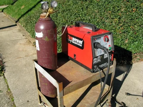

Look what came home with me today. The other one sold before I could get to it.
Anyway, I found an even better deal on c-list...150bux for this:
I did have to drive out to the sticks to get it, but it was a good deal....Fire Power 120 model.
Rockers here I come!!
$&@* an A!!!!
Now were talkin!!!!
Look out :hhmm:cause your gunna go crazy now!!!!
Nice find sir,.....nice find.:clap:
I'm not sure what is in the bottle now, but I was messing around tonight and was making some nice weld beads. I need to pick up some material now and get going on this rocker panel project.

Okay, got mine painted up last week, heres the results. It's about a 40' looker right now, needs some touching up when I get a chance, but I'm glad to have some solid paint on it before the salt hits the road. ;)
I used Duplicolor that I picked up from a surplus shop (dented cans) brushed on to get good coverage, then "texturized" with a Schutz gun. Looks good and hides a lot of imperfections underneath. Was a bit on the cool side when I did everything, and was time constrained.. ended up doing the bedliner before the paint had had enough time to really cure, so masking left some marks :rolleyes:

Wow, rockdoc, Looks pretty damn good! I like the two tone look.
