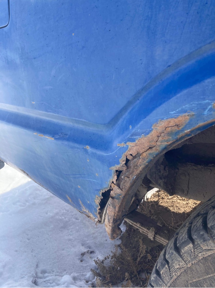

The brake lines are still available from Toyota. If there is not structural rust that is enough to be a safety issue, just drive the truck. Sounds like rust aside it is in great shape.
Good call. I'll make sure! Thanks, man!
Inspect the brake and fuel lines. All of them. That’s probably the first thing they will leave you dead in your tracks. It’s a big Toyota problem. I sold my last 2 Toyota’s because of this, just got sick of dicking around with them. And for me they always burst during subzero temps so you can imagine how fun it was laying on the driveway this time of year. My brother’s master tech at his Lexus dealer has an 80 and he’s also had to replace all or most of his brake lines. Again, it’s a widespread Toyota/Lexus issues. I’ve never seen anyone on this forum post of their frames cracking even though some crossmembers might be at a point of failure. It’s the brake/fuel lines and suspension stuff that will succumb to rust first.
I don’t think it’s a “widespread” Toyota/Lexus issue. All vehicles, if they spend much time in the rust belt and have steel brake and fuel lines, will spring leaks. The only lines that won’t have that problem are NiCopp, but steel remains the standard in the auto industry to my knowledge.
You also discount the effect of age. Any vehicle that’s 15-20 years old can spring leaks in fuel and brake lines, particularly where the lines go into fittings, regardless of rust. I replaced 2 hard brake lines and one hard fuel line on my 100 that started leaking and there wasn’t any rust at all. I’m in the process of making new NiCopp lines to replace all of the brake lines on my rust-free 80 because a few have started leaking due to age.

It honestly doesn't look that bad to me. Mostly just scaley surface corrosion. I would take it to a decent body shop, get the stuff on the body fixed if that even bothers you. Then go over the underside with a wire wheel the best you can and them put some sort of undercoating on it. Then just drive it. It's true that some jobs may take longer but it all just depends on the job. If everything else is in good shape it wouldn't hurt to put some money into it to clean it up a bit. Just don't go overboard with it.

So you got a good deal and you care about rust... why even put yourself through it and start with this vehicle? Just resell it to someone who just wants something to drive for a while... it is not even in any world at all worth entertaining any discussion about paying someone to make this right. None. You'll be over $15k in a second. You live in Houston. There has to be better examples than that to start! Some rust is definitely fixable... but this has rust across virtually everything. That's hours and hours of grinding and painting... just to get you to a place that is not as good as other vehicles for sale within 200 miles from you. Just sell it back up to someone in the north that is used to rust and won't been too put off. Break even or make a few dollars and start over. Life is just too short to put yourself through that if you don't have to... if this was a car you had since new and you planned to keep forever, sure, dig in.... you just got it. Let is pass on to someone else!

Welcome to the forums. As for the rust and speaking from the experience of owning and working on three rusty 100 series, it's not that bad. Most of what can be said has been said already, but I'll cast a vote to just drive it as is and enjoy the hell out of it. Being from Michigan, anything I've ever owned has had rust on it, with the exception of a LS400 I bought while living in Florida. Guess what? They're all just cars. If you want an investment go buy bitcoin or something. Even buying a ferrari in 1970 would not have been a better investment than just playing the stock market for the same amount of time. The smile I have on my face on a back trail deep in the woods, or the occasional wave to a fellow cruiser on the road is enough to tell me I got my money's worth. My 1998 LC I got over 10 years ago was a little rusty then, and a lot more rusty now, but it has been the best vehicle I've ever owned, hands down. Hope this helps you to just enjoy instead of worrying about things going wrong, fixing issues that arise because of rust, and how good you will look cruising around the mall parking lot. Congrats on the good deal.
IMHO, If you like the way it drives, and the brakes, fuel lines and frame are solid - then ignore the body rust and just drive it. Enjoy it for what it is. Chasing side wall, fender and tailgate rust is damn expensive and no fun. There are other cars out there.

Make sure it is safe and drive drive drive. Otherwise, sell soon and find something else that rocks your world.

There is no reason to buy a clean, museum worthy, 100 just to drive. Rusty 100's make great daily drivers...and you know what, it stings less when you get a door ding or extreme pinstriping on the trail. You wont own an Instagram model, but you wont bat an eye at completing the TAT or any BDR.
Based on the rust, I bet the rear of the rocker panels are rotted out behind the side steps as well as the rear lower 1/4 panel sheet metal behind the rear bumper cover.
I'd drive it without hesitation after a thorough inspection.
