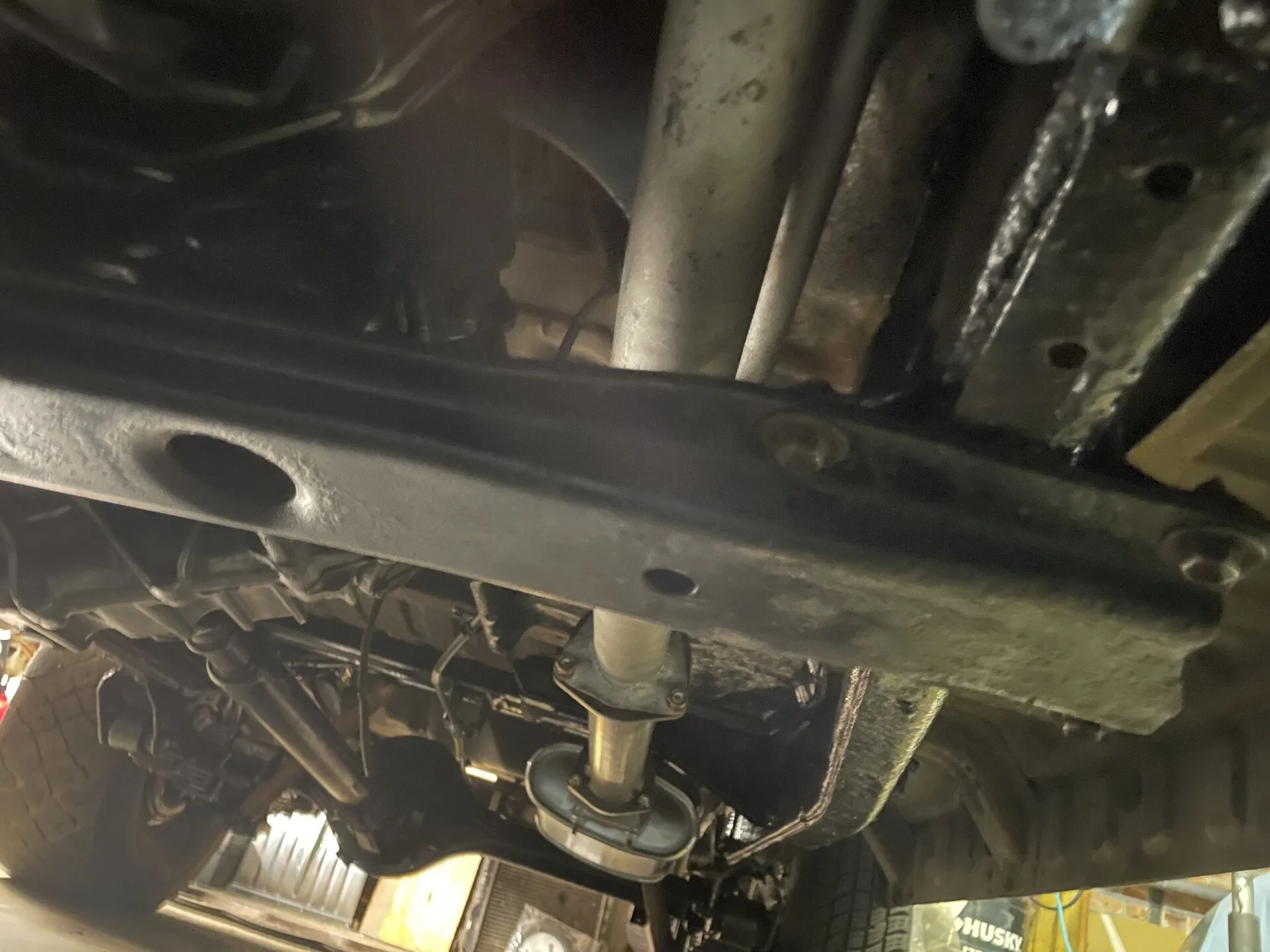

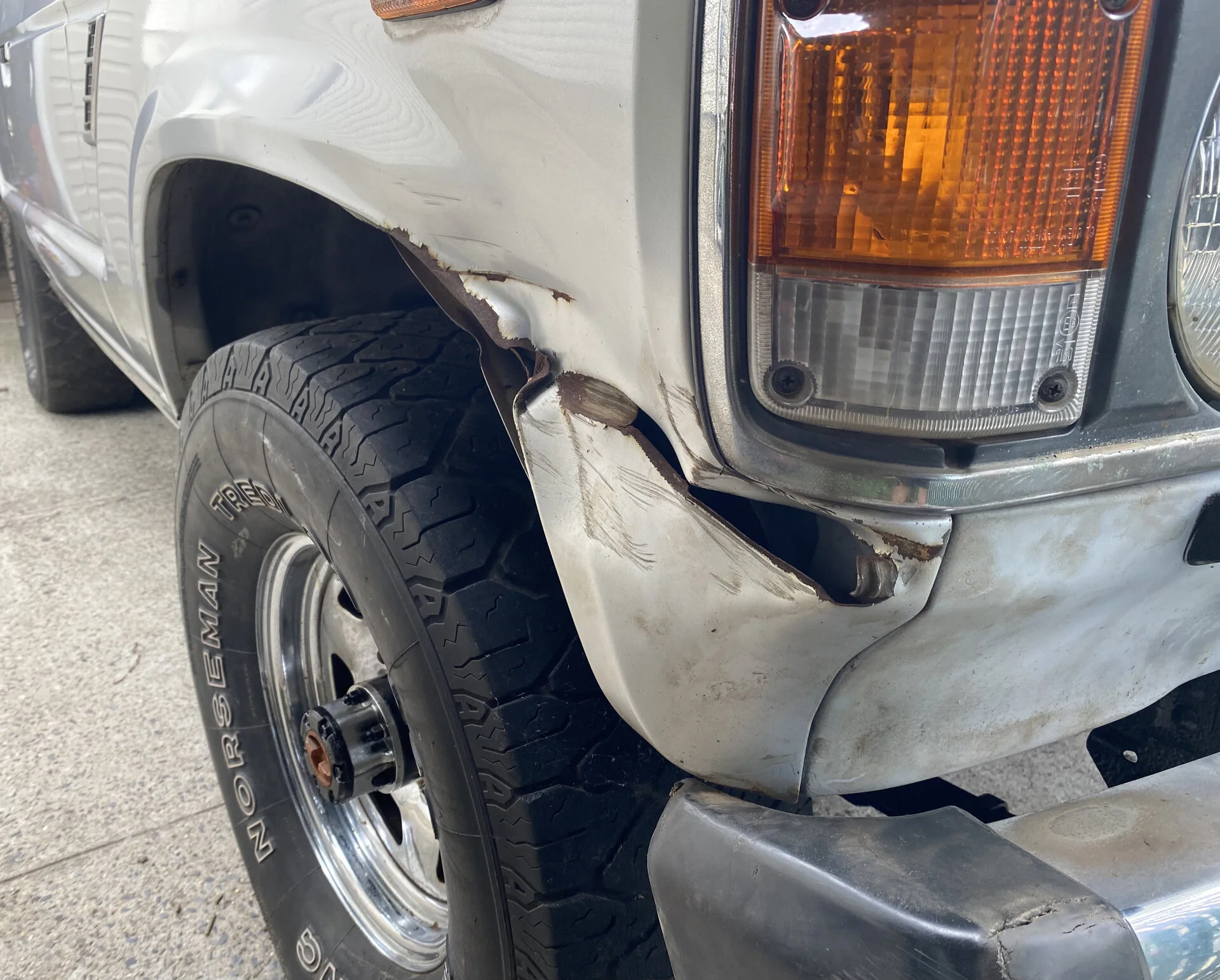

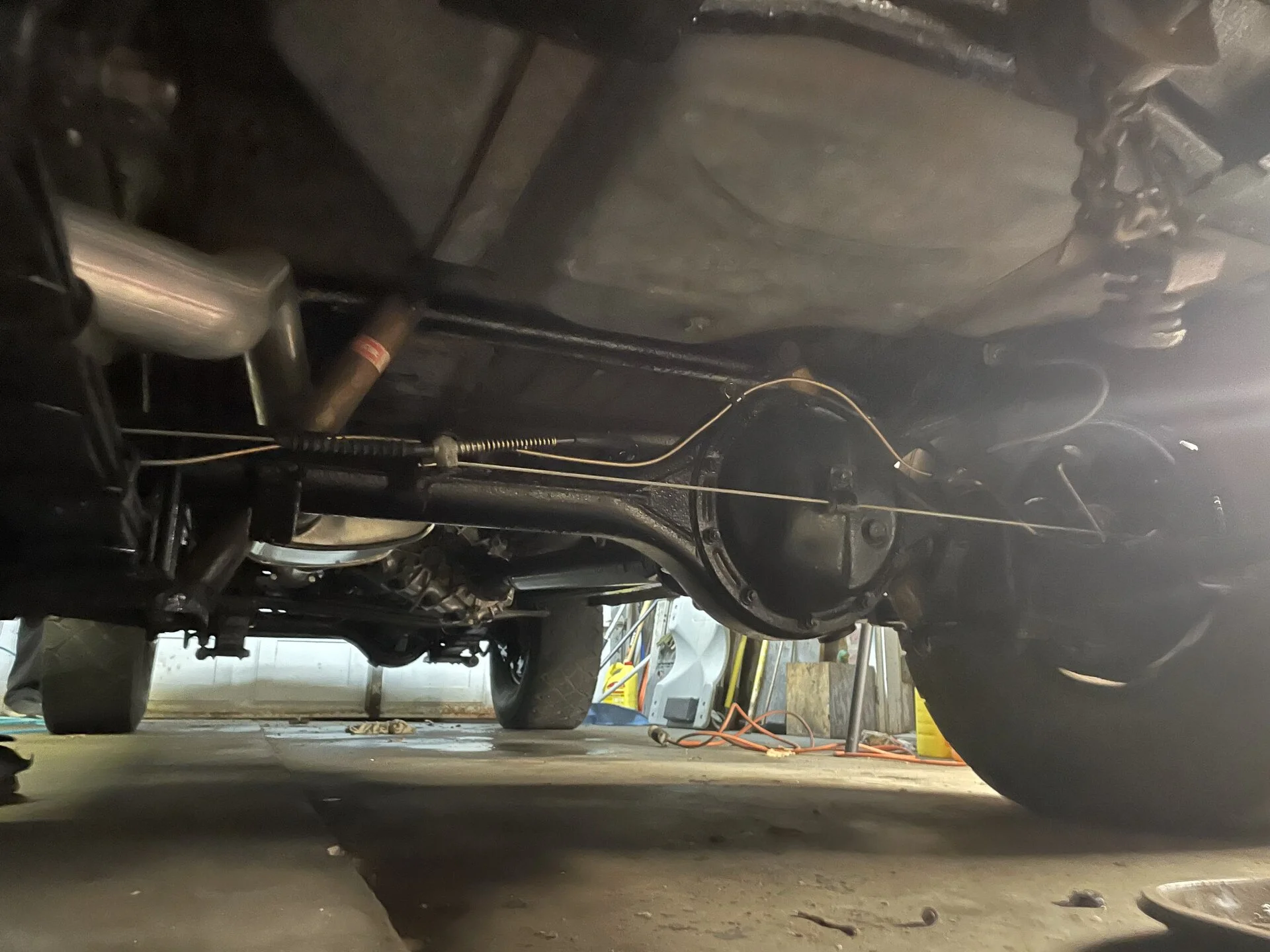

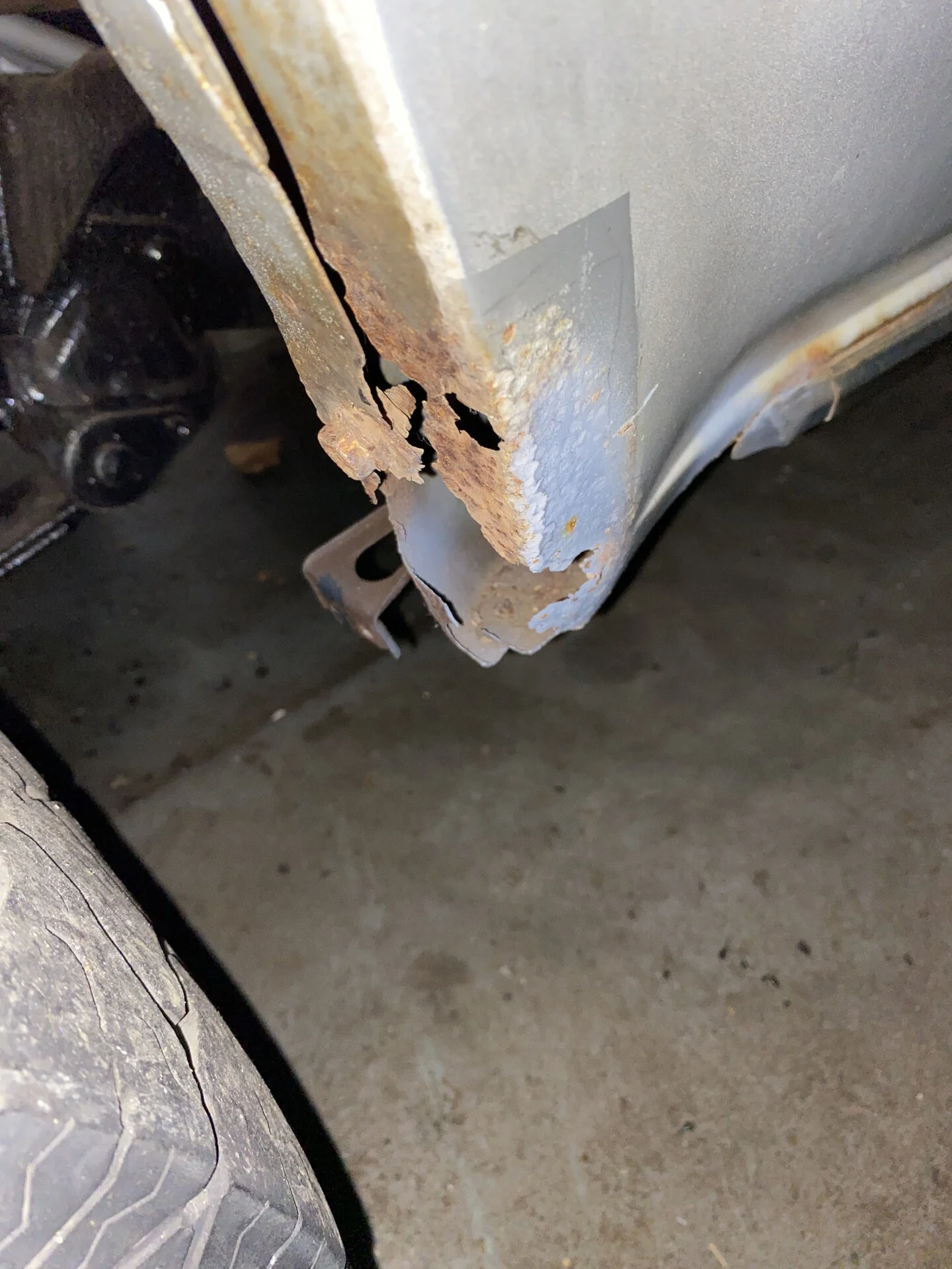

I'm looking at an '86 FJ60 that runs and drives but has been garaged for many years. Tires look like a model last manufactured in the late 90s. Seller sent me some photos of the rusty spots. Just doing the math, even with a lowball offer seems like it might be a bad buy. Thousands to fix the rust, a couple thousand for an OME suspension, another few thousand to get the rig baselined. And at that point I could have just bought a better rig. What do you all think?
I can't help you much, but for what it's worth the engine bay and undercarriage look remarkably clean for a northeast car. Kind of strange how clean the frame is and yet it still rusted out at the wheel wells.

The frame appears shiny, as if it has been treated and painted. Being in Mass., I wouldn't touch that until I saw it on a lift and banged on the frame with a hammer. If the seller won't let you do that, move on.

Assuming the frame is good and there isn't much other significant rust on the truck, you might be able to address the worst of what you've posted above by replacing the fenders. Fenders are a bolt-on item that you could swap out yourself. I'm pretty sure aftermarket fenders are available new.
