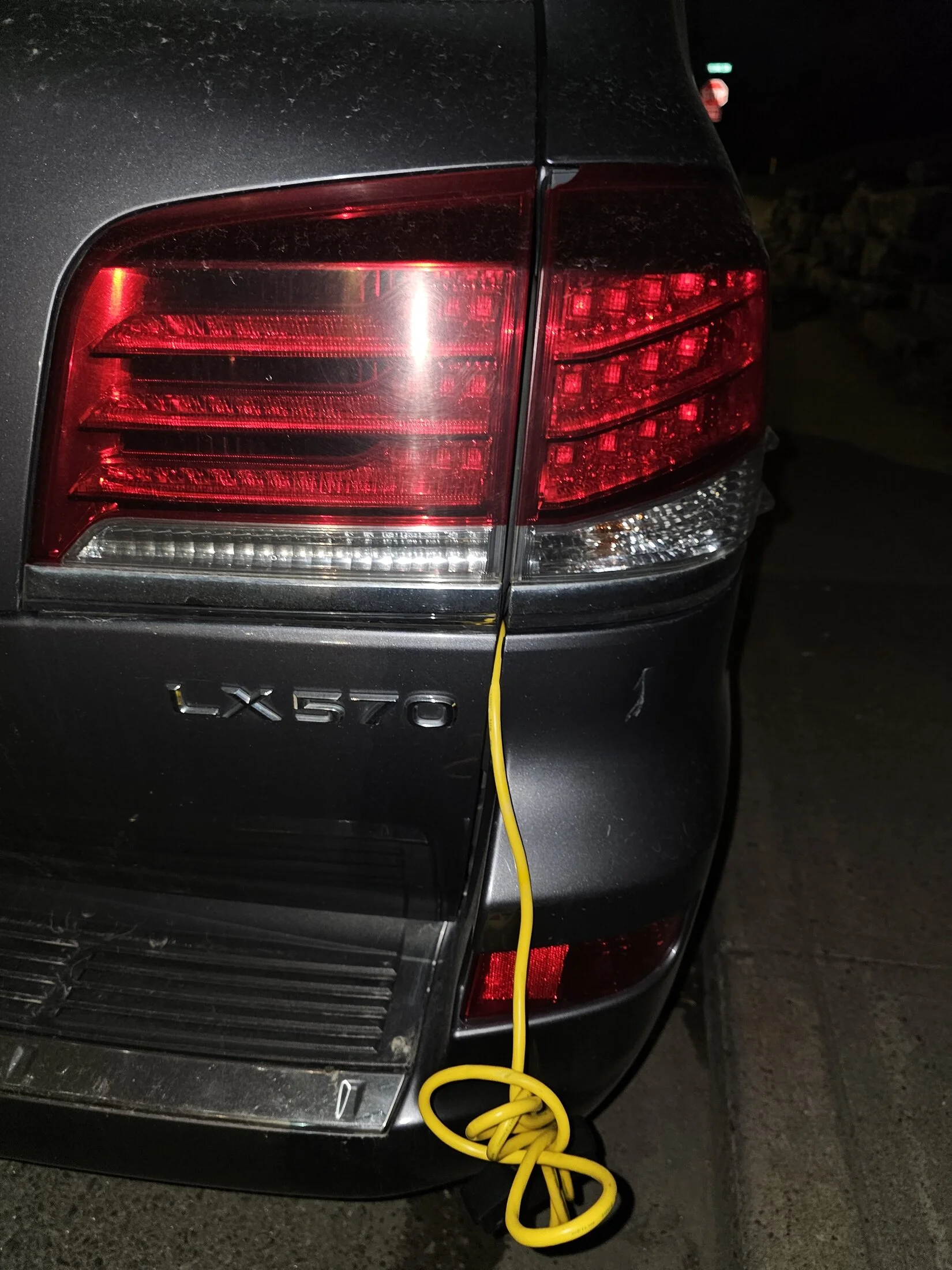

You can wedge it in the lower tailgate and still lock it.
For what it's worth, I think you can take the same approach with most extension cords at the lower-rear corner of any door as well.
Look for an appliance extension cord. Usually short, like 6' but they are flat rather than round. I have used them for over a decade through the tail gate for shore power to the fridge.

We ran an extension cord from our goal zero 1500X inverter in the cargo bay to our tent that had a flat 3 conductor cable through the tailgate. We found it easier on the weatherstripping than the round cords.

I have an 8' extension cord coming up through the bottom of the tailgate near the springs, under the rear plastic lip, and into the cabin. The male pigtail hangs down about 10" over near my trailer plug outlet. I use this to power the fridge when at home or in a camp with power, as well as to charge my Bluetti. It's been in there since March of 2021 without any wear or tear, including a few times driving away while forgetting to unplug... When it needs replacing, I'll look into one of the flat appliance cords recommended above.
