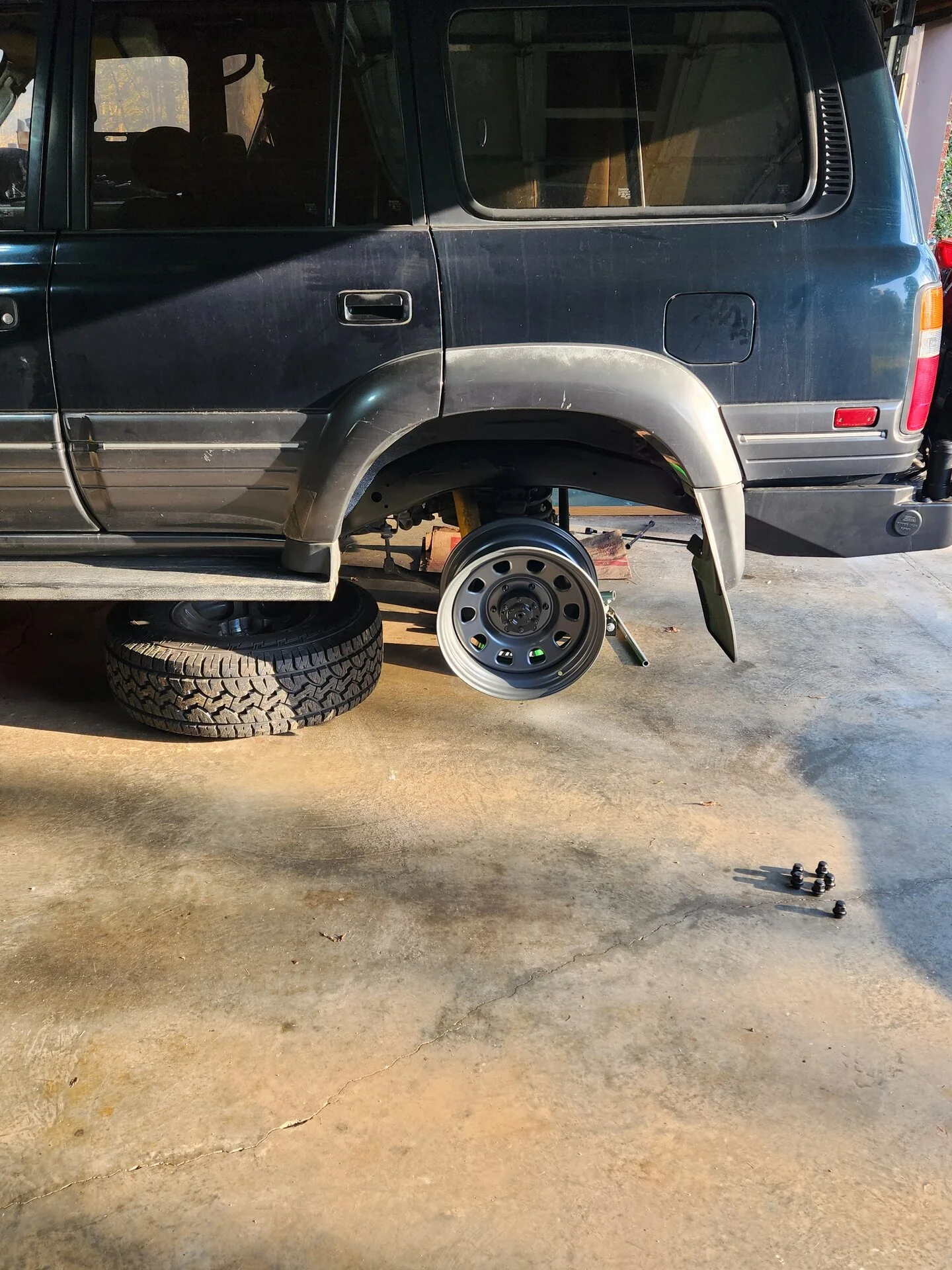

Just an FYI I ordered one of these wheels to check fitment. Fit fine on the front and rear, clearing both calipers with room to spare. I'll be ordering the other four soon.

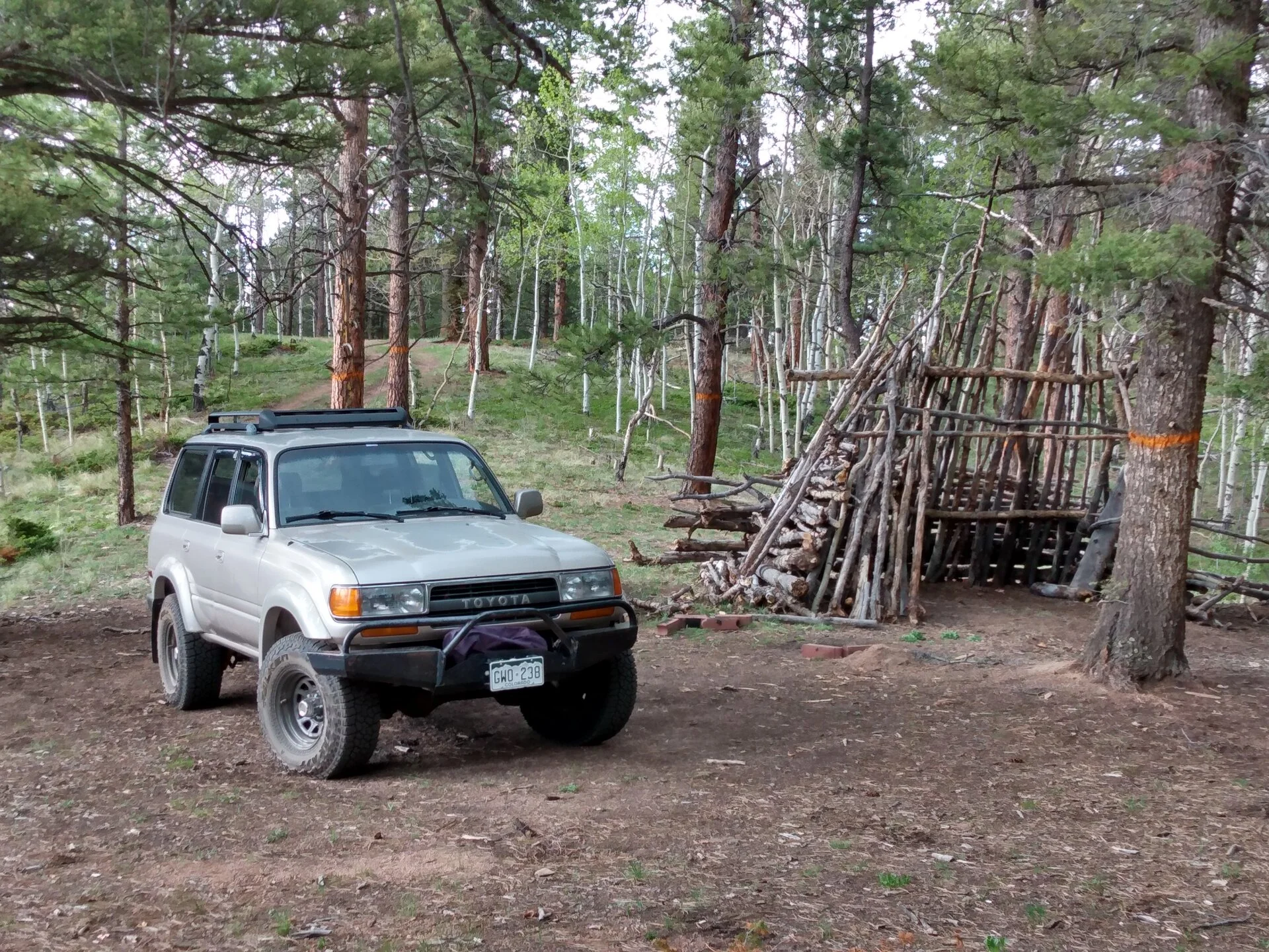

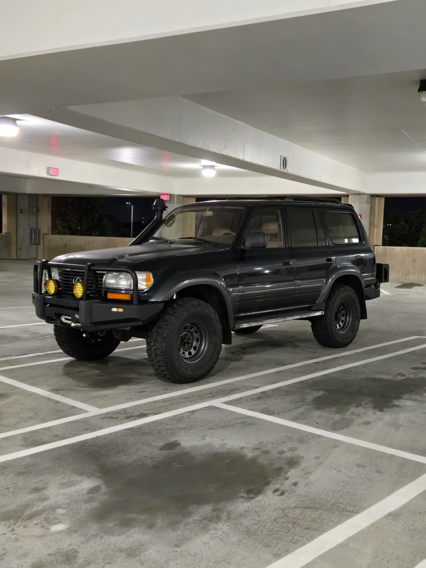

Different make, but a '93 on 285-75s w/flares, 16x8 -12 offset.
Don't imagine a '96 would present a difference.
Yeah that's a perfect fit with the -12 offset. Do you have any rubbing at all on the flares? I wouldn't think so since it really doesn't poke out much further than stock wheels. Look great!
No, none. Even when fully tucked.
Forgot to mention, they are 4.25" backspace so no spacers either.
