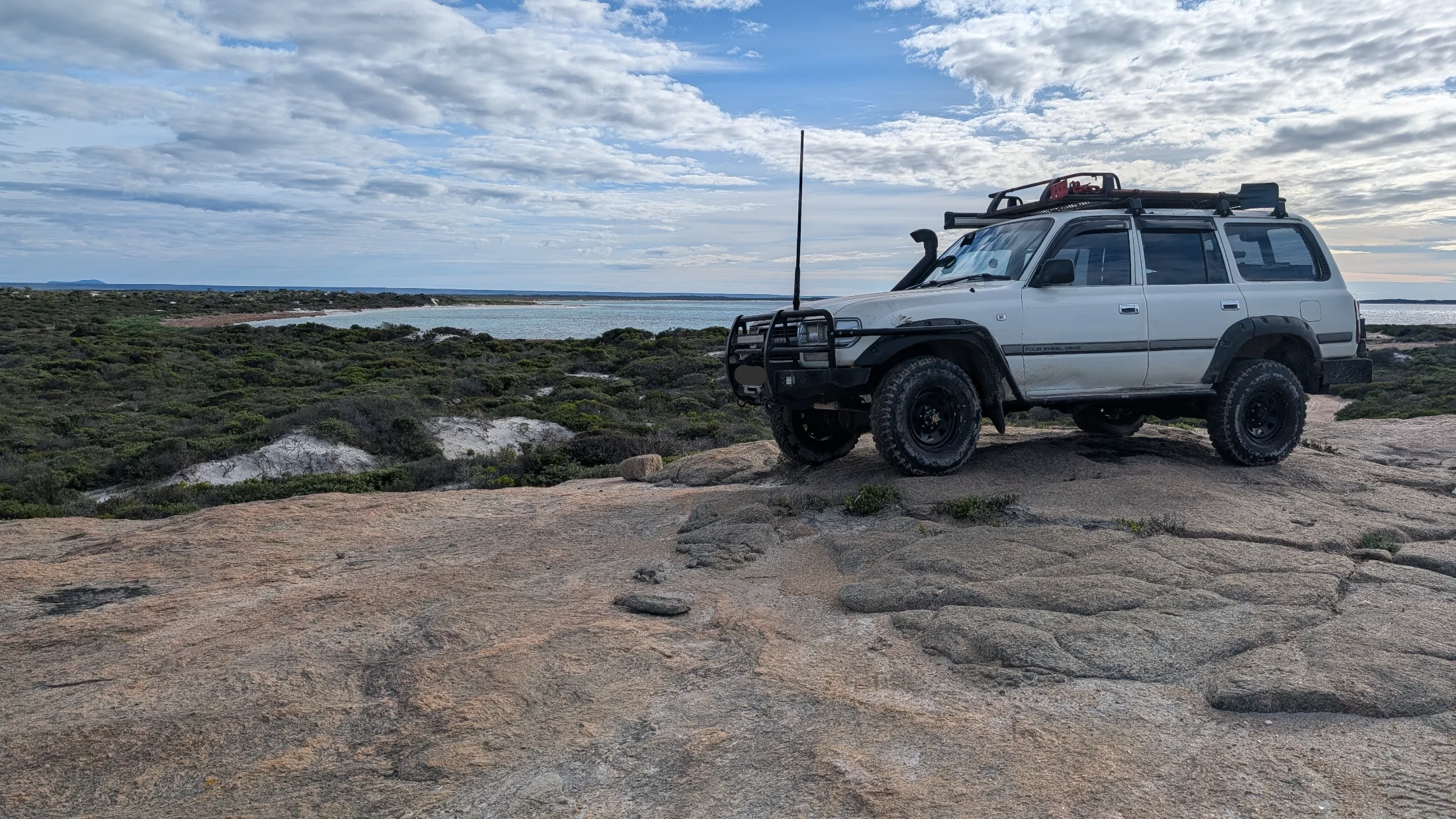

Vehicle & Setup:
  • 1995 Toyota Landcruiser 80 Series
  • 1HZ motor, naturally aspirated diesel
  • Over 500,000 kms on the clock – she's a bit tired and low on power, but being a 1HZ it'll surely run through the apocalypse
  • Wheels: Dynamic Sunraysia steel wheels, 6" wide
  • Tyres: Dunlop SP Road Gripper FA 225/95R16 (yes, they are very skinny!)

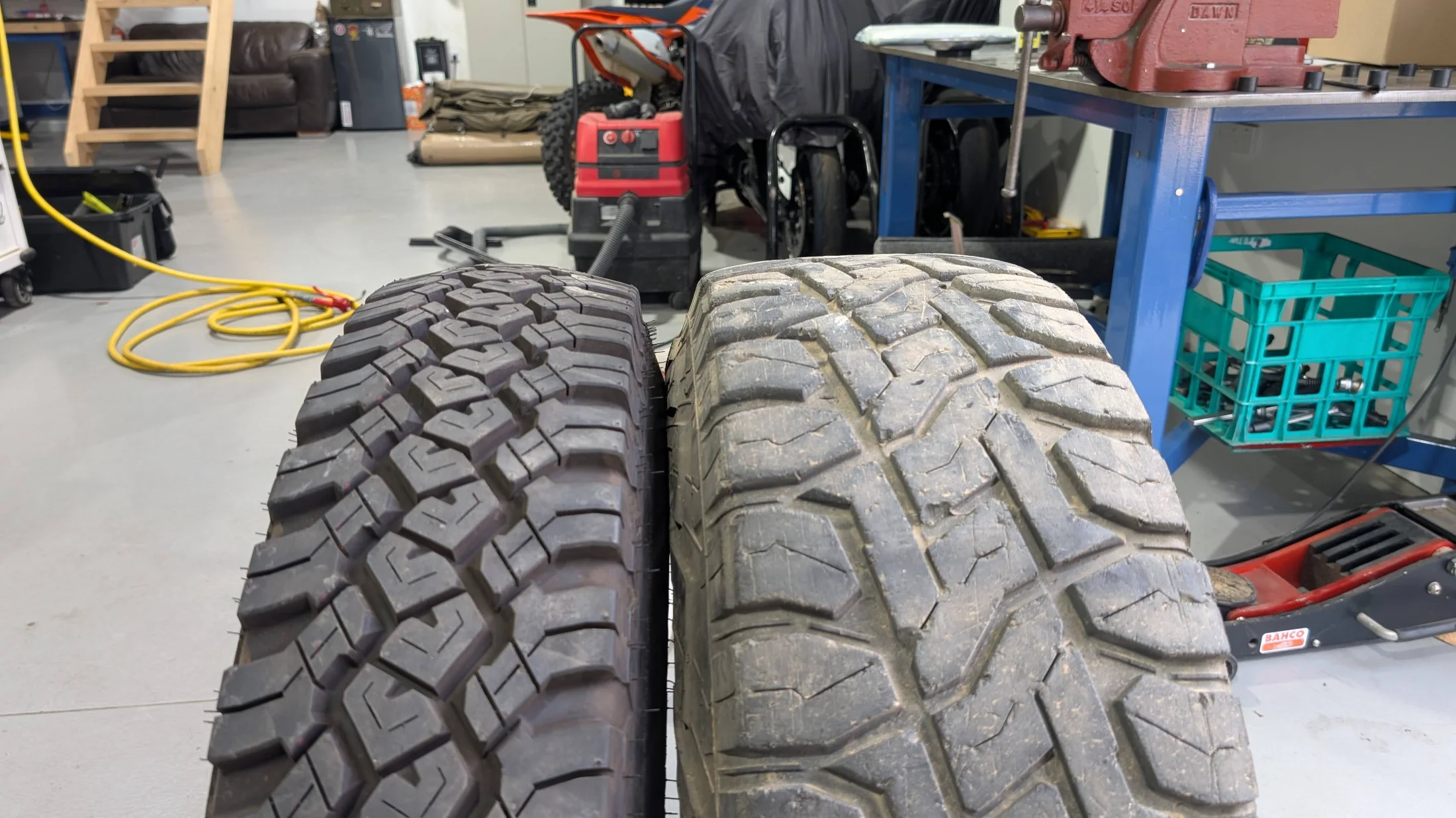

Previously, I was running Toyo Open Country R/T in 285/75R16 (about 33" x 11.5"), also on Dynamic Sunraysia Steels (7.5" wide, maybe???). Comparing the two setups, the new wheel and tyre combo is 6.2kg lighter per corner – dropping from 40.3kg to 34.1kg. That’s nearly 25kg less rotating mass across the vehicle, which makes a noticeable difference. Not to mention the lighter load on my rear swing-away carrier.

  • Durability & Tyre life: Probably the biggest con. The Dunlops only have about 10mm of tread depth from new, compared to 20mm+ on the Toyos or the big Mickey Thompson mud terrains. I’d guess they wear at a similar rate, but because they start with half the tread, they feel worn out much sooner. That said, I can get them for about $80 a tyre – versus $350+ for the wider, more aggressive ones – so the price makes up for it in my view. Zero punctures on the entire trip. TBF the patrols also did not have any punctures. After the 16,000kms I've used up about hald of the 10mm tread depth, Which sucks. But, I didn't take it easy on the long days of gravel, rocky roads, so, make your own conclusions about cost vs. life.
