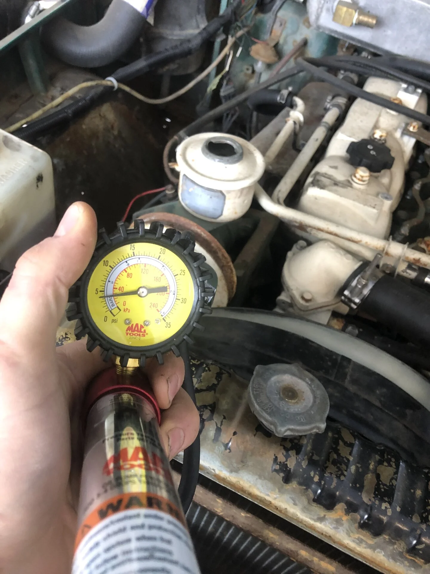

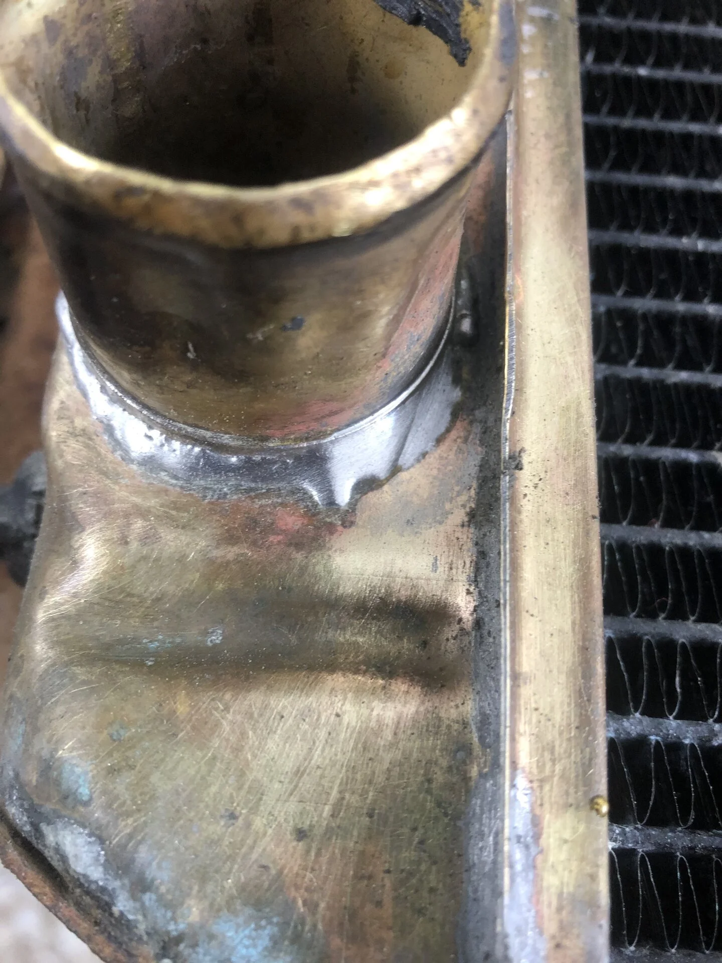

The water pump went on the cruiser just as we were moving up-island. Luckily, for me, a buddy agreed to drive it up for me before we realized just how much of a "s*** the bed" situation the water pump was in. He limped it from gas station to gas station filling the rad and 4, 2 gallon jugs and just limped it here. I put it in storage and got busy cleaning up the place and fixing the shop up till I could roll the cruiser in there and do the water pump. After cleaning the last owners garbage out fo the shop with a skidsteer and pouring a new floor I finally got around to fixing up the cruiser. First I put the batteries that I had stolen out of it to jumpstart other stuff back in and charged them. Tthen after doing the pump I filled it with coolant and fired it up, only to find a leak and discover that the rad had a crack/pinhole.
I drained it and cleaned up around the hole, soldered it, reinstalled it and pressure tested it before filling it this time *smart*. It held pressure all night. I called it good to go and filled it this morning and now I'm just working the air out of the system.
All in all I'd call this a good day.
View attachment 3182861View attachment 3182860

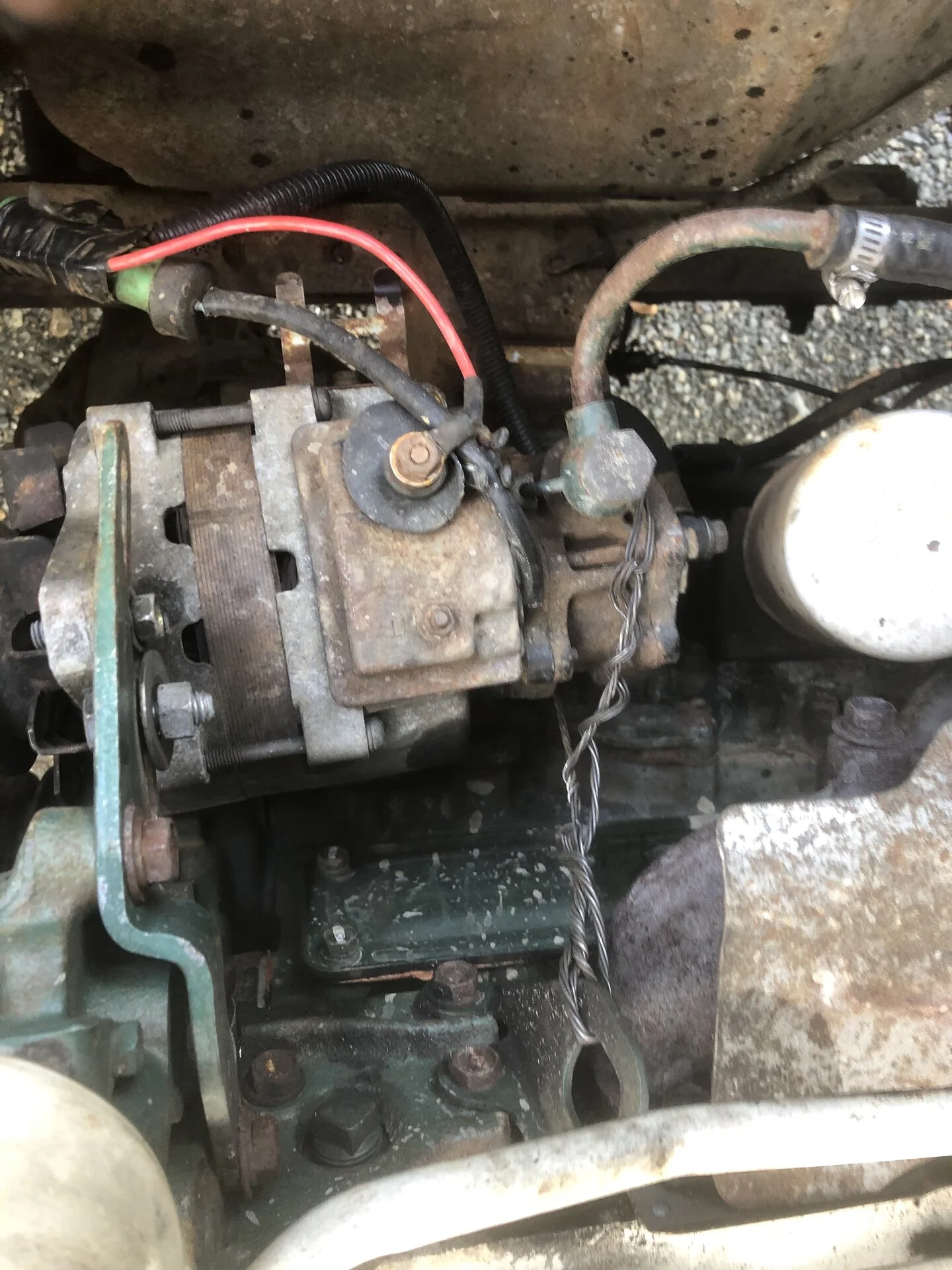

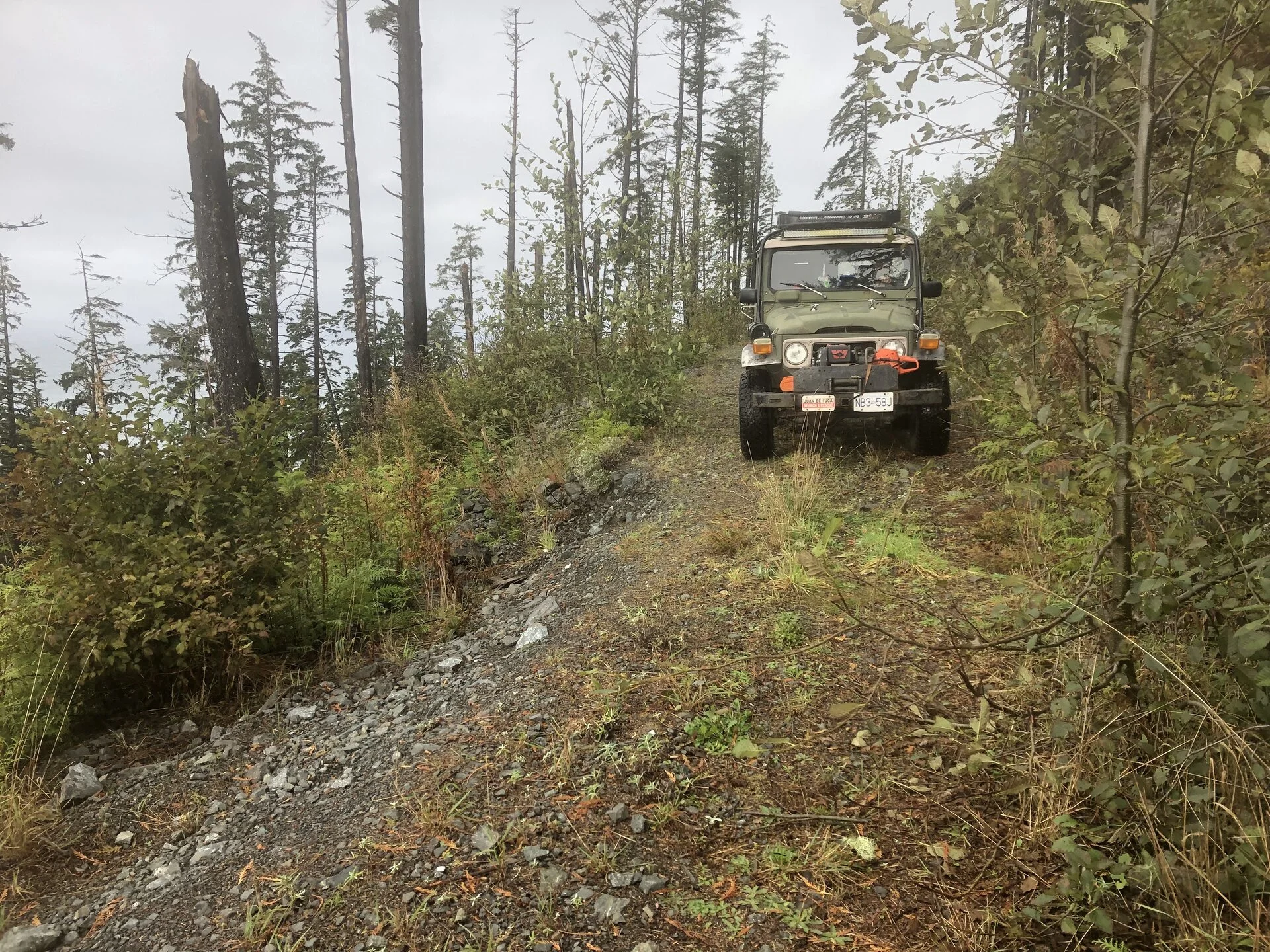

So. Took the cruiser hunting last week. Drove it up past Port Alice and out to the west coast. It worked great until the bolts holding the Alternator on broke off and then it overheated and blew the rad. I pulled over, in the middle of absolute nowhere and pulled the rad out and was looking at a 10hr walk into town. Out of nowhere a forester pulled up and gave me a lift in to Port Alice where I was able to find someone who could sell me some JB weld to patch it back together and get me back on the road. I spent the night in Port Alice and then caught a ride back out to the downed cruiser in the morning and put it back together. The Jb weld reduced the deluge to a minor leak and I limped the old girl into town. Me and an old guy, Dave, drilled out the broken bolts and he made/modified me some new bolts to replace the old ones and welded up the bracket the alternator pivots on. I spent the rest of the week hunting and topping up the rad every couple of hours or so.
After a good week in the bush I limped home and am now in search of a new 3b diesel rad and the bracket that the alternator tensioner bolts into.
