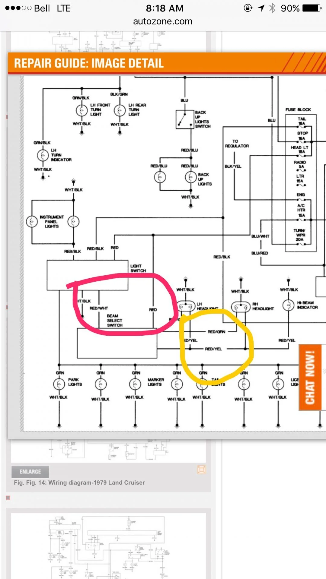

So now that it is so fast something else decided to act up. I think it may be the switch in the steering column but I only have headlights when I hold the high low selector to "flash". When it's in the constant normal and the constant high position there are no headlights but if I pull it all the way towards me, like I'm flashing my high beams at someone, then they come on. I have full power at the pull switch in the dash and all of the running lights and turn signals and brake lights all work fine.
Any thoughts before I start pulling things apart?

- Fixed the headlights. Turns out one of the spade connectors on the switch had wiggled off just enough to shoot us in the foot

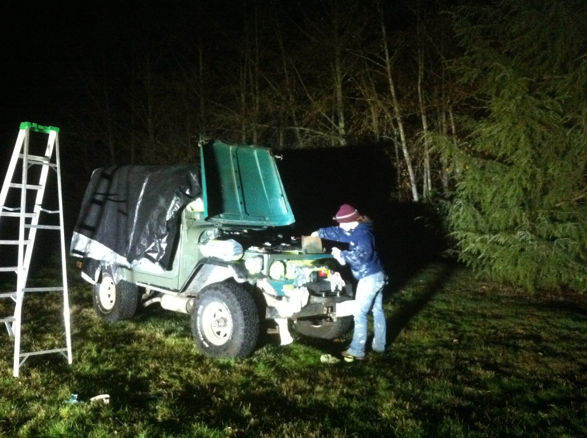

- She has been painted. (In the rain, at midnight)

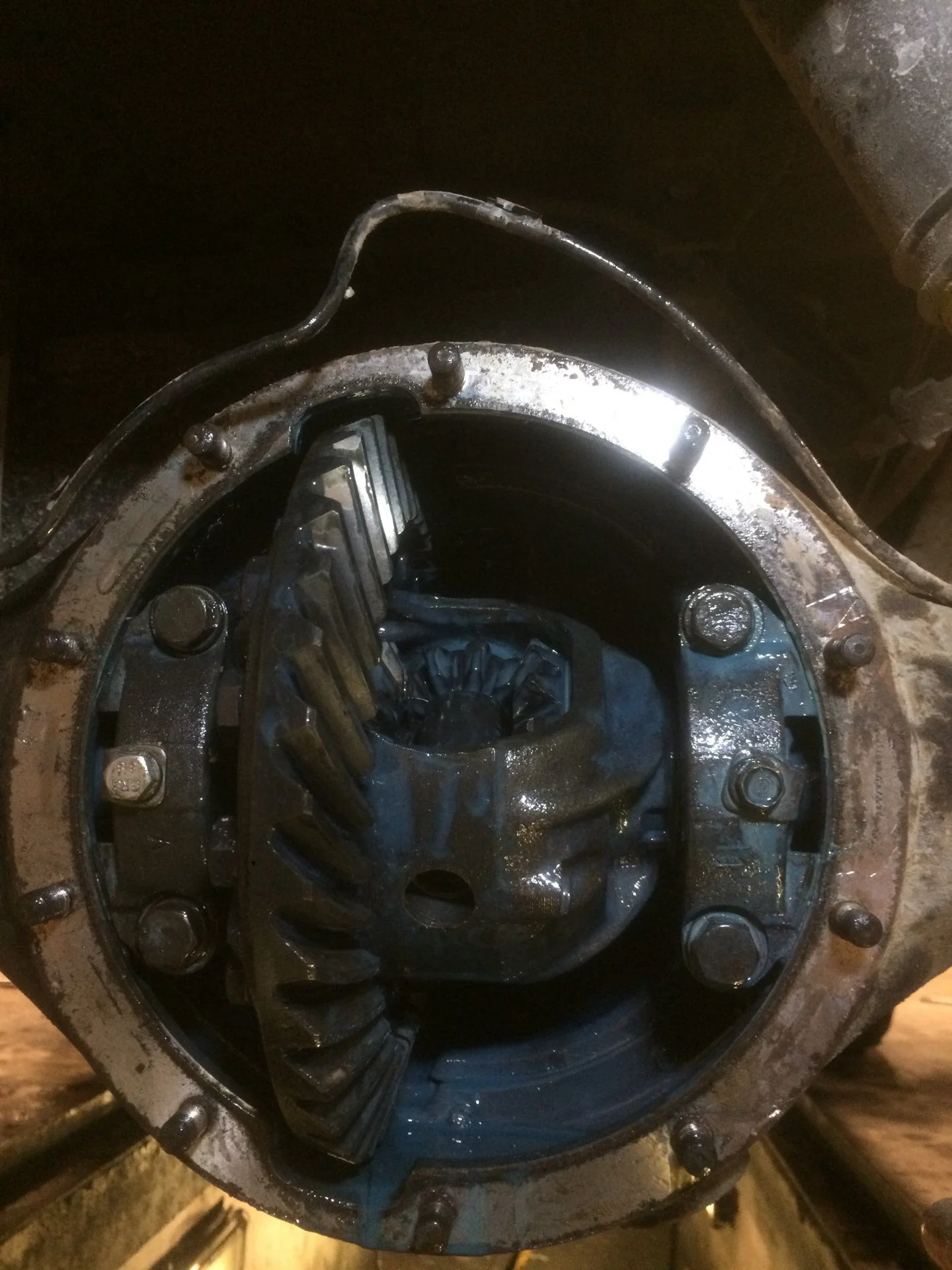

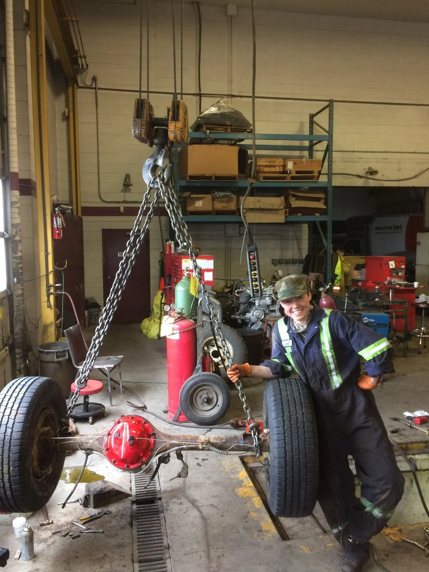

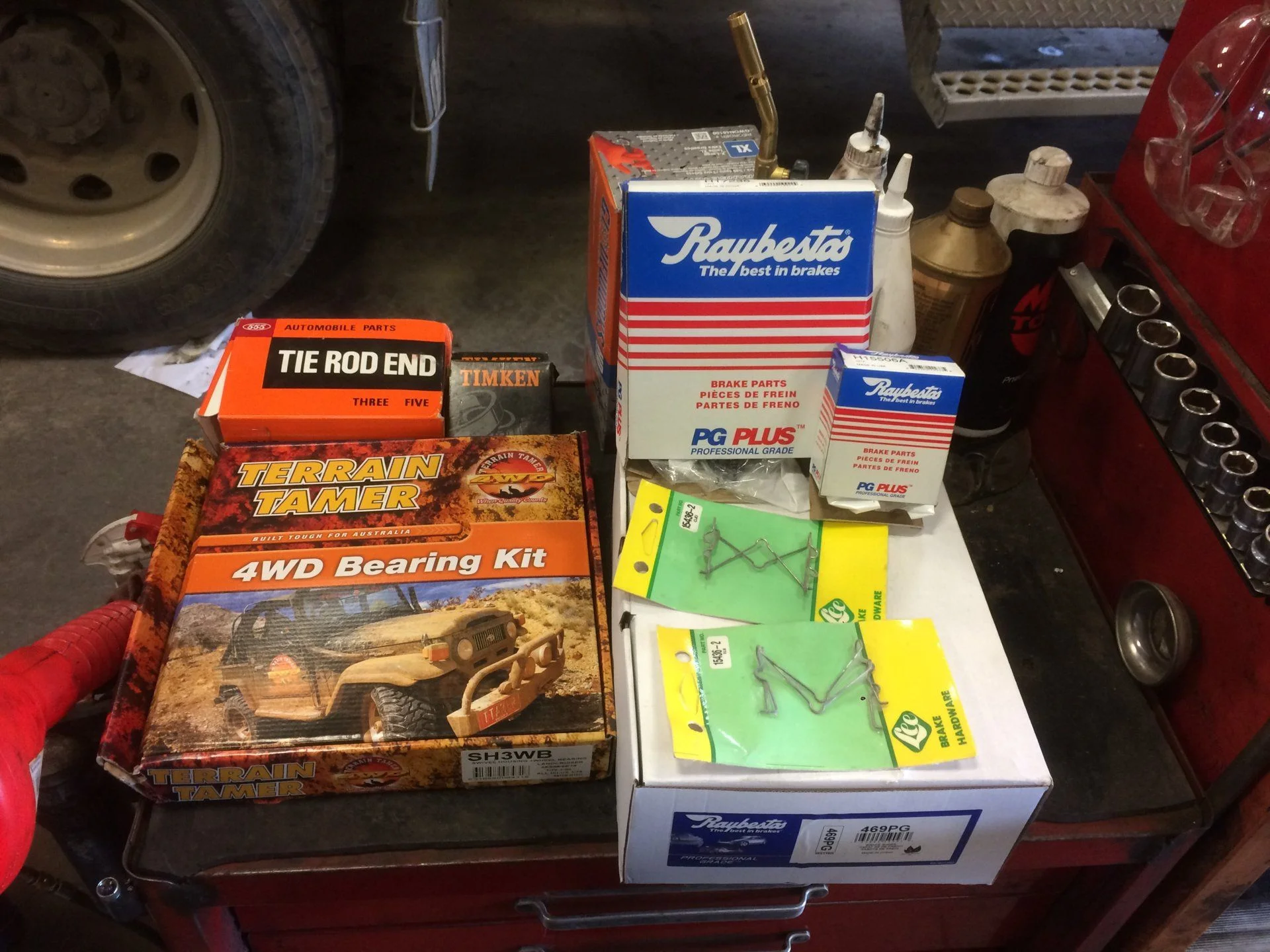

We went to replace the rear brakes and Jess pulls the wheel off and said "I don't think the brakes should look like this". It turns out the wheel seal was leaking and the brakes were greasy. So we got a new wheel seal but in order to do the wheel seal you need to take the diff cover off and pull the idler shaft out of the spider gears (below). So that you can take the C clips off of the axles and then pull the axles out. Well I spent about two hours trying to get this little sucker out and we eventually had to swap in an axle out of a 70 series that we had waiting in the wings. The good news is that I took the old 3rd member and had the ARB Air locker, we also had waiting, installed and then swapped that into the 70 series axle that was now installed on our 40 series cruiser... so now we just need to hook up the compressor and we have our rear locker.
My guess was that at some time someone ran this diff without oil. I'm amazed that this thing ran as well as it did. I had no idea that this little bomb was in there.
This was the idler shaft in our diff.

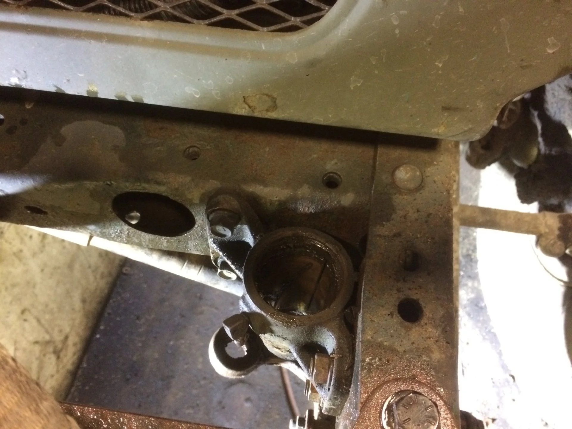

This pivot was loose and responsible for 90% of the movement in our steering.

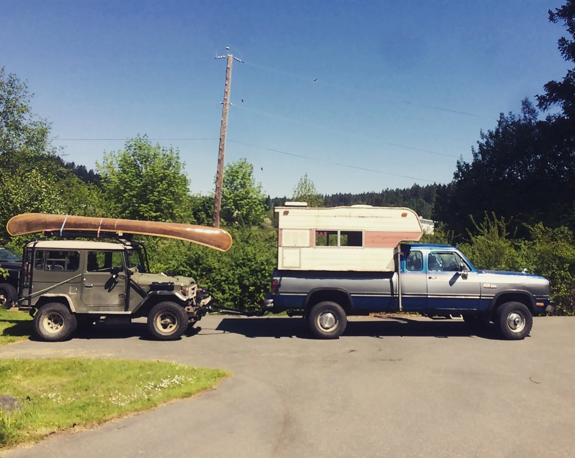

We also rigged the cruiser up to be flat towed behind the truck. It worked really well unless we made too sharp of a turn. If we did that the wheels would cam over all the way and Jess would need to get out and steer it around the corner. Usually pulling into a gas station. I think the camber is out but I have a rebuild kit, from gsb15, that I'm going to do for the front knuckles. I got the tow bar from work. There was one and a pintle hitch sitting in the back for the last 5 years that my boss said I could have.

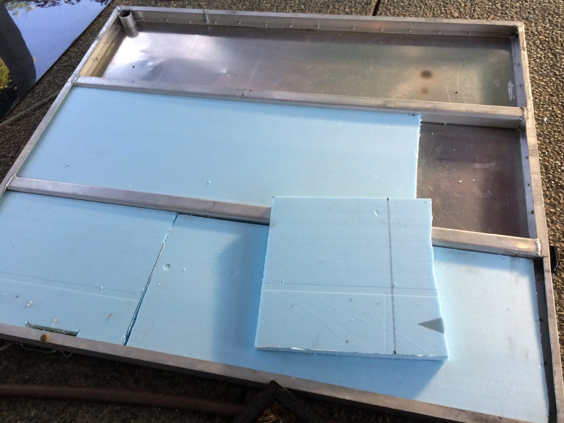

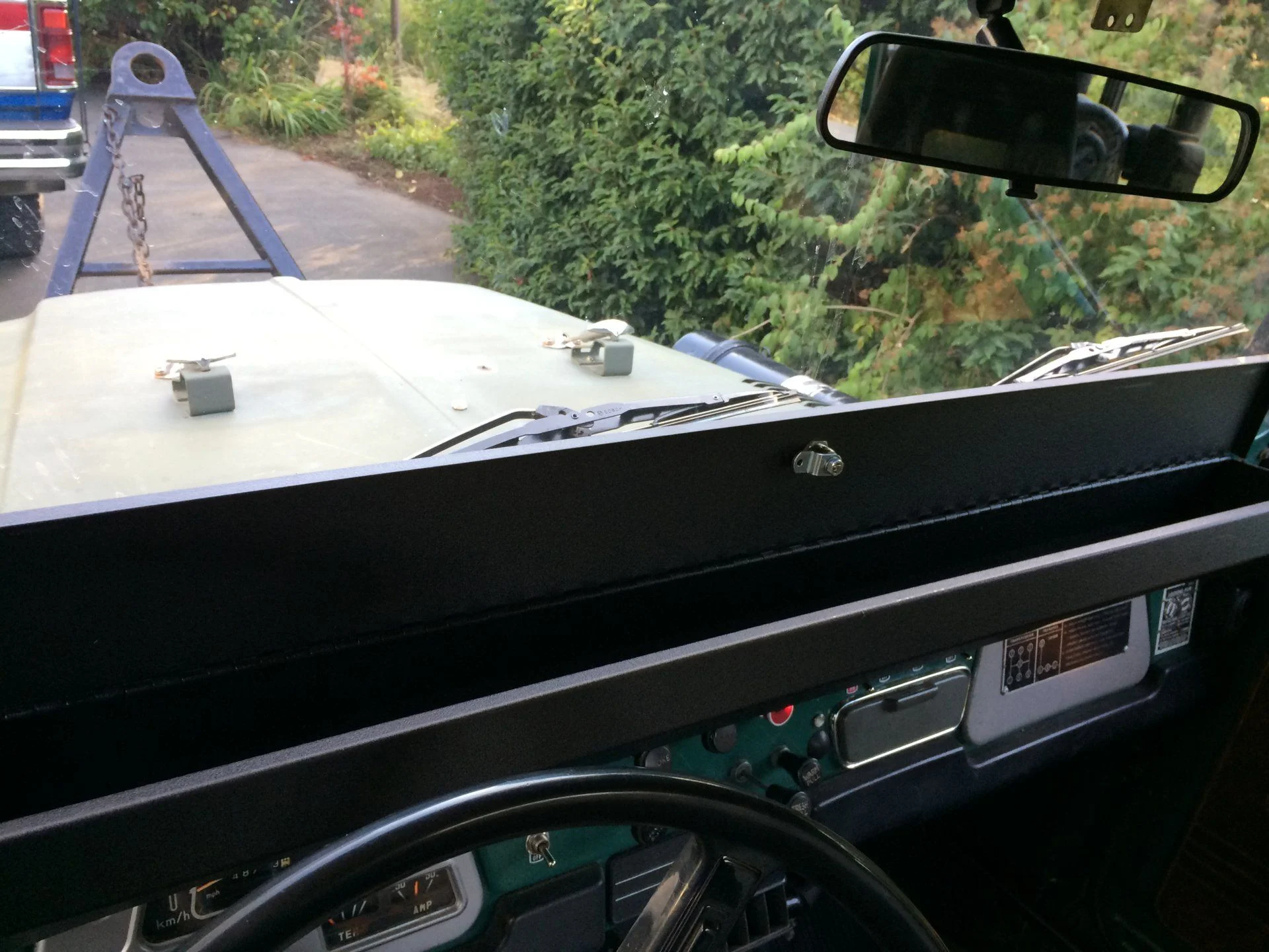

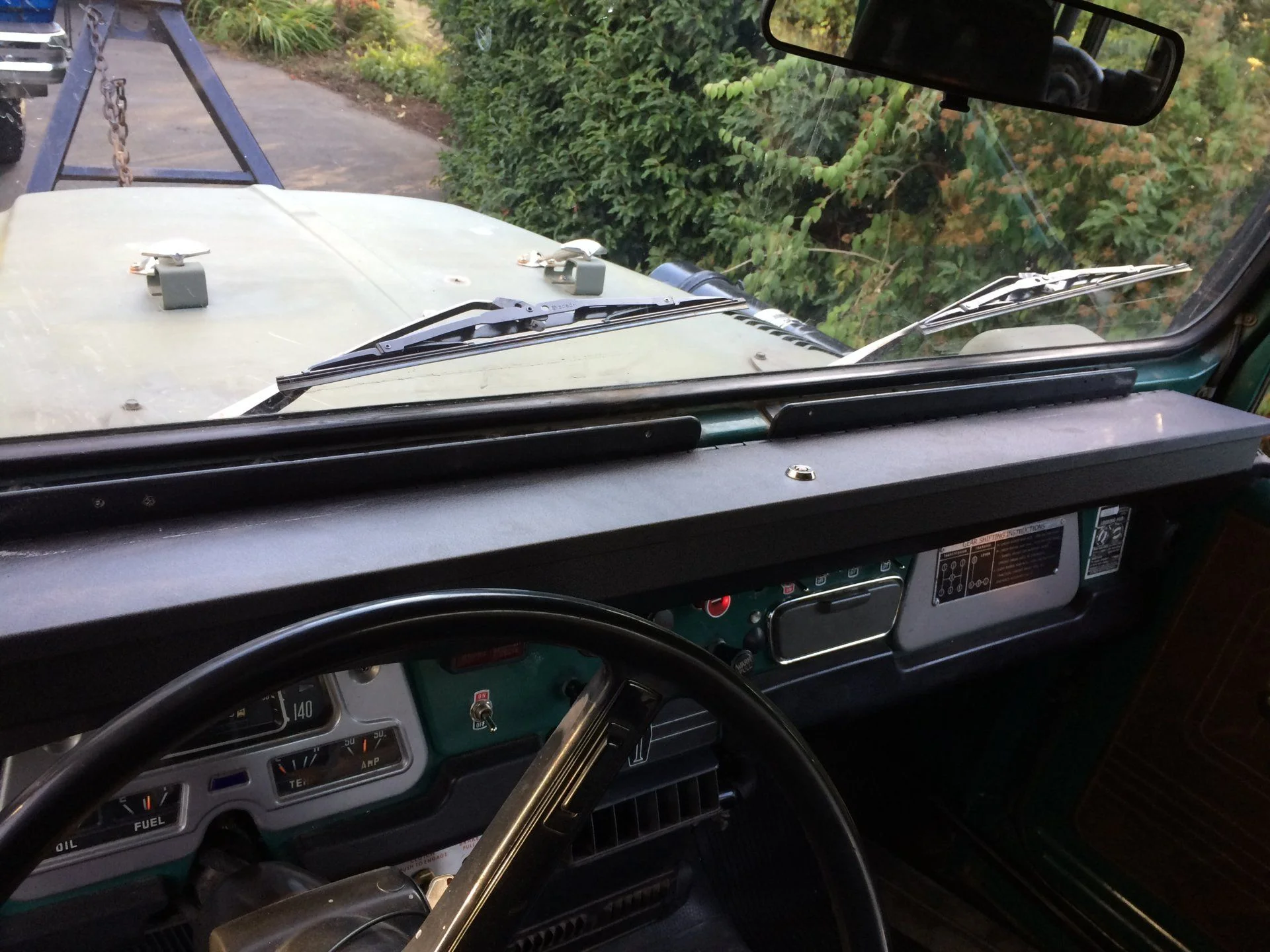

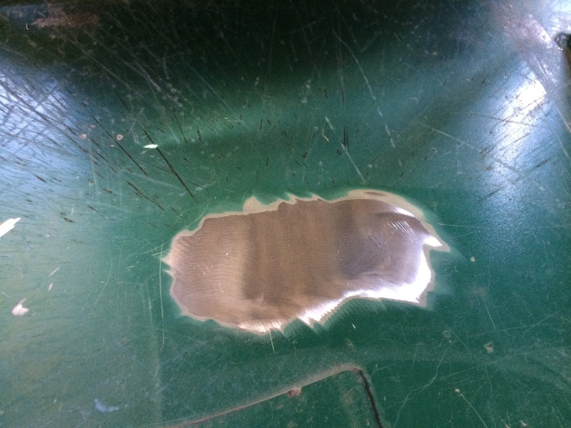

Ok. been a while but time for an update, since I'm snowed in anyway. Insulated the underside of the tent floor. Rattles a lot less now and isn't nearly as loud. I also fabricated new attachment points for the tent to the inside of the cruiser. This way we don't need to tie it to the roll cage any more. Installed the dash box I bought off of Specter off road a year ago and has been sitting int he spare room. I was surprised at how well it works. I was unimpressed when I got it but it works really well installed and fits nicely. I also welded up a couple of holes that had been drilled in the tub before I got it. The last owner had, instead of using the the mounts for the fuel tank, just drilled through the floor and bolted it to the inside of the cab. I didn't like that so I mounted it properly when I reinstalled it. I finally got around to welding up the holes.

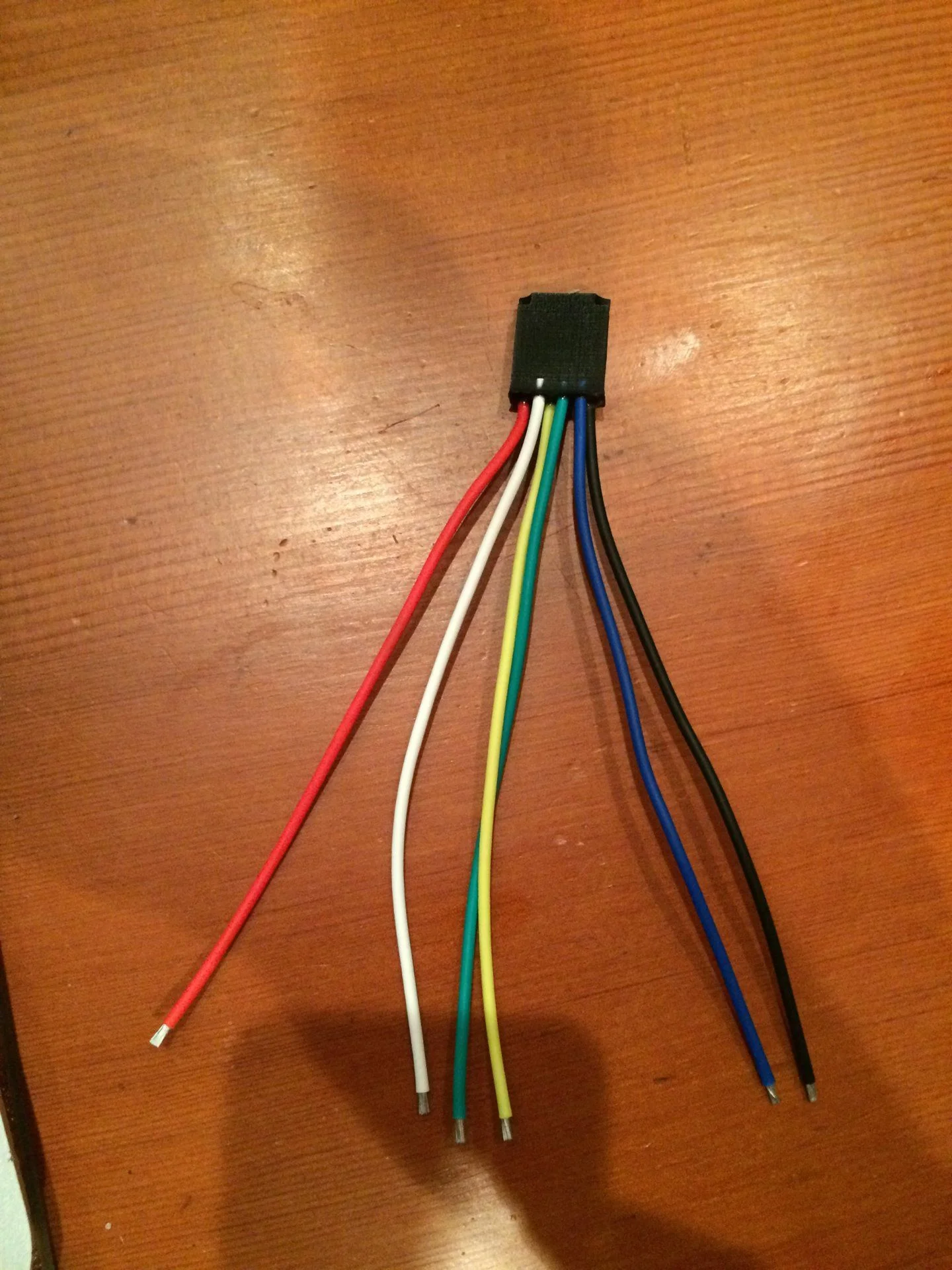

This little gem is a programable relay control. So I can set the time and hit the glow plug button and it will hold them on for whatever time I like. No more holding the dash button down.
