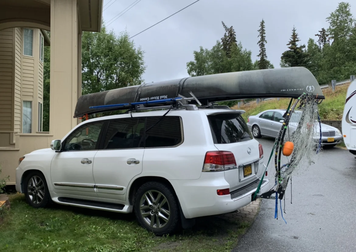

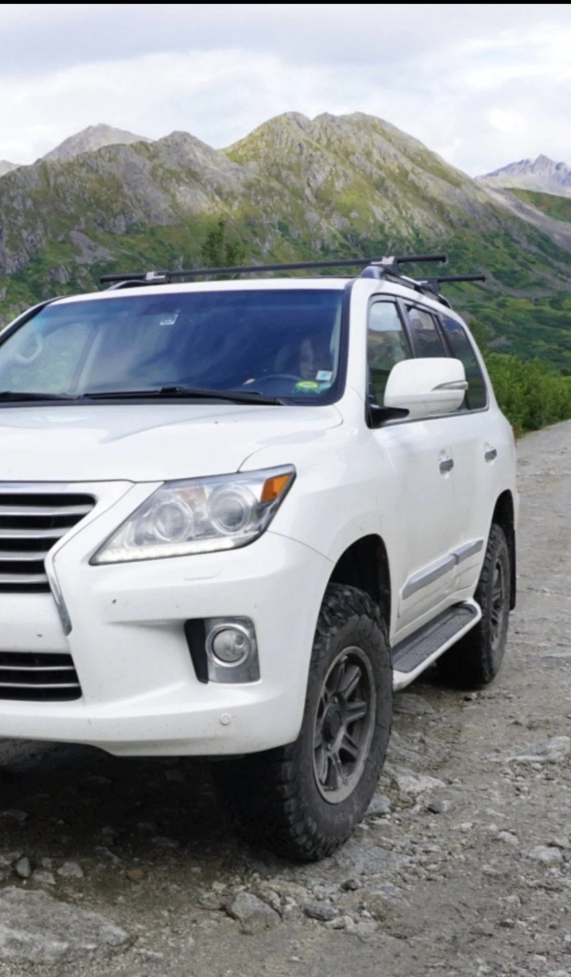

I have Yakama round bars on the OEM rails. Has the original LX rails for 7 years then switched to LC rails ~1.5 years ago. Here are some pics with the canoe and RTT are LX rails, others are LC rails.

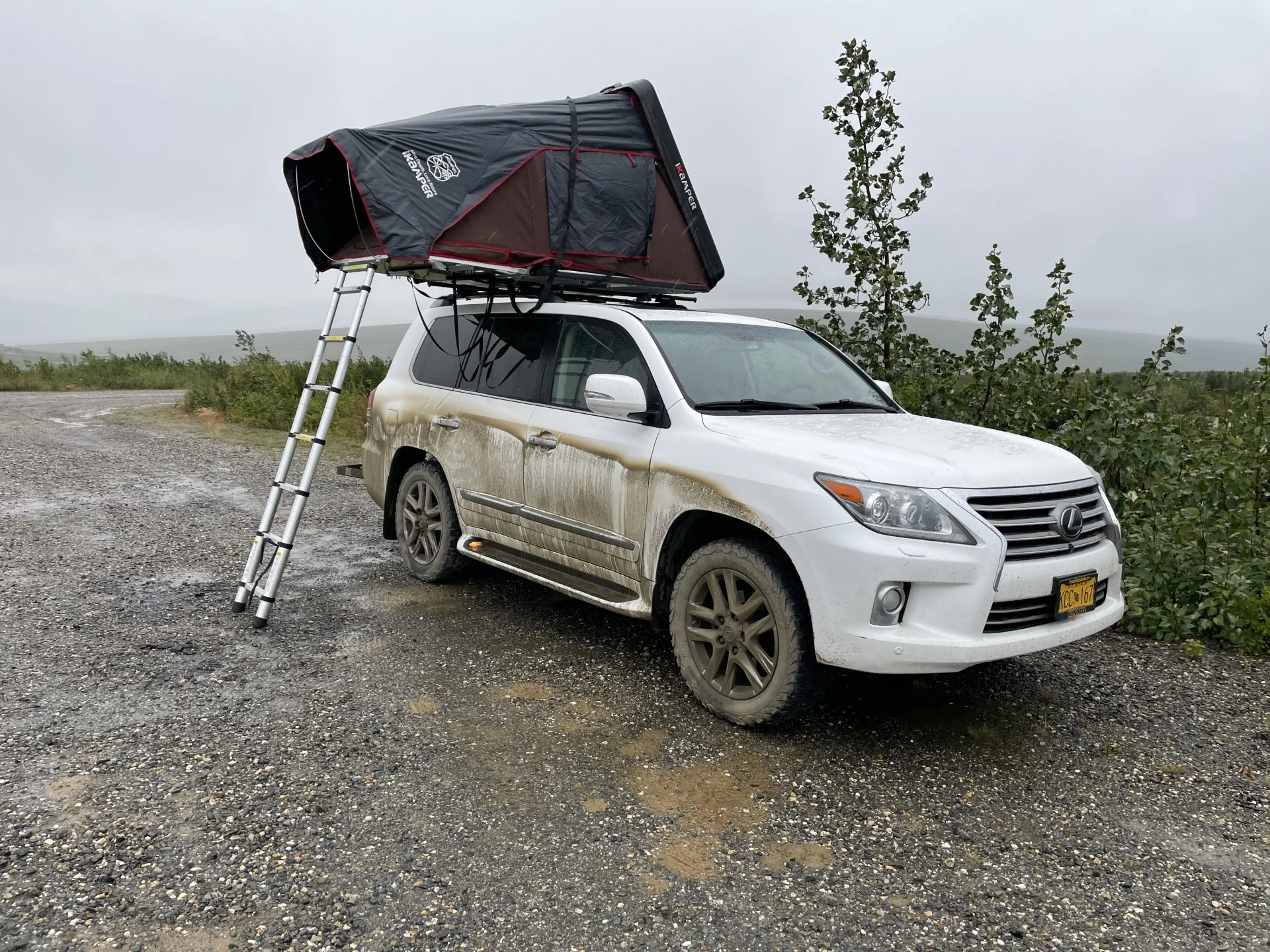

Hey coleAK, with your setup, I see you used the factory LX rack and aftermarket round bars with a RTT. There will be myself (215lbs) possibly another person etc (wife much lighter than I lol), so at least 2 people, plus a small amount of gear. Most other heavy gear witll be in the vehicle.
Naturally this will be a static load, do you feel that with a side entrance RTT like yours that will be okay for the factory rack to handle? I'm assuming YOU use it that way too, or??

We only really use use the RTT late summer when we go up the Dalton way above the Arctic circle into the Brooks range. That trip is 800-1000 miles of gravel/dirt/mud/washboard/potholes,….
Done it now 8 times with an RTT, 7 of those on the OEM LX rails. I mostly switched to the LC rails to give a longer platform for my canoe, that said I wish I had switched sooner.
For weight 3 of us sleep in the RTT (wife hates it and sleeps in the LX if she comes along). me (165 lbs) and my teens (120 lbs) and (150 lbs). So us plus the tent and gear are probably 550-600 lbs.

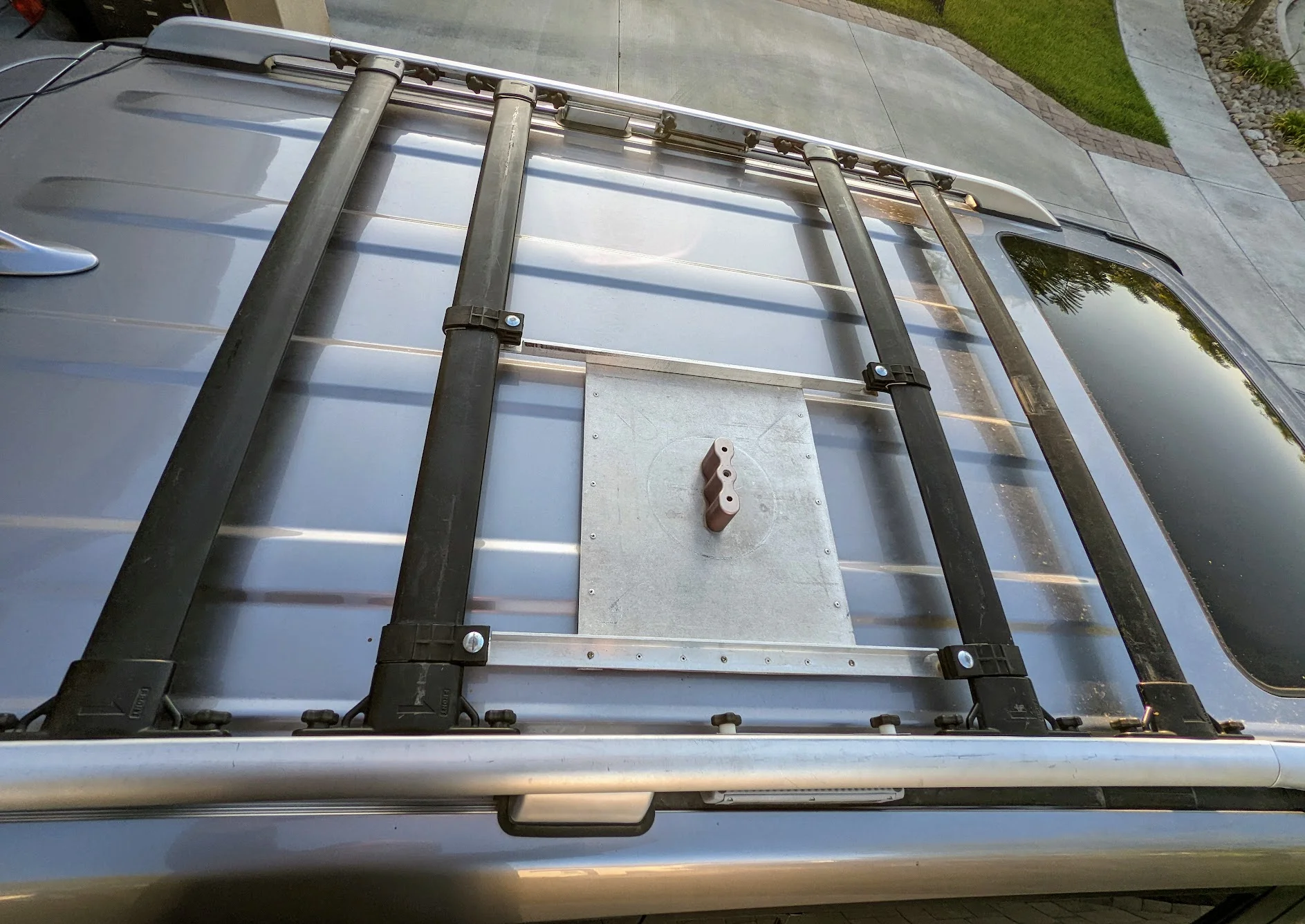

Here's what I'm doing for my RTT at the moment, which is to add another pair to double up cross bars. On an extended LC rack. It's not completely flat which means I have to use spacers on the RTT rail in a couple locations.
