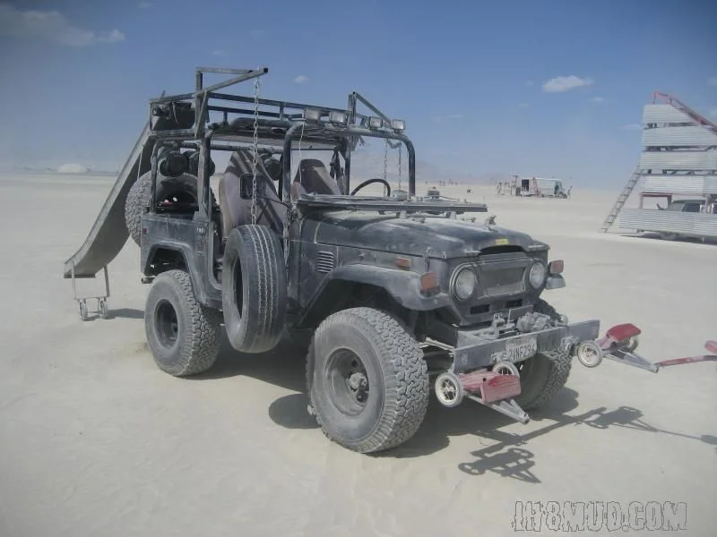

BC40 i have the pictures of the rack on your 40..you send me about 4 via email.i like it,but now a have a 1976 with soft top and i have a wilderness rack 4 " high that i want to install in the next 2 weeks...i like the set up on your hard top..
Good pics. These made me think about dropping the rear supports to use the lower rear door hinge holes instead of the rear bumper. This way the rack might not be subject to the twisting stresses of being partially mounted on the body and the frame. The down side is that the rear door mount holes would give the rack a more narrow support stance than going into the corners of the bumper. What do you guys think.
FYI, I didn't do that hand drawing I posted, just thought the concept looked good. I can't remember who originally posted it but I think there is a similar thread on here that I copied it from.
I do agree that the shorter the bars ie into a bracket that is fastened into the hardtop screw points like in the pics I posted, would be better. Mounting all the way to the bumper or the frame I think you are going to run into some serious problems with flexing.
.....FYI, I didn't do that hand drawing I posted, just thought the concept looked good. I can't remember who originally posted it but I think there is a similar thread on here that I copied it from. .......
I thought the concept looked good also...thats why i drew it;)...I didn't think too much into it...just something I scratched down on paper :)
