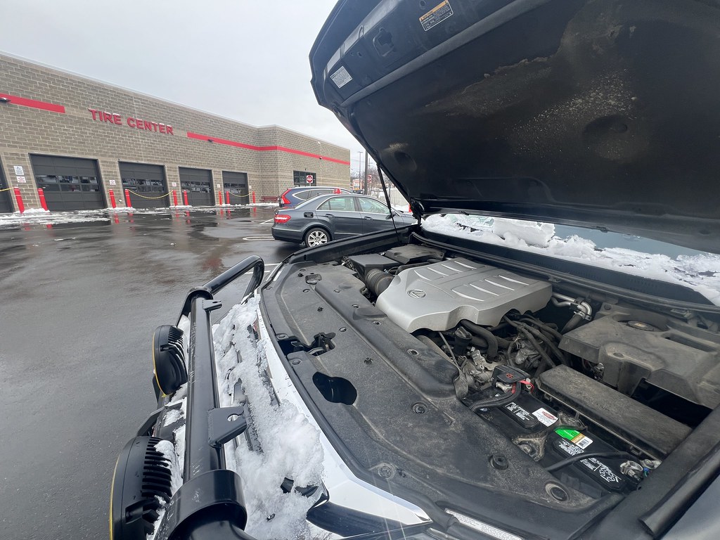

Latest truck update: Battery died so went back to Costco and swapped it for a replacement thanks to their 36 month warranty. Their battery tester confirmed the battery itself was bad (and it wasn't the fault of the GX).

Not hijacking at all-- and I don't disagree, but the affordability and 36 month warranty combo of the Costco battery was unbeatable here in CT when I was looking for a battery at the time in early 2024. I'll eventually revisit getting a better one once this replacement battery dies.

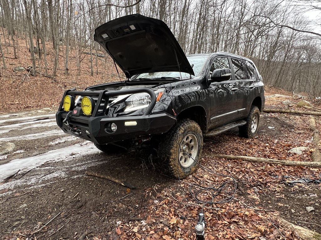

And the most recent pic of the GX on my phone (hood up for compressor hooked to battery)
IMO they look neutered stock, but badass when modded :). There are not many rigs that can transform so easily.
Agreed, the street tires / side steps / low hanging bumpers really street-ify the look. I have since remedied all of that haha
My original plan was to go for an Aussie-esque look, something OEM+ plus or like what you'd see on 4WD 24/7. Haven't strayed too far from that original vision.

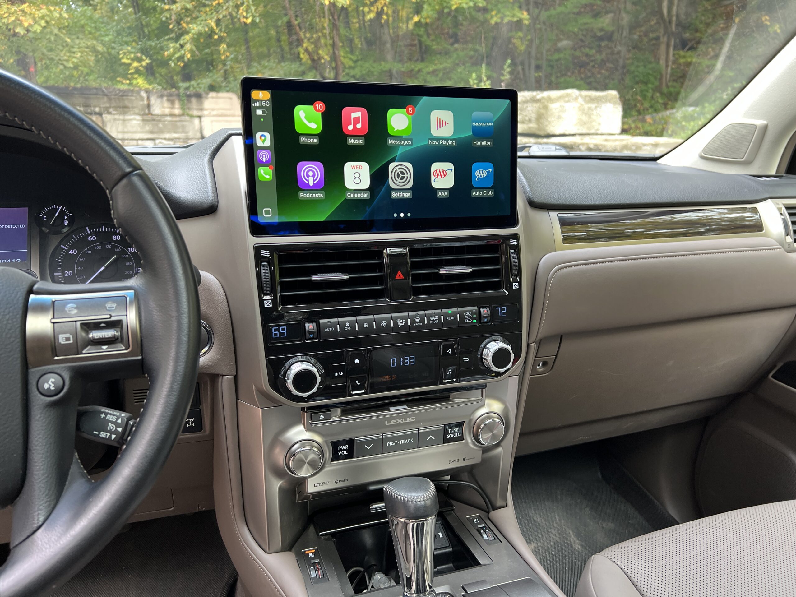

Instead of just being a plug-in CarPlay dongle or even simple screen swap, Hamilton’s Conversion kit is a full center stack replacement for the pre interior-refresh GX460. It comes as one unit that you swap in for the components above the OEM CD player (which stays), and it has a 12-inch screen just like the post-refresh 460. The system has wired and wireless CarPlay and Android Auto, and critically it preserves all factory functions. That means the original microphone, steering wheel controls, backup camera, and factory software are as usable as they are in a stock rig. And most importantly: Real buttons and knobs!

I have no qualms about saying when things don’t work great, or a product doesn’t work as intended, but that’s not the case here. I’ve been using the Hamilton retrofit kit in my GX for four-plus months now and while it’s not perfect– no retrofit kit is, and no new vehicle has perfect tech either for that matter– it’s pretty great. Even the sound quality of the stock speakers seems improved versus with the stock head unit. That could be placebo effect though.
OEM funcitonality
And though the Hamilton’s buttons, knobs, and panel matching aren’t 100% up to Lexus quality standards, the fit and finish are solid. Every install and setup issue I had was easily remedied by Hamilton’s excellent customer support team. Occasionally it won’t connect to my phone automatically, but I don’t doubt that’s the fault of my phone.
OEM functionality is still accessible.
Ultimately, the Hamilton kit delivers on its promise. My 2018 GX460’s stock infotainment and even the Grom VLine2 worked fine and bothered me minimally, but– as I have said countless times– I’m extremely fortunate to drive an array of the latest and greatest cars out there, and that means getting back into my 460 felt like a time capsule– which is a good thing, in some capacities. It’s why I bought it, and why I love how it’s stuck in the year it was conceived in– just the right amount of tech, no more, no less. V8, body on frame, no interfering ADAs, etc. Then again, it sometimes also just feels old, more like the 2010 model year vehicle the GX460 was introduced as. That old foundation is still there, but the Hamilton kit makes the livability of the truck in modern times that much better.
Needless to say, I’m extremely impressed with the Hamilton conversion kit and so far I highly recommend it. I’m not just saying that because they sent it to me at no charge for the purpose of media/marketing. This is a truly great update that makes a pre-interior refresh GX460 feel very much like the later vehicles at a fraction of the price. I love how it has improved the look and functionality of my GX’s interior, and only “those who know, know” will notice it’s not OEM. Well done, Hamilton.
