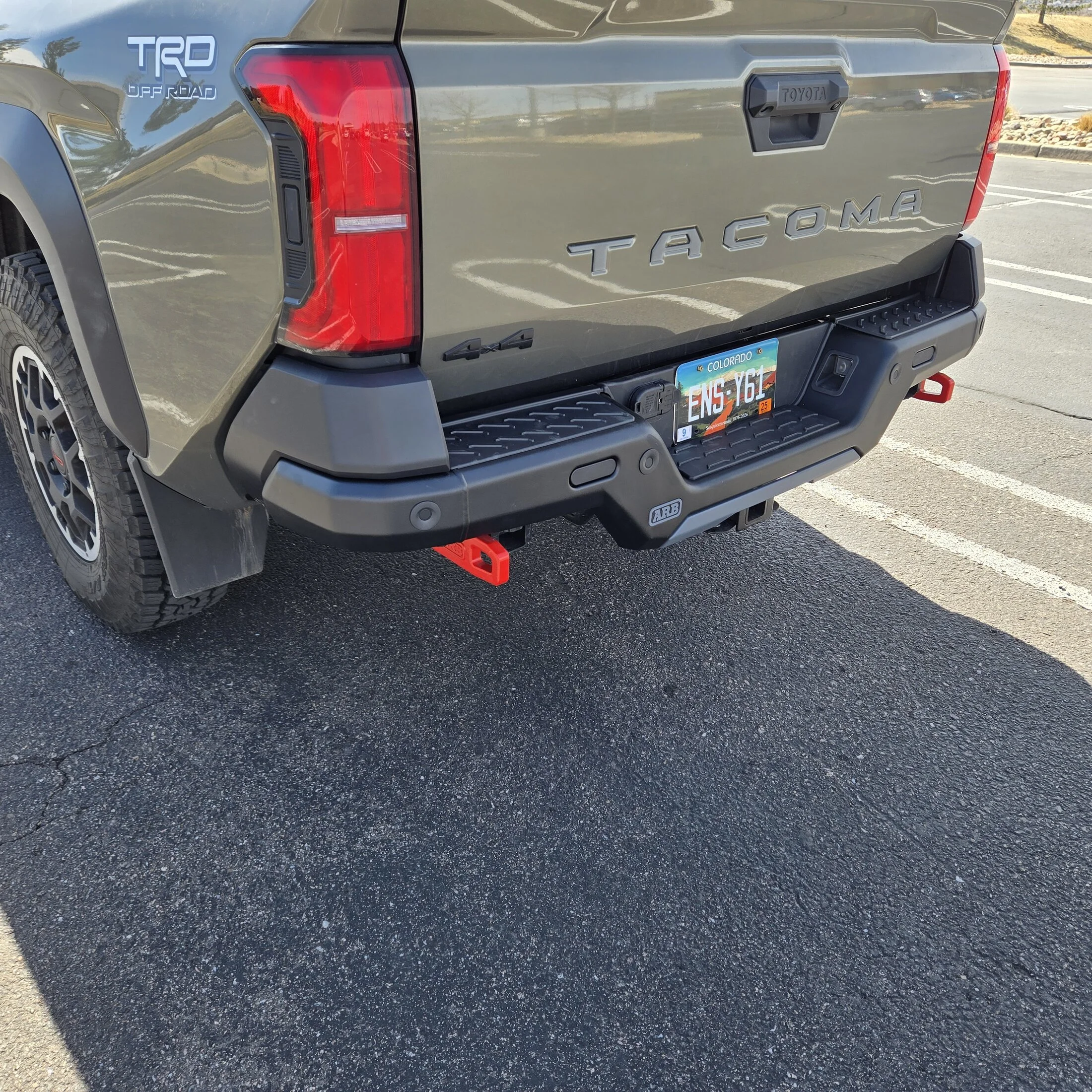

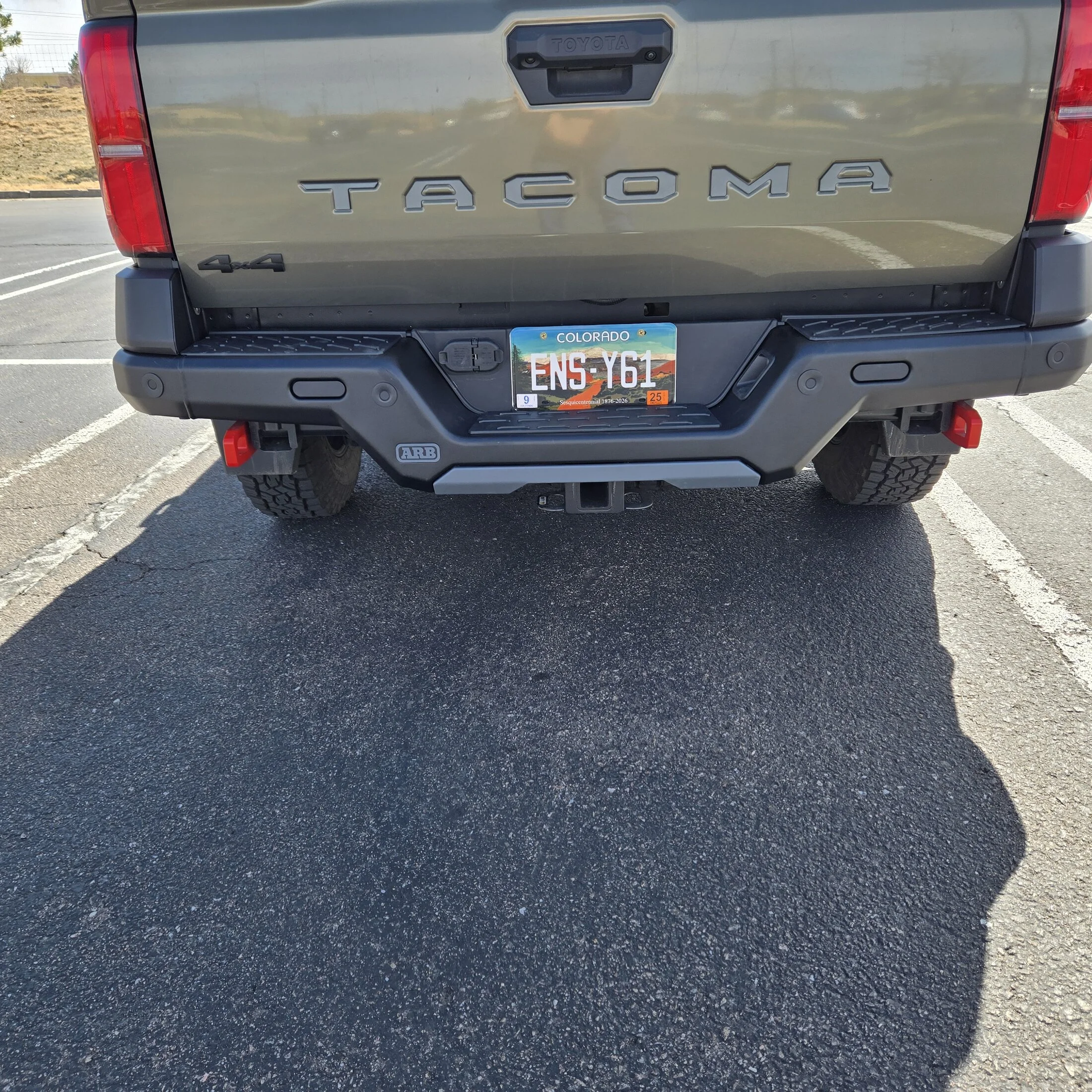

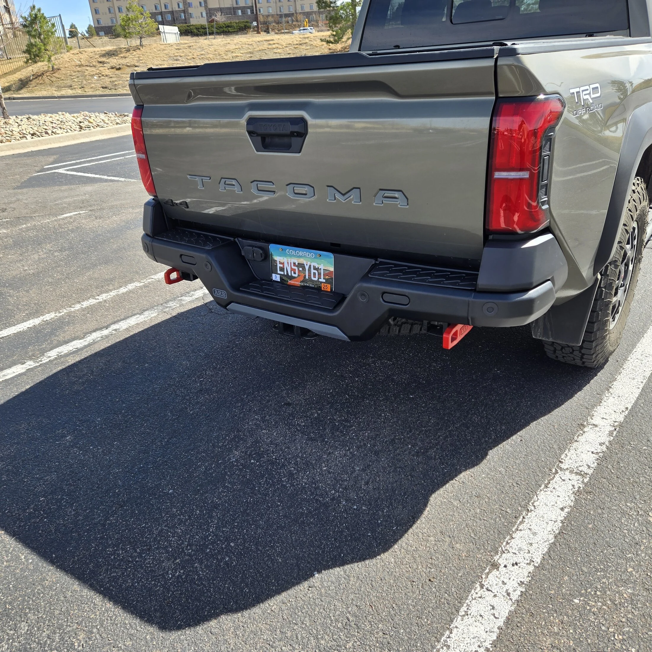

I installed an ARB Rear Bumper on my Tacoma
No instructions come in the box. Fortunately when I ordered it I was able to get a PDF file from the Toyota (attached)
The instructions say you need to order a new wire harness from Toyota, which I did. The clips and retainers are all layed out to the ARB design.
The bumper comes with 4 new Sonar sensors. You do reuse your Blind Spot Monitor sensors (Corner sensors above bumper)
The only issue I had was after I was done, the Parking assist was disabled for front and rear. Everything else going through the harness seems to work; lights and Blind Mode sensors
The instructions tell the tech to perform a Parking sesnor calibration and I don't have that capability.
Searching the internet I didn't find anything about my issue. I asked a person on here if the shop who installed his bumper recalibrated the sensors and he told me that they sent it to the dealer to register and calibrate them.
I reached out to the Toyota Dealer I bought the bumper from and he confirmed with the lead service tech that the system goes into open loop until they program them.
I will be taking it to the dealer on Tuesday to have that done.
I had two questions before I ordered it
1) Will the bumper be heavy enough to cause any droop on the rear? The answer is no, it measured the same before and after
2) Do I need to order the new harness? I likely could have made the stock harness and parking sensors work, but I didnt try
The other aftermarket rear bumpers reuse the existing sensors and harness and likely could have done that here. I did remove the stock harness and sensors from the old bumper in case I need them for troubleshooting. I could plug the 4 old sensors in and connect it to the truck to see if the parking sensors work again, but will follow through on the Toyota Calibration

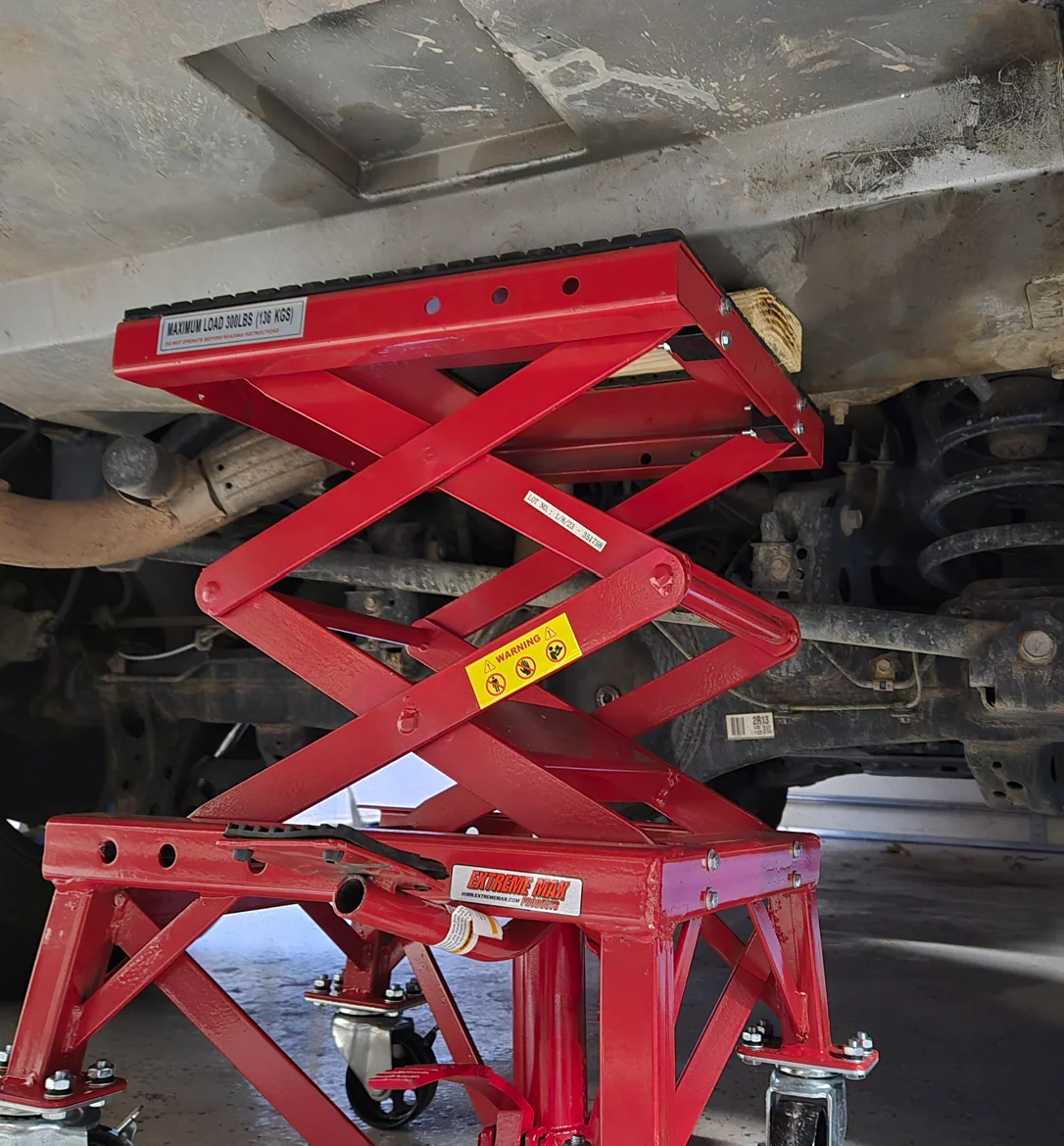

One other note, I bought this stand on Amazon to remove and replace an Aux fuel tank in my Land Cruiser (pictured). Once the bumper was complete on my work bench, I transfred it to this stand and worked it into place. It made it easy for one person to install it
Very happy with the robustness of the design. I wish I knew ahead of time using the new sensors required calibration as I may have played with the old sensors before fully assembling the bumper. Not sure if they would have fit and stock has different sensors center vs outer. The ARB 4 sensors are all the same and the same as the stock center ones. I am sure I will be happy in the end to have used the new sensors and harness :)

ARB Rear Bumper PT989-3524B
The wire harnness depends on your truck. Those part numbers are in the install manual posted above
Two dealers wanted almost $600 to Calibrate the sensors on the ARB Rear Bumper
So I went another path that does not require calibration.
The ARB Bumper comes with all new sensors, all 4 the same part number
The stock bumper uses the same sensors in the center, but different at the ends
The Parking Assist feature is off because it does not recognize the new sensors or at least the two at the ends that are different part numbers at least that is my theory.
I took the bumper off and partially disassembled so I could swap the sensors with the stock ones in the stock locations.
Now everything works as it should. If there is a difference in the sensitivity or angle detection, I can’t tell the difference from the drivers seat
The bottom line is for these Rear ARB bumpers, if you use the set of new sensors, Calibration is required or it won’t work. If you use the stock sensors, then the systems all work fine.

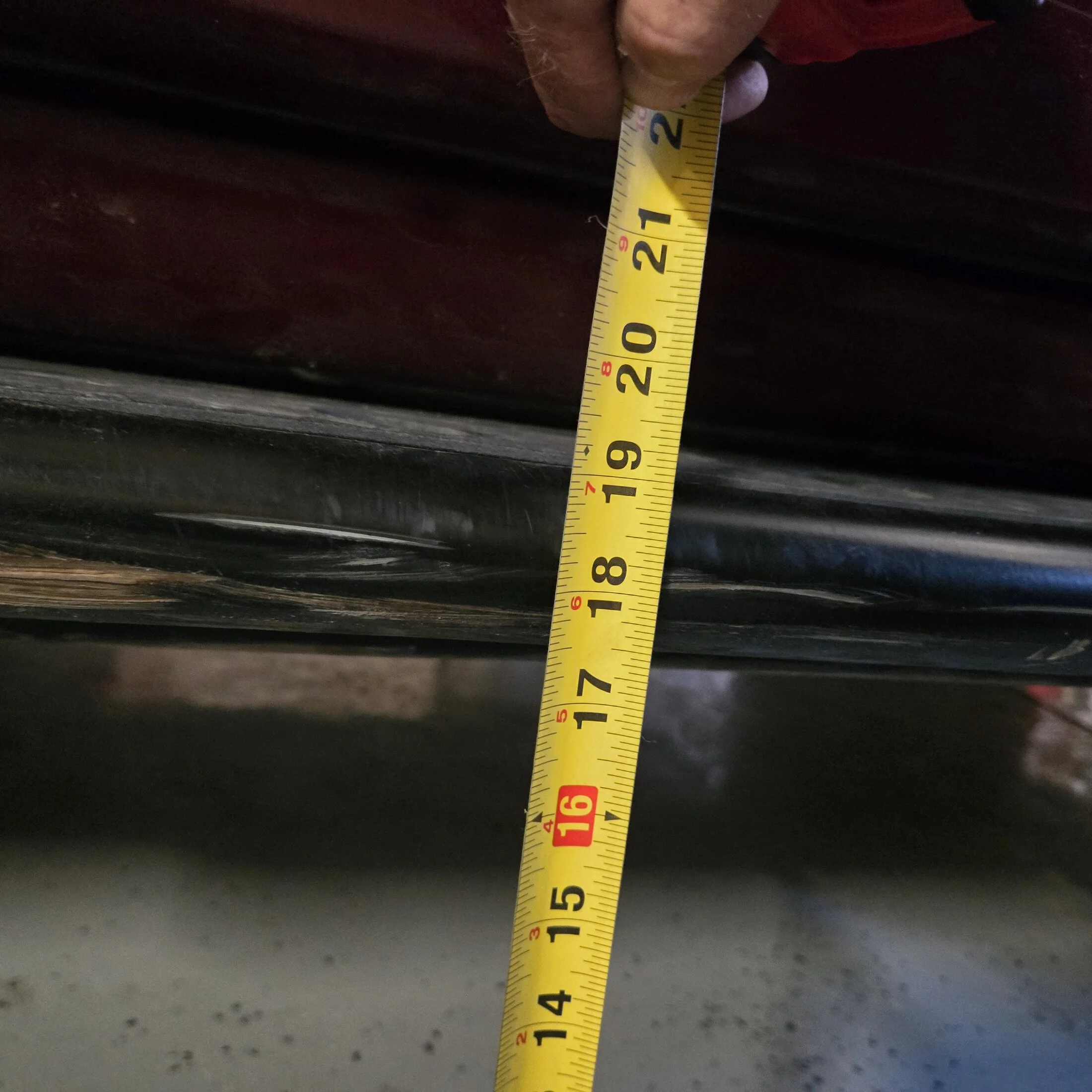

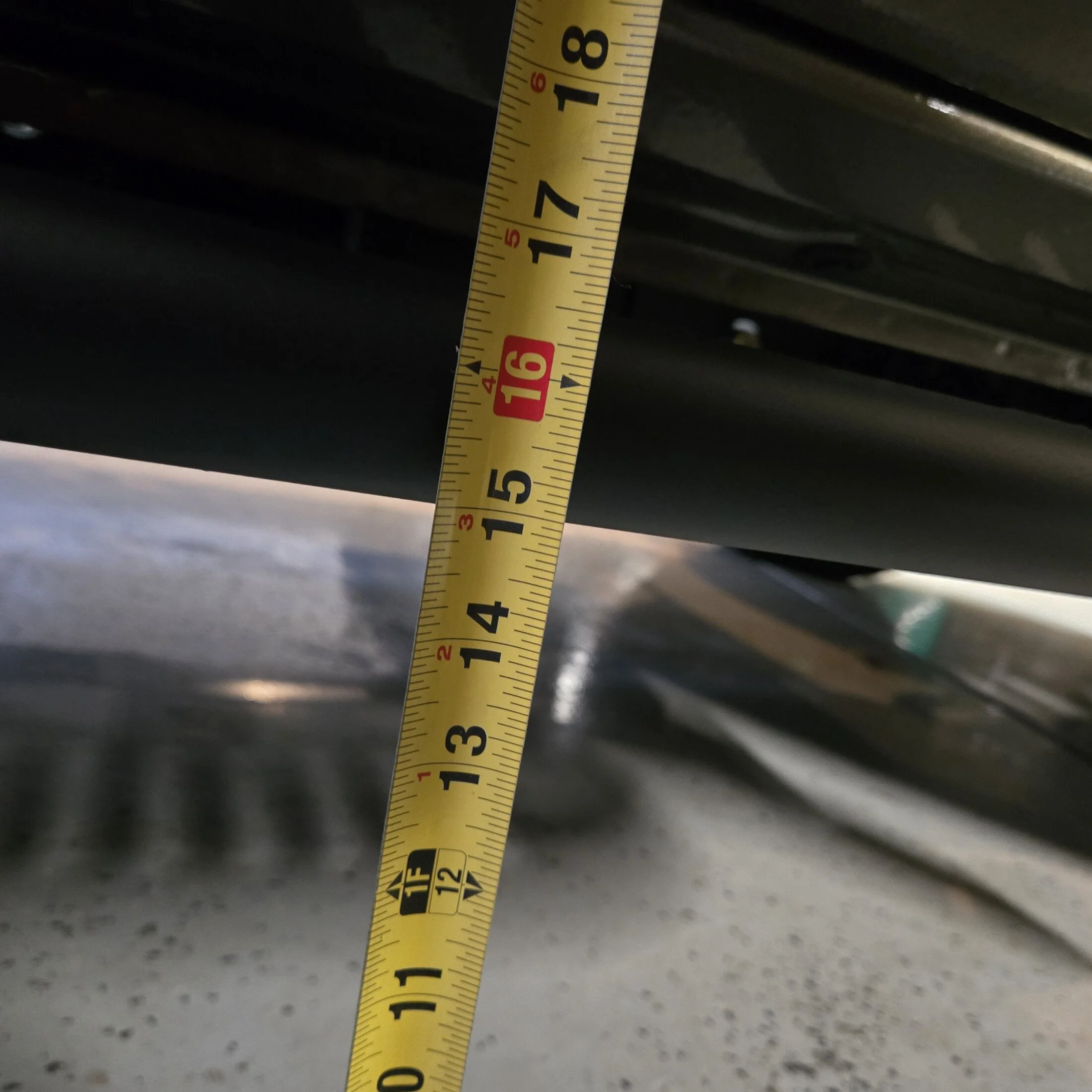

I compared the clearance height to my 200
200
Taco - Stock Off Roaad Suspension

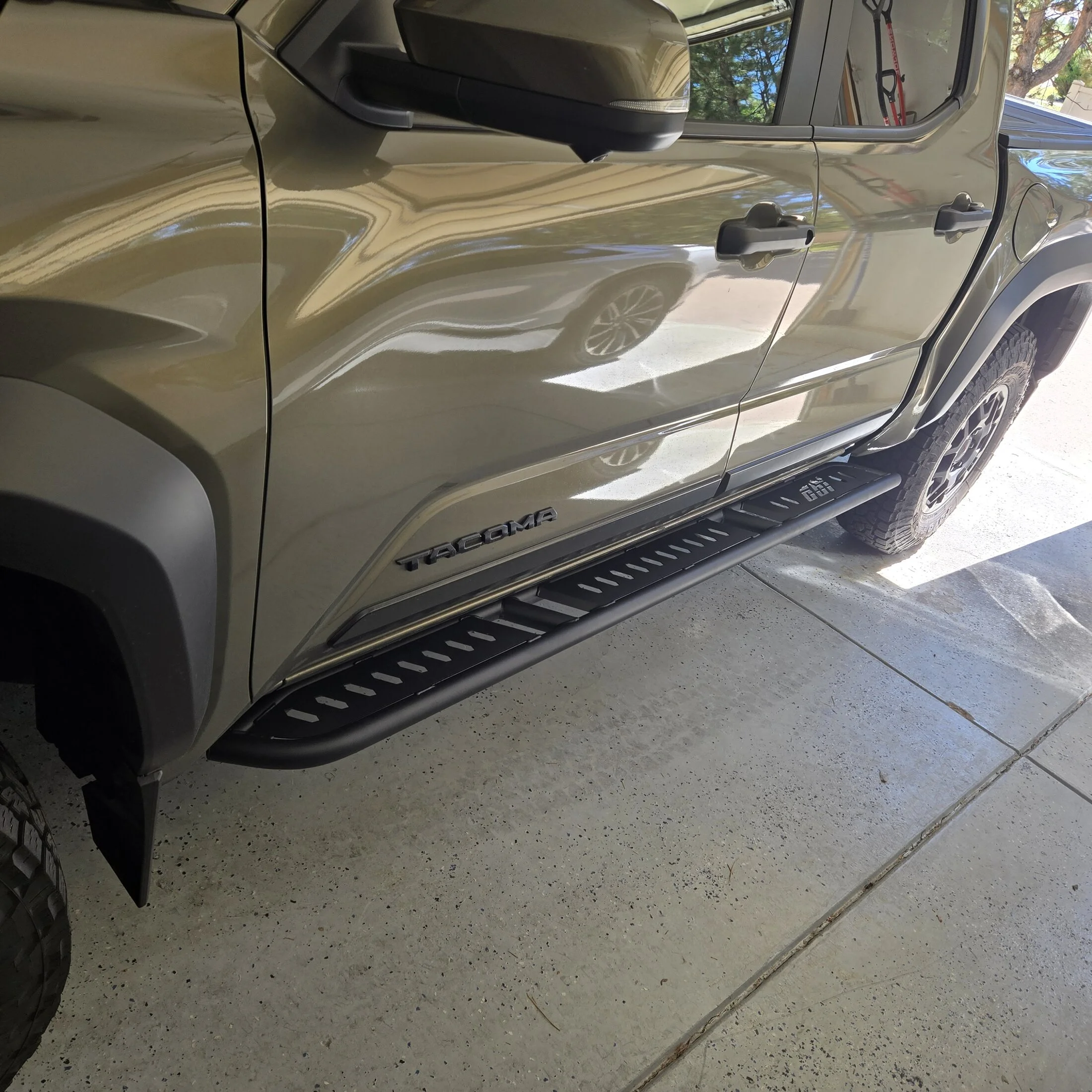

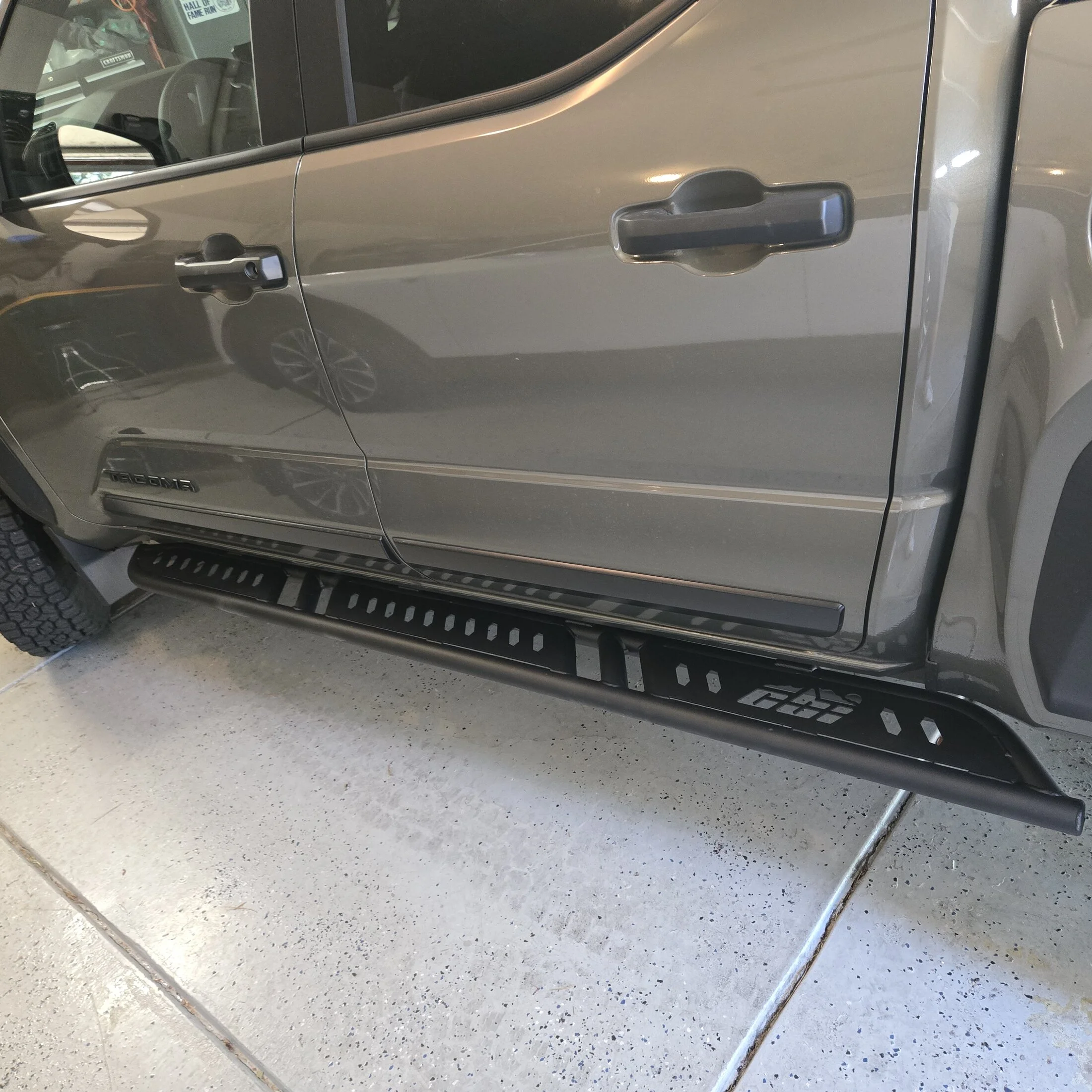

My new Offroad is coming with aluminum steps which I don't want so I started Googling sliders and Slee and Dissent don't have anything yet and I started leaning CBI. I was about to post a general slider question to see who's done what but decided to check Ken's build thread first....
I think I will go CBI. @Romer did you consider kickouts at all? I'd like to see a pic before I ordered though. Also did you go DOM or HREW?
I looked over all that were out there and picked CBI DOM Overland Bolt on sliders. I guess somee of those had kick outs,never been a big fan. No reason just preference.

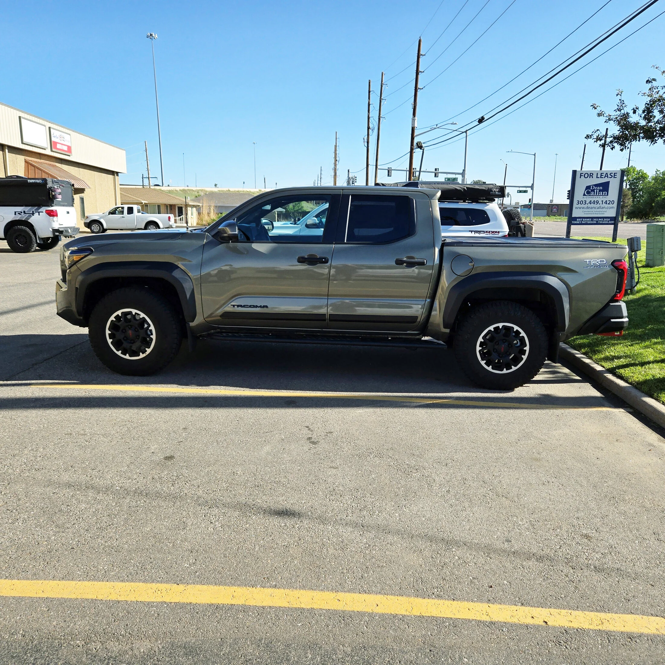

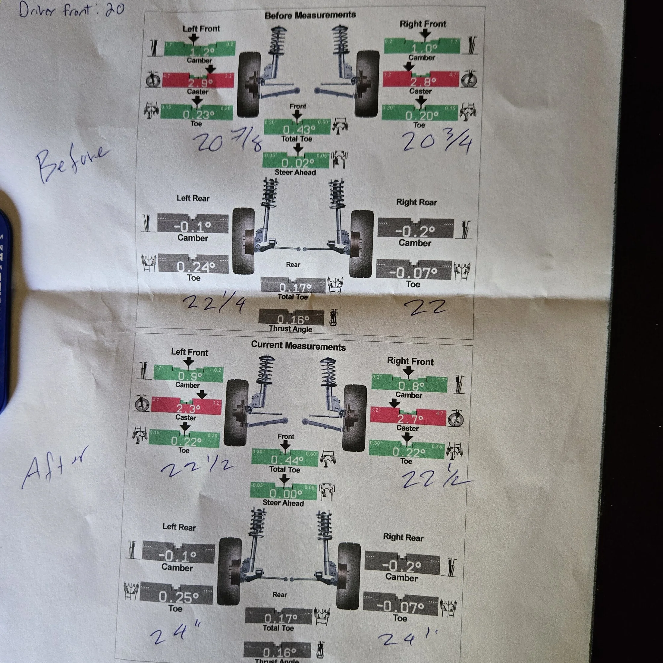

I just added the Alldogs springs
I did not want to spend thousands of dollars on a new lift. I liked these because they allowed me to lift my truck without changing control arms or shocks.
Before
After
Before and After alignment and lift deltas

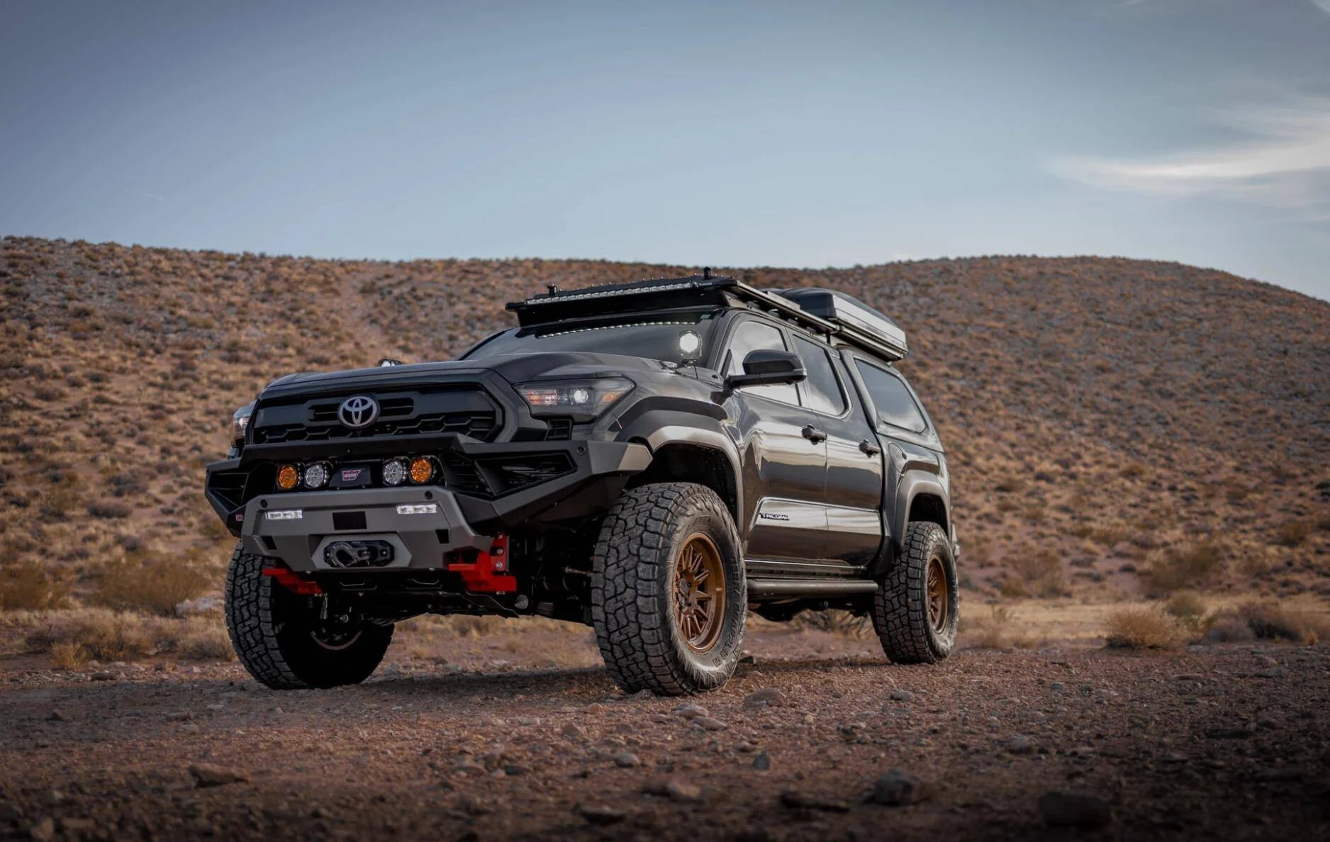

Let’s talk Front Bumpers
I noticed there are very few full width bumpers like a bull bar even without the bar for the Tacoma.
I had an ARB Front Bumper on pre-order, but may cancel.
There are lots of front bumpers that only replace the middle section.
I did not see a lot of value in these so I asked R4T what is the advantage of these. Primarily recovery points and housing a winch along with some front end protection
I am use to the full width bumpers that provide better clearance and protection. They have provided clearance to me on my Land Cruisers to come at an incline at an angle and walk one tire up and then the 2nd would catch.

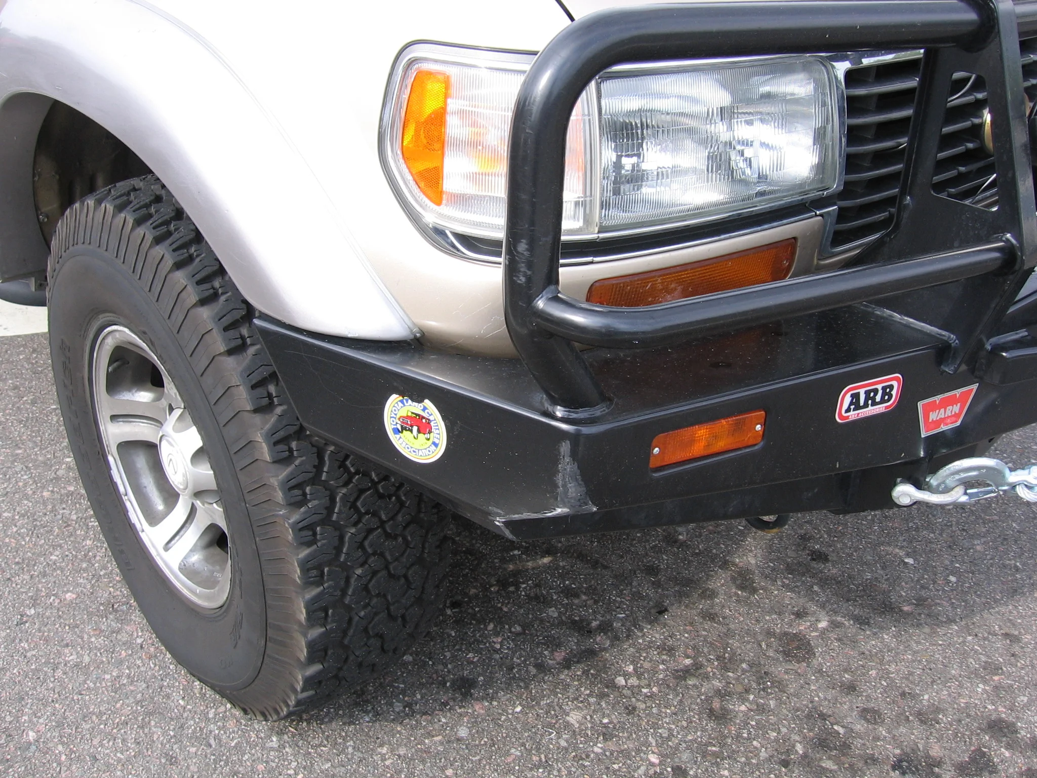

I have an ARB on my 80. Living in SC Kansas, I have had several close calls with Deer, particularly in the fall. I am very comfortable having my ARB on the front, knowing it will minimize any damage to the front of my Cruiser the next time a deer zigs when I am slow to zag. Like you mentioned, I also have a full width ARB on my Wrangler which got backed into by a DUI in a Leadville gas station while wheeling the trails. Minor scratches to the LF corner, extensive damage to the drunk's car + a trip to jail for him. I may purchase a new Cruiser in the next year, and a full width bumper, ARB or a couple others, are certainly on my mods list, due to the above reasons. Nice Tacoma btw.
