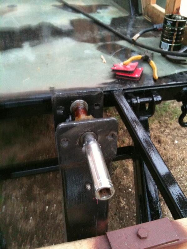

Now it's looking like those wonderful renderings! It's definitely come a long way and it's looking good. The crank for the tongue jack, is it going to have an opening in the nose box for the crank to stick out? Or are there other plans on how to handle that?

Yep..the plan is to cut off the handle and replace (weld) on some sort of fittting to accomodate a crank handle, or the same one as far as that goes. I actually have an old Dewalt rechargable drill I could use, then retrofit all three jacks with the same fitting, but I think the handle would be more reliable.
UPDATE: Welded a 1/2" deep well socket on tonight, fit perfect with the 3/8''s drive end sticking out...this will be a SSSSSSSSCCCCCCCCCCCCCCCCCCCCCCCCCCCCOOOOOOOOOOOOOOOOOOOOOOOOOOOOOOOOOOOOOOOOOOOOOOOOOOOOOOOOOOOOOOOOOOOOOOOOOOOOOOOOOOOOOOOOOOOOOOOOOOOOOOOOOOOOOOOOOOOOOOOOOOOOOOOOOOOOOOOOOOOOOOOOOOOOOOOOOOOOOOOOOOOOOOOOOOOOOOOOOOOOOOOOOOOOOOOOOOOOOOOOOOOOOOOOOOOORRRRRRRRRRRRRRRRRRRRRRRRRRRRRRRRRRRRRRRRRRRRRRRRRRRRRRRRRRRRRRRRRRRRRRRRRRRRRRRRRRRRRRRRRRRRRRRRRRRRRRRRRRRRRRRRRRRRRREEEEEEEEEEEEEEEEEEEEEEEEEEEEEEEEEEEEEEEEEEEEEEEEEEEEEEEEEEEEEEEEEEEEEEEEEEEEEEEEEEEEEEEEEEEEEEEEE

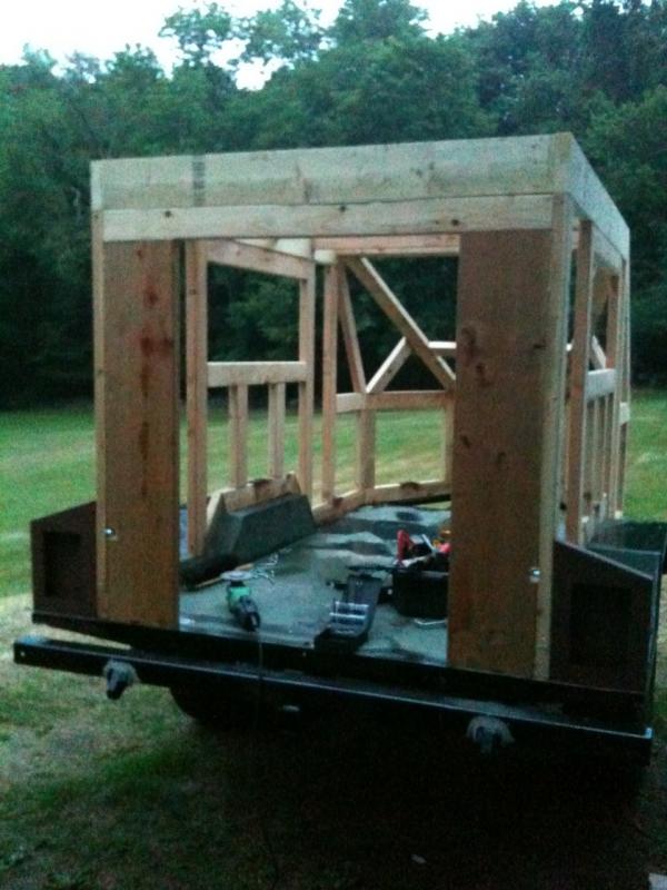

Anyways, while we're on the subject of overbuilding, the outside will get covered in 1/2" CDX , glued and screwed of course..with a layer of FRP panel contact cemented on that. There will be a set of double doors on the back
The inside will be be insulated with a layer of 1-1/2" blue foam, them some oak wainscoating over it and some light trimming..maybe some curtains and a wine rack?...nothing anal about that is there?:cheers:
Got the back doors framed in tonight and some brackets welded at the bottom so I can carraige bolt them

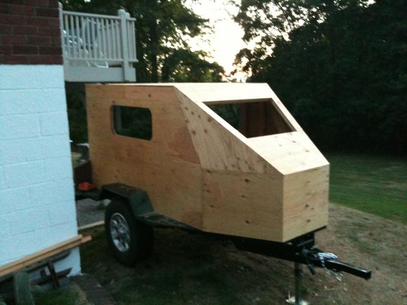

Anywho, got the sheeting and blocking all glued and screwed. I decided about 3 this afternoon that I seriously need professional help...in the head that is...
Any kook that would design those angles and purposely subject themselves to that kind of aggrevation on a 90 plus degree day should be on medication and commited...
Tomorrow night I have to plug and sand the roof plywood and hopefully get the rubber glued down. Looking forward to getting it water tight. The FRP is here and under the porch, so that'll be after the roof goes down.
A few more outside...
I suppose at some point I should drag out a real camera...but I think everyone gets the idea

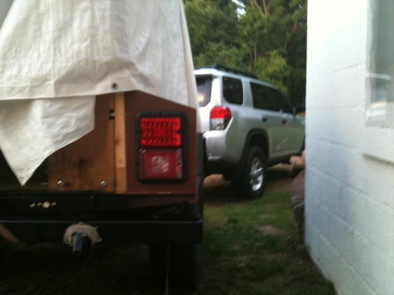

In anticipation of going down to get it weighed...i hooked up the lights tonight. I ran the 7 wire harness into a junction box at the rear of the trailer...what a dream!! I got the all lights, 7 wire, brake controller, and a whole bunch of other goodies from Paul over at R and P Carriages Trailer Sales over at Ebay...big thanks and a shameless plug for Paul and Robin..their great prices...and super fast shipping :cheers:
I used the Bargman combo stop, tail, and backup...I think they really pick up the look of the 4Runner tail lights...and holy friggin cow are they BRIGHT!!
I'll try to get a pic of the juction box in the daylight.....only way to go.

So, color me blonde cuz I'm just looking at the pix right now (as All Mudders do on first glance!), but will you really have to crawl into the nose of the thing to lift the jack?
Wait, I think I remember a hatch coming..... ??

Check out post #62...you'll see I welded a socket on with the 3/8's drive end sticking out, that allows several options in which to raise or lower the nose gear.
See pic
As far as the weight..the roof has to be able to support 600-700 lbs. of people, tent and rack, so if i'ts a bit overbuilt, I'll be able to rest in comfort knowing I won't end up on the ground from 7.5 feet up :p As far as lateral and sheer forces...I'm no engineer, but the construction adresses any forces that may negitively impact the rigidity. The back door is the weakpoint, it has 2" x 2" x 1/4" angle welded to floor and carraige bolted thru the bottom of the uprights...and a foot further up from that the framing is anchored to the taillight brackets that are welded to 1/8" metal deck.
Sure, I could have used maybe 2 x 2 's and 3/8"s plywood, and maybe it would've been ok....but for the extra 100-150 lbs in material, I say have a ball and enjoy some peace of mind.
