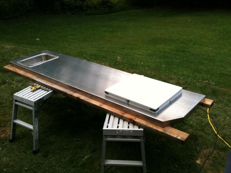

I did lay out the kitchen aluminum today. I've switched gears a bit and decided to hinge the aluminum sheet to the side of the trailer. I have a sheet of 1/8" to be cut and have a 2" lip bent on it. There will be 2 holes cut in it, one for the sink and one for the stove. I'm just not sure how I want to support it, either legs up from the trailer...or cables down from the side. It'll fold up and be secured to side in transit. When you get where your going...drop the top, hook up the gas and sink....and you have a kitchen, and a very spacious counter for prep!

Working on the kitchen, aluminum is bent, just fished dry fitting the sink and stove. Now it's gotta get mounted on the side...of course that intoduces a litany of issues, all which consume one thing...time!
The plan is to piano hinge the work top to the side, and I really don't want anything going to ground or underneth, so it looks like it will "hang" off the side, 90 degrees to the trailer side. Also in the mix is some extra support on the bottom...i want it solid.

The finished top is 92" x 21"...got lots and lots of prep area for beer...umm..I mean "food prep"..yeaaa..food prep.....:lol:
Wow Pat thats a really cool stove and sink :D
