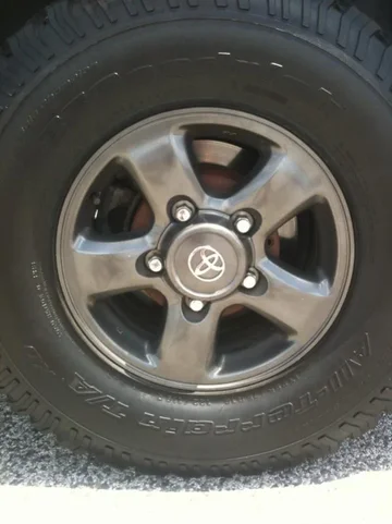

Here is mine after 1.5 years and maybe 30k miles...
Duplicolor graphite and still look good IMHO.

Thanks for the pics, Copenhagen1, the finish looks a little ueven in the photo, is that just the picture of is it wearing a bit? They still lookd great.
No. That is just the lighting. I think the wheels look 90+% as good as when I did them. There are some small chips from rocks but I am very pleased how they are holding up.
