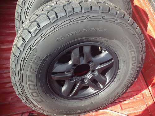

Here are some pics of the project. (I used Duplicolor Mazda Graphite)
Tools/products used
OEM wheels
After one pass of the brush-on paint stripper
Ready for new primer/paint
Completed wheel (I did not sand in between coats but I loved the end-result)
Wheels looked a little dark in the garage but came into their own in sunlight
Daylight

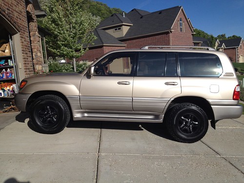

I decided to go with powder coat for durability. The powder coating company recommended semi-gloss with a little texture to hide any scratches. They also had a textured Rustoliem paint that matched exactly for the center caps. I will post more pictures of them on the truck when I have the "status" to allow it. I really like how it turned out.
here is the pic.
<a href="http://www.flickr.com/photos/80160582@N07/7349157748/" title="LX wheels and tires by dirkkeyes, on Flickr"><img src="http://farm8.staticflickr.com/7216/7349157748_1ff5a74eac.jpg" width="500" height="375" alt="LX wheels and tires"></a>
Wheel look better than I expected on the gold truck! Now, let's talk about those tires!?
