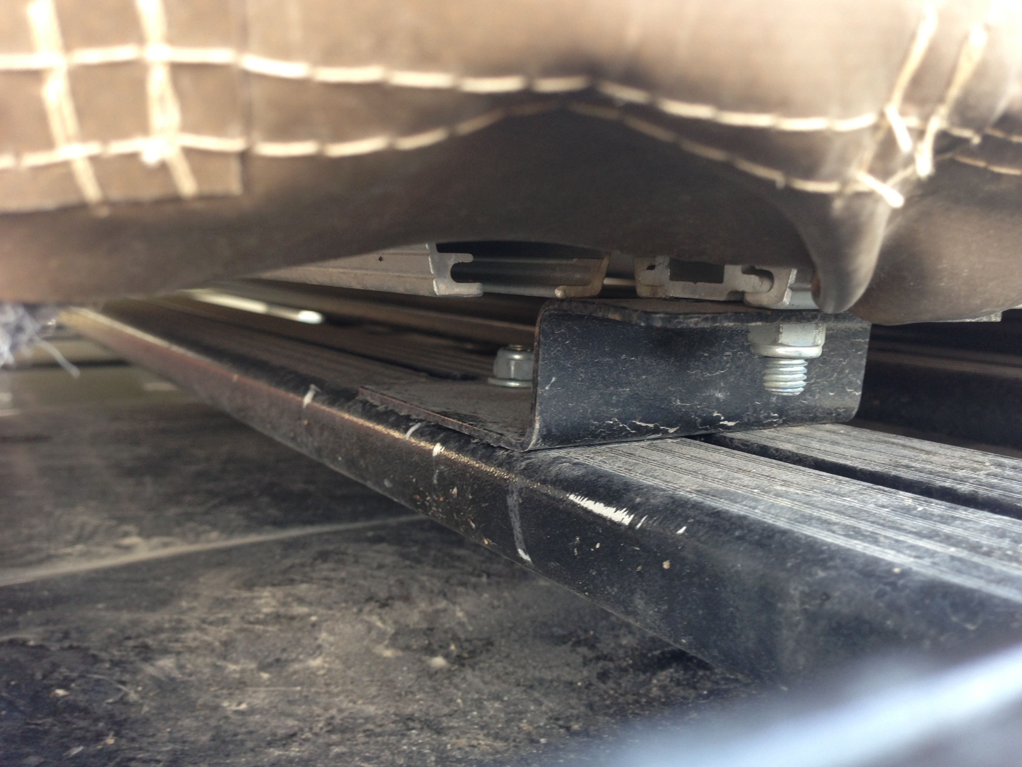

Does anyone have a photo of how a RTT exactly attaches to the front runner roof rack. (I got Tepui tent) and will need to do the install next week.
May not be the same on the Tepui, but here's how the Eezi-Awn mounts using the Front Runner tent mounting kit. Very simple bracket. For each mounting bracket there are two bolts to the rack, one to the tent rail.
Tepui has the same long aluminum rails but it seems like you connected it to something else?
I will order the mounting kit. Either way I will bolt down that thing somehow lol
Mine is connected to the aluminum rails as well. There are rails going both directions. In the picture, the bolt is going through the rail that is perpendicular to the rack cross bar. This way I could make back and forth adjustments with just one bolt per mount.

Tepui and most other RTT's using the aluminum channel can easily bolt to our rack using our tent mount brackets. They have a sturdier design now then a previous post, but its basically the same idea. Lifting the tent a little bit makes accessing the mounting bolts much easier. You are also able to remove the entire tent with or without the brackets still attached, making it pretty easy to remove/install in between trips.
