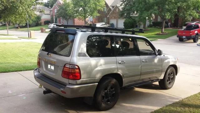

Oh well, it all worked out. I will update some info that consolidates Kiruxa's advice and gives some pointers on how to make it all easy. I bumbled into a few things that made my life easier, like namely assembling the rack itself right off the bat.
The product is solid. Strong, well-engineered and the texture alone is worth $500 alone of the value. I am happy with my purchase decision and I intend to use the rack quite a bit.
1. Spend time prepping the area on your vehicle where you removed your stock rails. If your vehicle is a few years old, there will inevitably be rust and other problems. I don’t recommend taking the approach of waiting until the rack arrives to then remove the stock rails. There will be surprises. And the cleaner the area is before the install, the easier it will be. I underestimated this…
2. Complete the rack assembly first. Layout all of the parts on a big blanket. Warning: There are important nuts that are tucked neatly into the end slats. You want a bolt in there ASAP to keep them from falling out. They are pre-installed, lose one and it will be painful. What really helped the most was I laid out almost every part of the rack on a big flat surface and simply walked around it quickly tightening bolts. The parts fit together well, but there are of course, many parts, so when you lay them out, you only want to move them just a bit, so that you don’t have to move anything else. If you have the space, it will help greatly..
3. Take the rails inside and assemble them in a clean, well-lit area. The adhesive is fine, but it helped that I was able to smooth over any wrinkles on a table. Plus, the rubber seemed greasy..so I cleaned it up.
4. Kiruxa suggested a blanket as you slide the rack on top of the vehicle. I did that, and I also used the cardboard Frontrunner box and set it under the rack as I slid it on the roof.. That helped quite a bit.. Protects the roof and allows you to jockey the rack onto the feet.
5. Here’s the thing that I think would help the most technique wise. One, install the top of the feet on the rack loosely and allow them to slide East/West. Any configuration of alternating slats is fine. For the lower feet that attach to the slide, attach just the square nut and the washer into the grooves before you add the bottom of the feet. Your bolts that hold the rails in place can stick up just a bit and make it difficult to slide the bottom feet. So slide just the washer and the square nut in the rails until they are positioned and THEN install the lower feet and associated bolt. If you’ve positioned the rack on top of a good blanket and card board box, you can then guide the top feet into the lower feet and fasten them accordingly, one entire side at a time.
6. And yes, the configuration of Tall-Short-Short-Tall for the feet length
Tools I would suggest.
1) A box cutter - use this to shave off excess plastic from the rails. There are also a good list of boxes and plastic wrappings. Just getting all of that off is work.
2) 13 mm flexible wratchet. See Kiruxa’s photo- Cant do without this.
3) Hex key set. I used my own for things I wanted done quickly, though some are provided and they help in tight spaces. But they are hard to grip, so your own set helps..
4) WD40=
Good racks don’t come cheap, but the quality and workmanship are clearly evident. The instructions aren’t superb, but the product is worth it, and there should be enough info on this thread to get you there…
Also, the windguard is kinda 'meh'. It's basically a flat piece of metal. If they wanted aerodynamic, they could have done much better than this, and I would have gone with cheaper molded plastic to divert the wind noise.
But it does help to install. My suggestion is to stagger the bolts when you install the wind guard. Connect the inside bolts to Slat #1 and the back end of the wind guard to Slat #2.

BlueOcean; Which gutter mounts do you have with the rack, the tall or the short?
About this noise issue though... I'm wondering about the "leveling" of the frontrunner rack. The front mounts are taller on both versions than the two rear sets to make up for the gutter height slope to the front. BUT the pics on the website show an 80 with a bit of the common "stinkbug" stance, however not all of our rigs have it due to different lift kits, spacers, etc. I would think having a different "attack attitude" or angle might effect wind turbulence differently from one 80 to the next. Perhaps this could partly explain the variable noise problem.
Interesting. I've got the v1 Wind Cheetah Slimline and have the tall feet in the rear / short feet in the front. The rear are almost at the end of the rack. They both adjust so you should be able to "dial it in".

You are absolutely correct. It is very important to find that sweet spot. It almost always takes a small test drive around the block a few times to find the best position (forward or backwards) for the rack. You can also adjust the angle of the wind deflector to assist in any wind noise if adjusting the rack slightly forward and/or backwards is not an option for your vehicle. If anyone needs help or has any questions feel free to message or email me anytime.
Bryan
Bryan
Yeah, that's worth repeating actually. There is zero harm in stringing it up sort of loose and just going for a spin. I tightened the least I felt I needed and then nudged it where I needed to..
