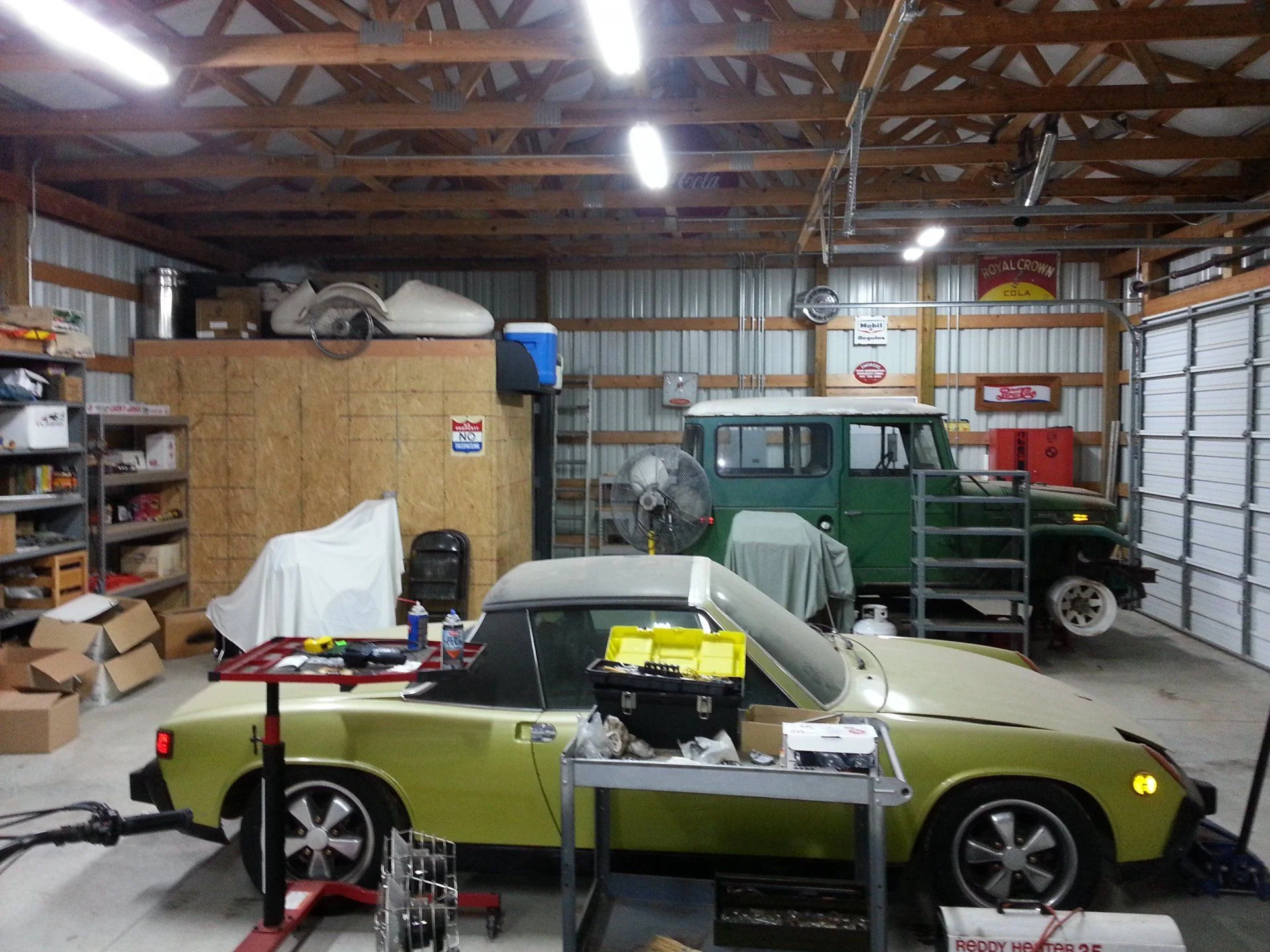

40s and P-cars go together like peas and carrots.

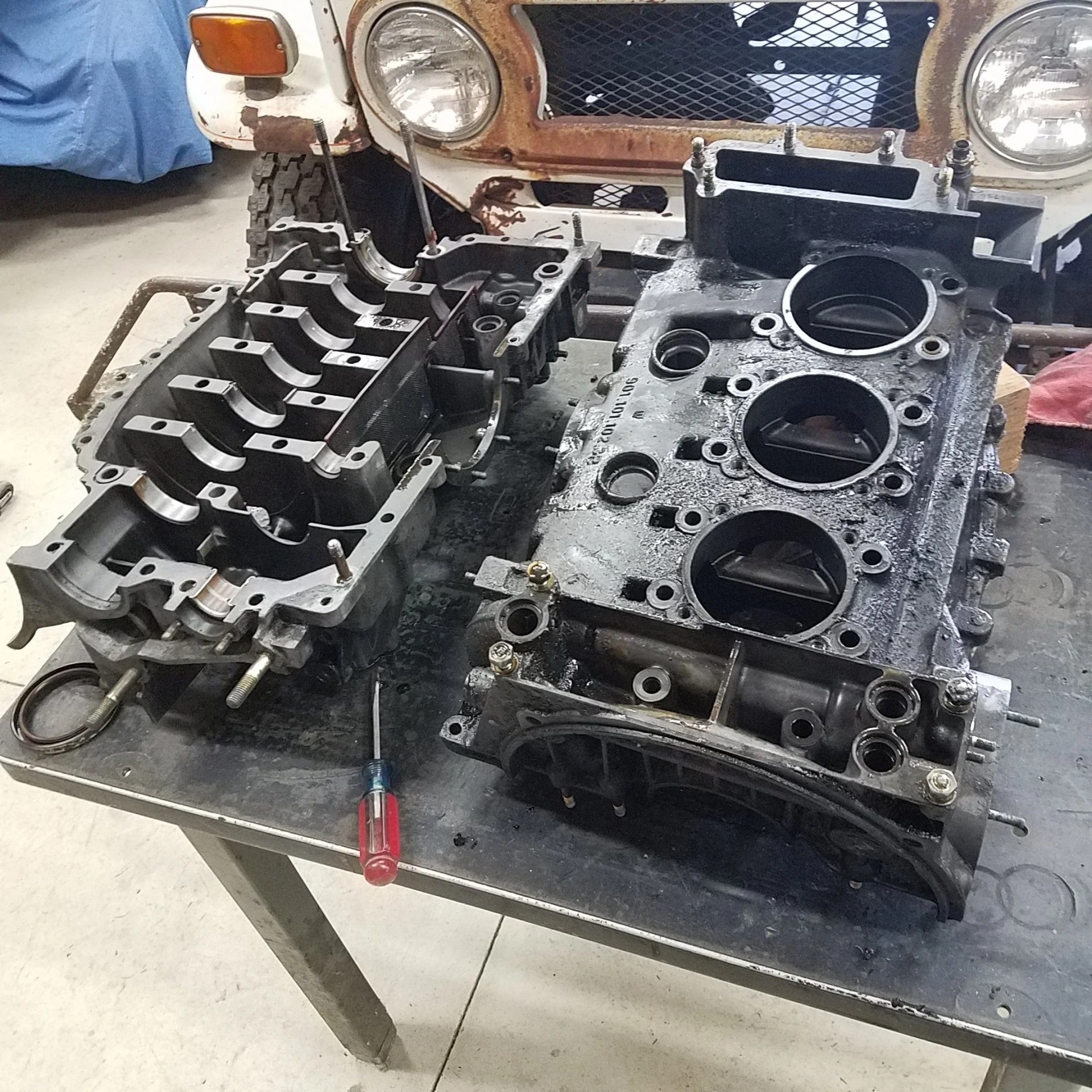

Good one Mark!
