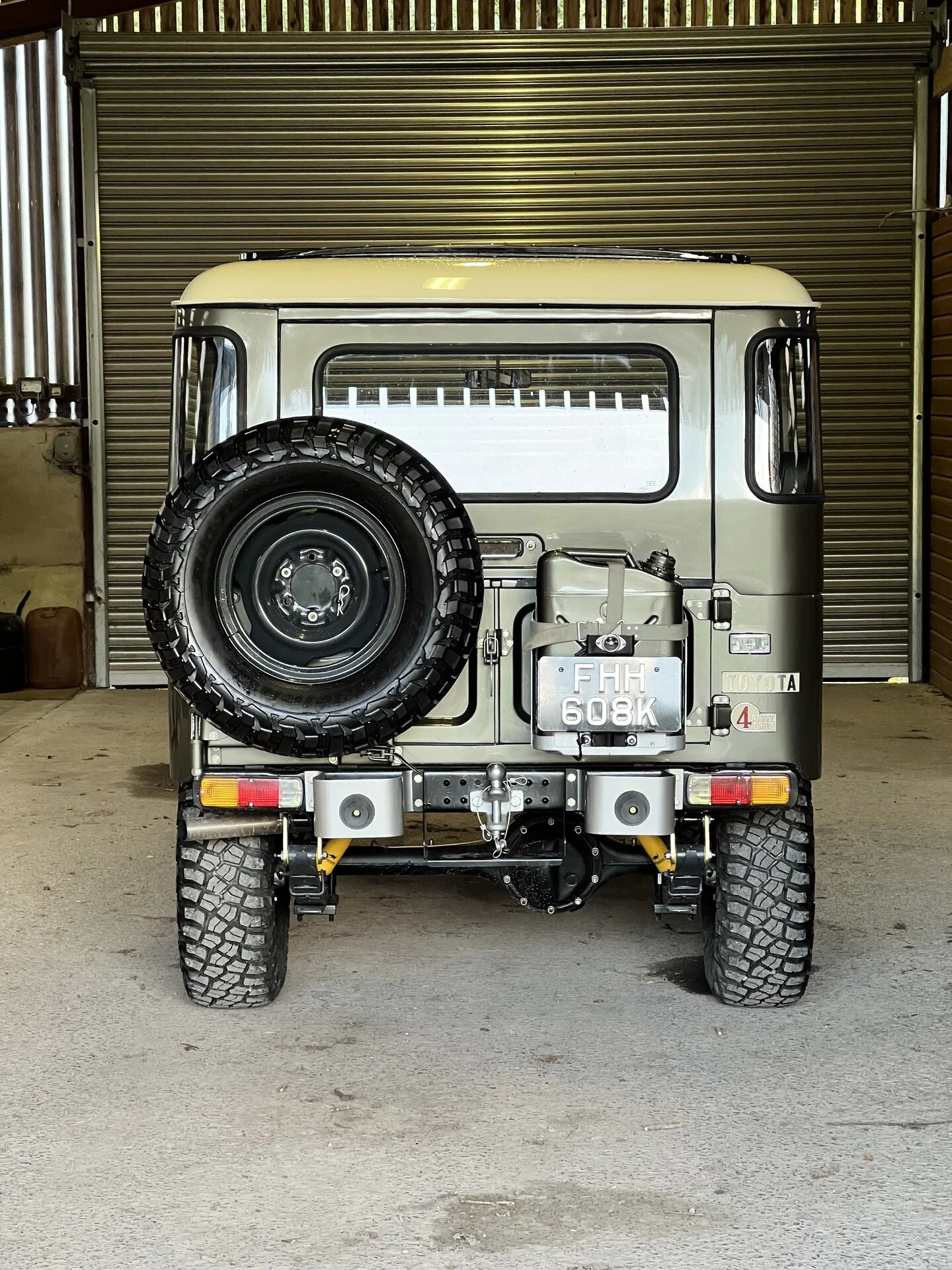

Do you have a picture from the back showing the Australian market tail lights? Australia required amber lens on rear tail lights back to the early 1960s. At first amber turn signal lights were added below the round tail lights. By the mid 1960s Australia had its own rear frame crossmember. It had a rectangular cut out like the 9/73+ just narrower. Was probably pretty easy to widen the opening towards the center.
