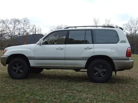

I bought the 30mm rear spacers from Slee ($47) and the diff drop kit ($245). I spent total $300 plus shipping and cranked down on the factory torsion bars. I am very pleased. It lifted the rear about 1.25" and I leveled the front. My ride is still factory Toyota and still drives very nice. I rarely will go offroad in this truck (that is what my 40 is for) and if in the future I put a ARB or Slee front bumper on, I will upgrade the torsion bars then. Just a different option if you don't want to spend big money.

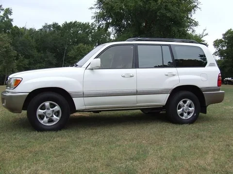

Before (no running boards, no lift, michelins)
After (285/75-16, rear spacers, OEM TB's)
