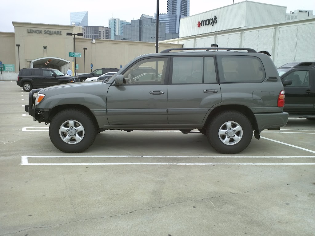

They are actually officially 34.6" Nitto Trail Grapplers 295/70/18 (but they measure just a hair short of 35"). They rubbed a little on full lock where slight G-forces were in play (i.e. turning sharply into a parking lot). Adding a lift after that did not change a thing as far as rubbing was concerned. I could have adjusted the turn stops out a little but I knew a full lift was coming so I didn't do it. It was only after I installed 1.25" spacers and Carl's UCAs that the issue was completely corrected.
You do have to trim the wheel well plastic a slight bit and grind down the pinch weld underneath but that is a given for larger tires with this vehicle. In summation, I could have easily run these tires with very minor modifications on a bone stock 100.
Here are some pictures of how it looked in a couple stages for reference:
33s - 285 BFGs on 16s - no lift (ran this for about 2 months)
35s - 295/70/18 Nitto Trail Grapplers - no lift
