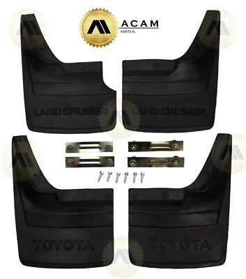

Reproduction mudflaps on ebay
I recently had my truck redone and the mud flaps were a sticking point for me. By design the metal backing on the stock flaps hugs the wheel well, and slowly degrades in the elements and will eventually rub
the options were either these eBay units for 400, restoring the old flaps that didn’t really protect anything for about the same or more, or try aftermarket alternatives

Just wondering if anybody has tried the repro mud flaps on ebay?
I bought some a while back and they are still in the packaging in the garage. I ended up cleaning mine up but would get rid of them if you are interested. Just shoot me a PM and I will pull them out and take a few pics and send a price. They look like quality to me. I just never did the change because my brackets were kinda rusted on and a few other projects got pushed to the front of the line.
