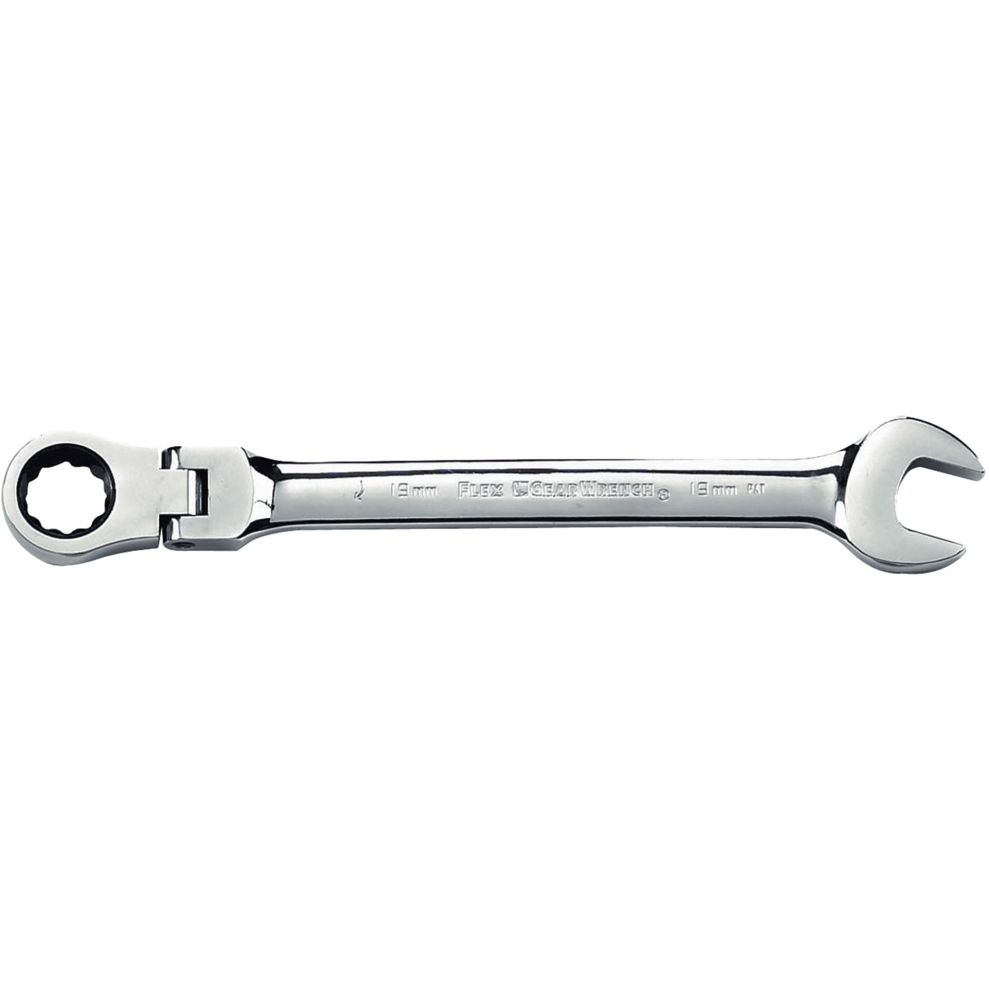

Don't need to drill holes for rear shocks. Some do it but in my case it would have been totally unnecessary. Granted my trucks are from dry country with no rust. Proper tools had rear shocks changed in about 15 each.
Spray upper bolts a few times over preceding days with some like PB blaster and get an angled ratchet boxed end wrench. Did my wife's 2000 with no issue.

It shows a slightly different tool for the top nut than the angled ratchet shown above but either will work. The angled ratchet is gonna be cheaper. It worked for me on my dry 2000.
The fronts are just a remove and replace affair - up on jack stands, remove the wheel, remove and replace the shock. Standard ratchets and spanners will work. If there is rust present (and even if there's not) spray some PB Blaster or similar penetrant on all of the nuts (front and rear) for a few days before you do the job.
That's the same tool I used on my 2K. Worked fabulously. Just did all 4 shocks on an 03 LC last Friday and they were all 22mm not 19mm and too big for that wrench set. His were all OEM Toyota (lasted 140k). Rust free and we did all 4 in 1:45. The trick for the rear is to have a 2nd man on a strap wrench from the well side while you're on the nut from under the vehicle. Dropping the spare creates space to sit.

The rears posed a bit of a challenge as everyone described. The issue was getting them loose at the top, and due to the lack of space, some ingenuity was required. I was able to slide the wrench in position, then extend the wrench with another wrench for additional leverage. With the vice grips on, it was a matter of a few tries until the nut was loose. From there on, smooth sailing to finish up the process.
