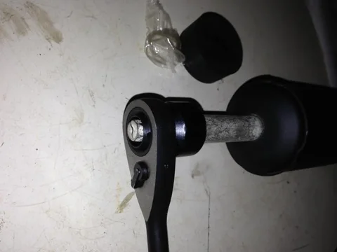

This is key because it's low profile on the nut, but you can still slide a pipe over the handle. A regular wrench or even the ratcheting wrench has the crow foot on the opposite side that you can't slide a pipe over

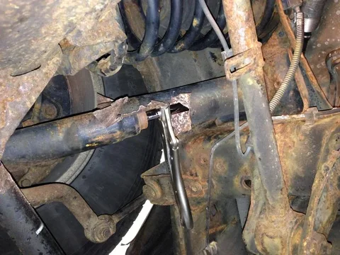

Cutaway the shock to get a vice grips on the piston. I used a tin snips to cut it away:
I had to get that unbelievably tight to keep it from spining.

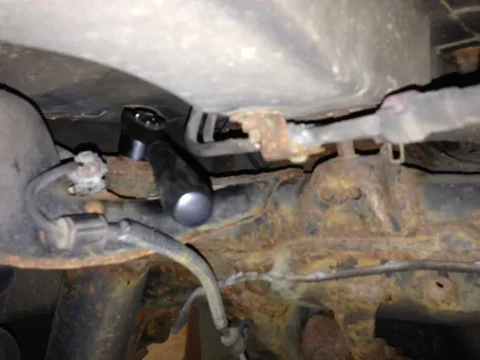

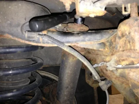

Get the tool on the top nut like this:
and watch out for the fuel lines:
I bought a 12" and 8" piece of 1" pipe and put those over the end of the wrench and was able to break the nut free on the drivers side. Only was able to loosen the nut about 4 clicks of the ratchet at a time, but I got it off.
