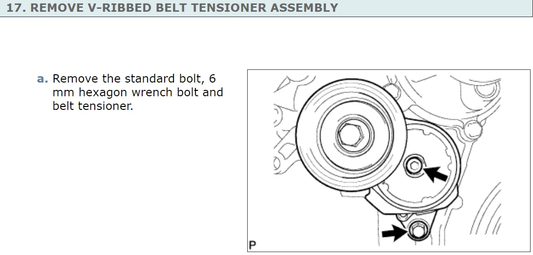

Requesting a little help. I replaced my tensioner pulley, and not the full assembly. Mostly due to the fact I didn’t have a 6mm wrench I could crank on, but I had already dropped the lower bolt on the assembly. I have the belt back on and can’t seem to get the 12mm standard hex bolt to go home. I have now confused myself as to which bolt goes to the under carriage, and to the tensioner assembly. See pic.I am pretty sure it’s the longest one, or at least I hope bc otherwise I stripped it somehow. It’s also possible I need to take tension off the system before tightening this up, but wanting to avoid that bc it was a pain for me to releases tension and get the pin in place to hold the pulley. Thoughts? Did I lose the right bolt, strip it, or need to get tension off the system?
Requesting a little help. I replaced my tensioner pulley, and not the full assembly. Mostly due to the fact I didn’t have a 6mm wrench I could crank on, but I had already dropped the lower bolt on the assembly. I have the belt back on and can’t seem to get the 12mm standard hex bolt to go home. I have now confused myself as to which bolt goes to the under carriage, and to the tensioner assembly. See pic.I am pretty sure it’s the longest one, or at least I hope bc otherwise I stripped it somehow. It’s also possible I need to take tension off the system before tightening this up, but wanting to avoid that bc it was a pain for me to releases tension and get the pin in place to hold the pulley. Thoughts? Did I lose the right bolt, strip it, or need to get tension off the system?View attachment 3793753
By far the easiest method to manipulate the tensioner is from the bottom. Remove both skids and the center spine part. You'll then be able to get a breaker bar in there to move the tensioner.
I prefer to do all of this with the belt completely out of the vehicle.
That said, the two left bolts in your picture are for your skids. More info:
I'd also strongly suggest getting a set of allen bit to 3/8" square adapters to do the whole tensioner. Yes just the pulley will help, but the spring in the tensioner does weaken over time and there are reports of people not being able to solve belt noise until they fully replaced the assembly.
Bingo. The Allen bit adapters were the way to go, thanks for the advice @bloc . Only 14$ at harbor freight. I switched out the assembly pretty easily. It was the longer bolt FYI. I was working with the center spine in previously and making it harder on myself. That cleared things up. The link to the skid plates was useful for reinstall since it was now a week later as well.
