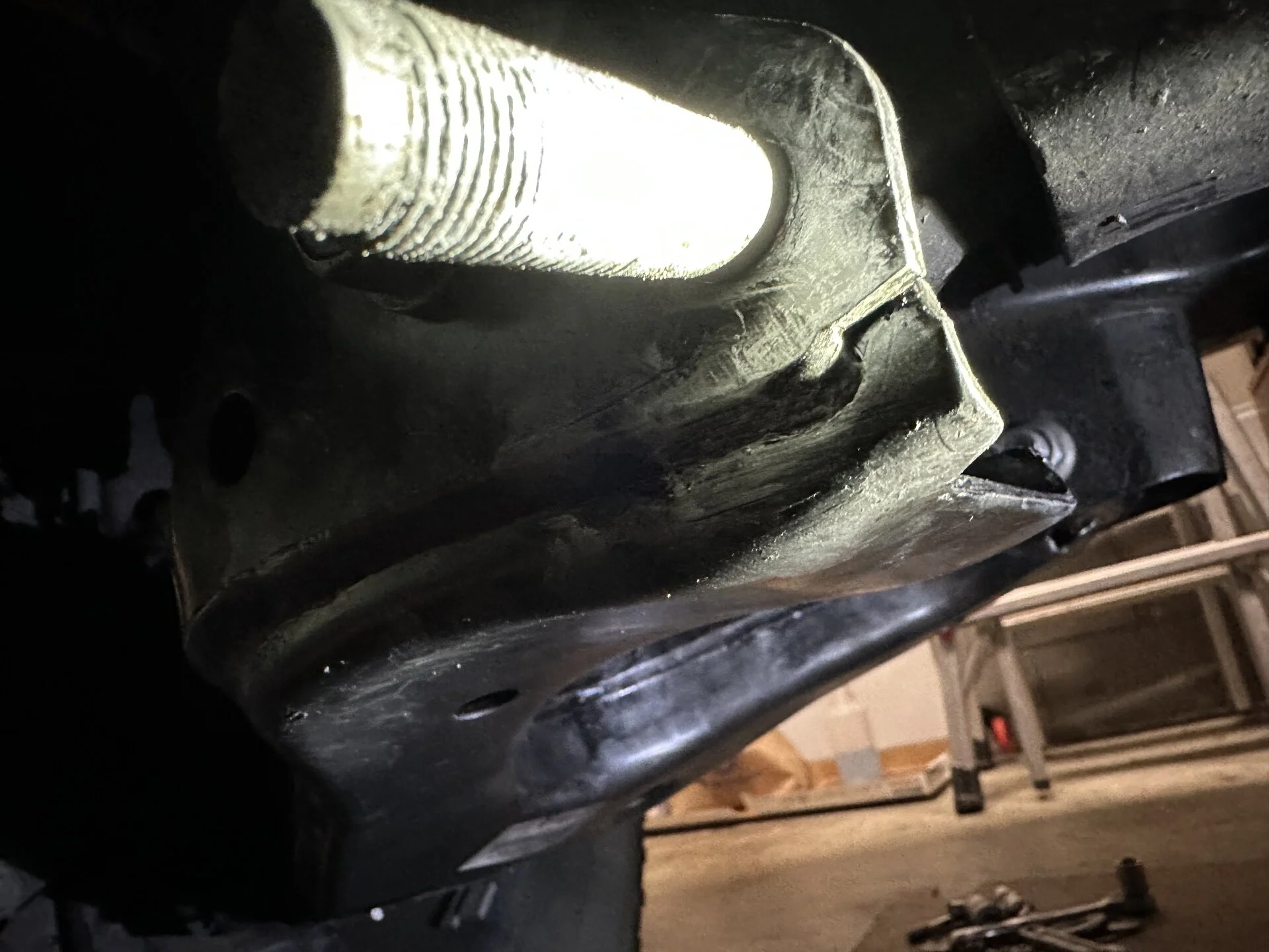

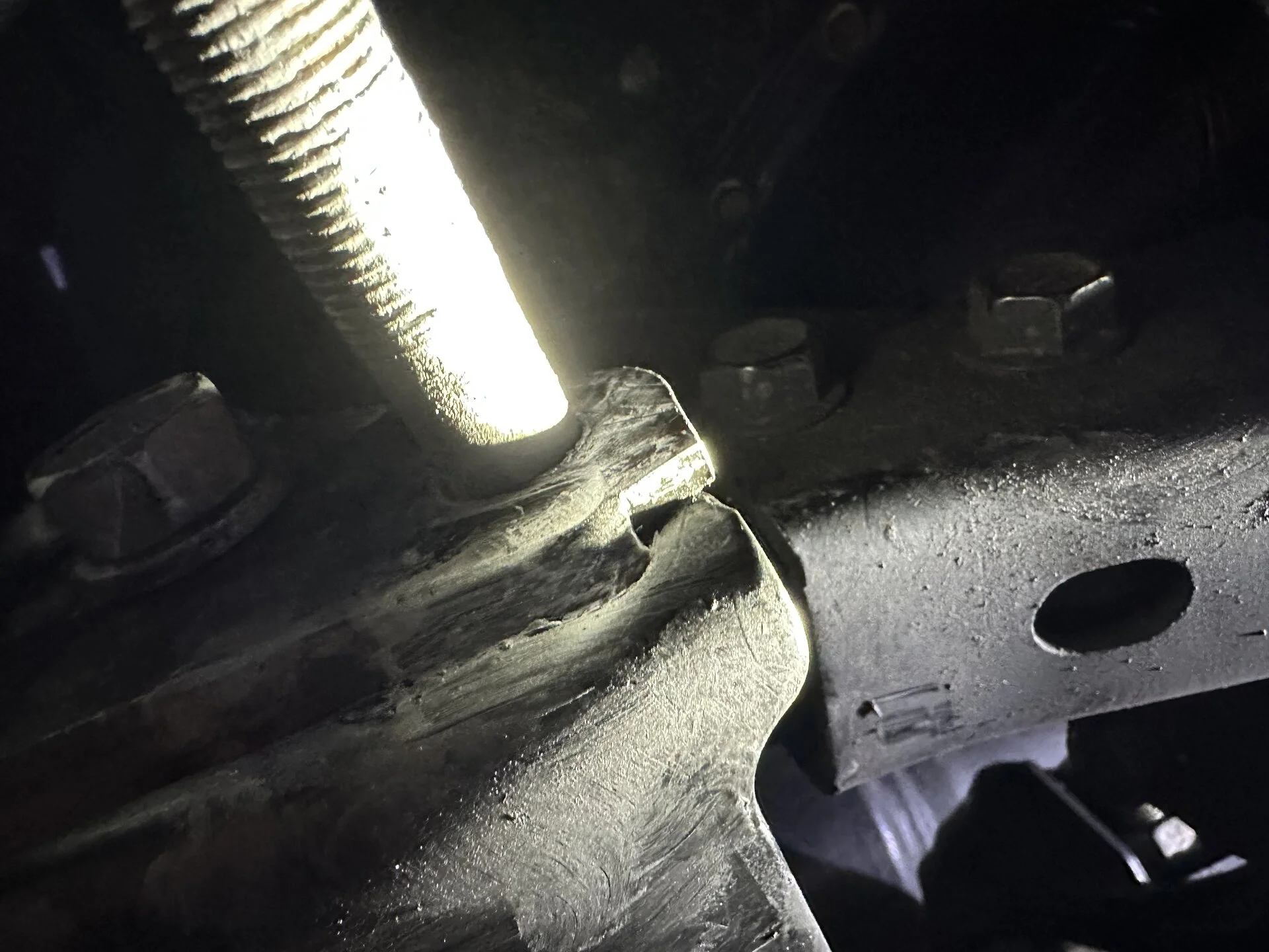

I've been trying to wrap my head around the spacer issue - the above picture seems to clarify:
There is no spacer under the left (front?) of the bushing, so it protrudes too far through the frame for the LCA to clear it. By adding spacers the bushing can be less deeply seated, so it protrudes out the back less, and a LCA with a slightly smaller spread can be mounted.
Correct?
Correct?
Correct!
It can be either the LCA or the Frames spread, that's being corrected for fitment. By adding spacer to get a relaxed fit.
I found the need for more spacers twice. Both times, a new or replacement LCA was used. Both times it was only on left side. Both times evidence of impact, to left side front of vehicle frame and or LCA.
In the one, where a new LCA with 3 spacers added. Driver/owner said afterwards; "steering stop pulling to one side, for the very first time".
In one I just did with a restored LCA. LCA would have had the most relaxed fit, using 4 spacers. But only 2 spacers used. It was a battle installing LCA. A battle won, with crowbars to force (sideways) rubber of bushing into submission.

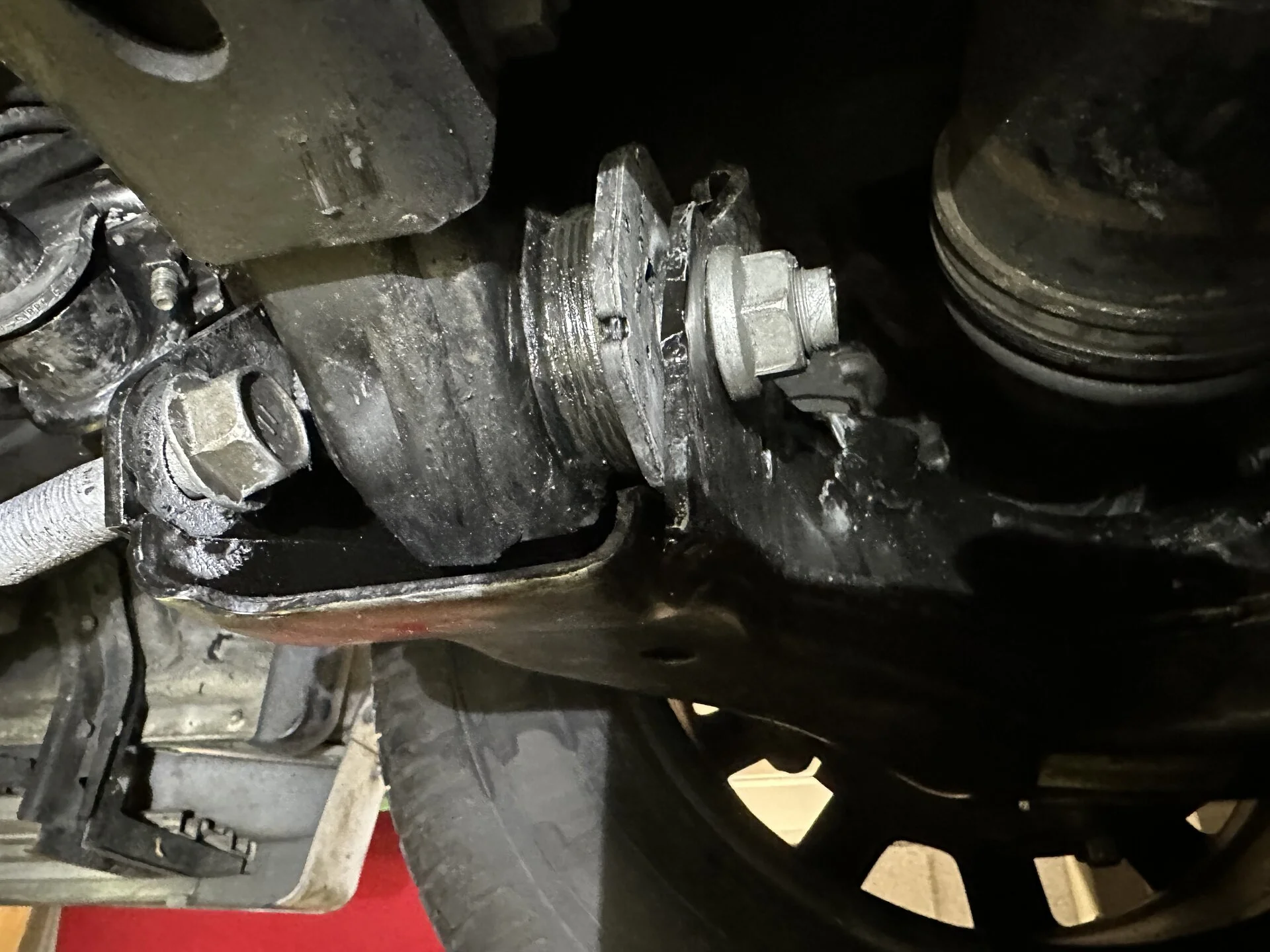

Thanks @2001LC and @y5359 for posting about your conundrum with the spacers. I'm in progress with this job and it looks like that I too am about to join the three spacer club!
I purchased new OEM LCAs from Toyota of Decatur during one of their mega-sales. I slowly made my way through the RH side first, installed a new No2 with 1x new spacer, and the new LCA slid right in.
Then I got to the LH side, pushed in the new bushing with one new spacer, and went to try and install the LCA and sure enough, it wouldn't fit! Thank goodness for this thread or I would have thought I was going crazy. I added on the two extra spacers I had from the two old bushings and installed it again, and the LCA fits much better. Not quite as good as the RH side, but still much better than before.
I took some rough measurements and it does appear the new LCA is about 3/8" narrower (maybe 1/4") than the old one?!?!
And just as a reference point I never had any alignment or pulling issues before, and it doesn't appear this LX has ever been in an accident. So I'm inclined to think this might be more of a LCA manufacturing issue as suggested by @abuck99? Who knows!
Anyway, I get how this is not ideal, but not sure what else to do here. I think I'm going to give this a shot unless anyone has a better idea!
