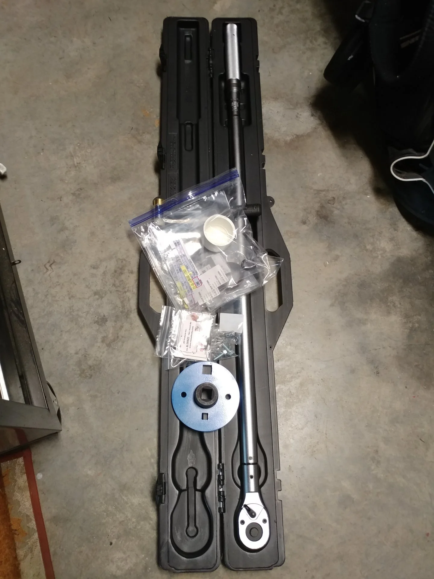

You can definitely do this one yourself. I would recommend you look into what tools you'll need though. The biggest (most expensive) tool you're going to need is the torque wrench to install the crank bolt. The crank bolt on the 1FZ is tightened to 304 lb/ft of torque, you'll need a big ass torque wrench for that bad boy. I'm sure some of the guys will be able lend a few tools or bring them when they help out. An @OTRAMM crank pulley tool will help remove and retighten the crank pulley bolt.
The rest is pretty straight forward.
Edit: Here is the crank holder tool that Ryan makes: 1FZ-FE Crank Holding Tool - https://www.otramm.com/1fz-fe-crank-holding-tool.html

That would be great! Just like the knuckle rebuild, I can prep and do all the preliminary stuff... Remove the fan, fan shroud, etc. Then all that would be left is the actual job itself... Crank bolt removal and oil cover.
OTRAMM gave away a couple of his crank holding tools as raffle prizes at the last CRR. See if you can track one down and borrow it.
Thanks! I'm gaining confidence in doing this myself. One experienced person to watch me would seal the deal. I may just order this tool.
Thanks! I'll just buy one. Always good to have for the next time.
