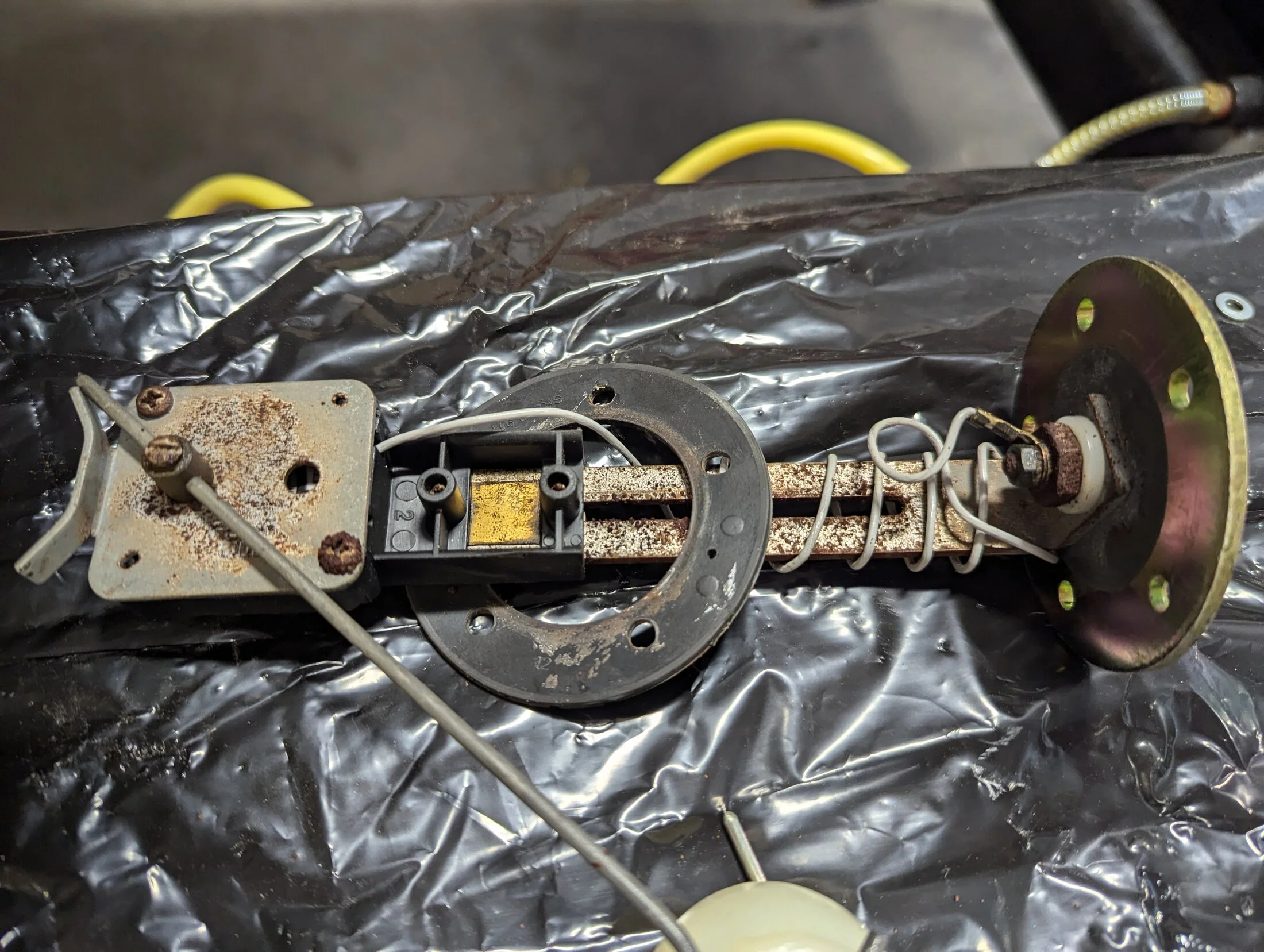

I was having a similar issue with my LRA gauge for the 25 gallon tank that was installed by MLO for my 1993 HDJ81VXL. The sending unit was bad and MLO installed a new one from LRA who also sent me a new gauge. LRA was very helpful. MLO installed the new sending unit which still didn't solve the problem even through they said it worked fine for them.
I talked to LRA again who said the sending unit was likely not properly installed.
I bit the bullet and decided to do the job myself. Drained and dropped the LRA tank, removed the sending unit after checking all the wiring to make sure everything was connected correctly. I put in one of these:
REPLACEMENT Tanks Inc. Floatless Fuel Sending Unit $124.95
0-90 ohm (find out correct tank depth)
Floatless Fuel Sending Unit - https://www.tanksinc.com/index.cfm/page/ptype=product/product_id=346/category_id=184/mode=prod/prd346.htm
Works as it should now and I have an extra gauge sitting on the shelf if I ever need it. :banana::banana: :banana:job for me because I don't have a lift or dedicated garage space. Took a weekend to do and the only issue was getting the tank back in position to bolt back up which I used a piece of wood, ratchet straps and a floor jack to get it in position.
I sent the information to LRA who said they would look at this sending unit as a replacement/upgrade in the future for those who want it.

As long as the switch is working, (I used an ohm meter to check) the pump will push fuel from the aux tank to the main tank. The problem I had was the sending unit was bad the first time and not properly calibrated when installed the second time. I worked around that by installing the “float less sending unit” I posted so I didn’t have to worry about the adjustments to the float on installation, just the depth of the tank.
I put more secure connections to the sending unit on the new installation so I wouldn’t have to worry about water or connection. All good after the new installation.
