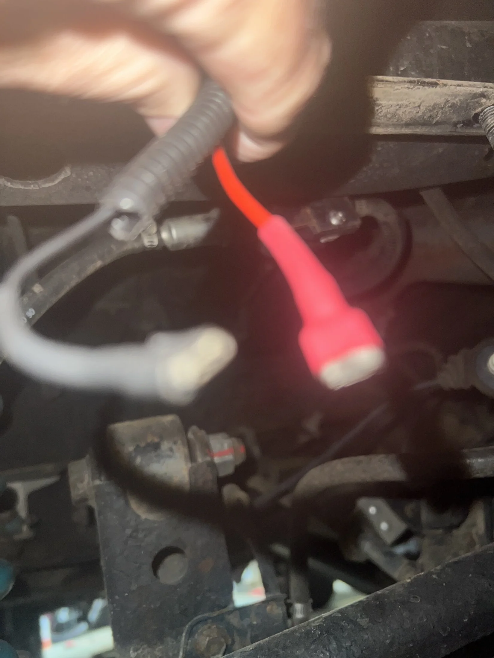

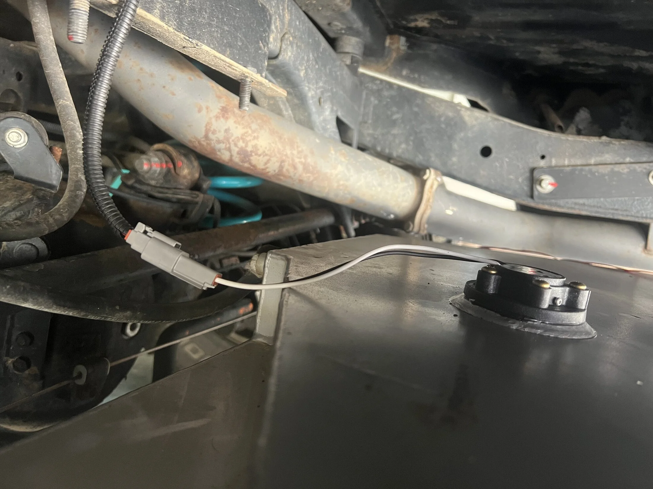

I wanted the same as you and reached out to LRA for the tank depth. I got the same advice I am giving you. I bit the bullet and measured it after I dropped the tank. I also saw the wiring connection on the old sending unit and replaced it with better connectors. It's worth the time. :banana:
Original connectors. Blurry picture...
New connectors.
