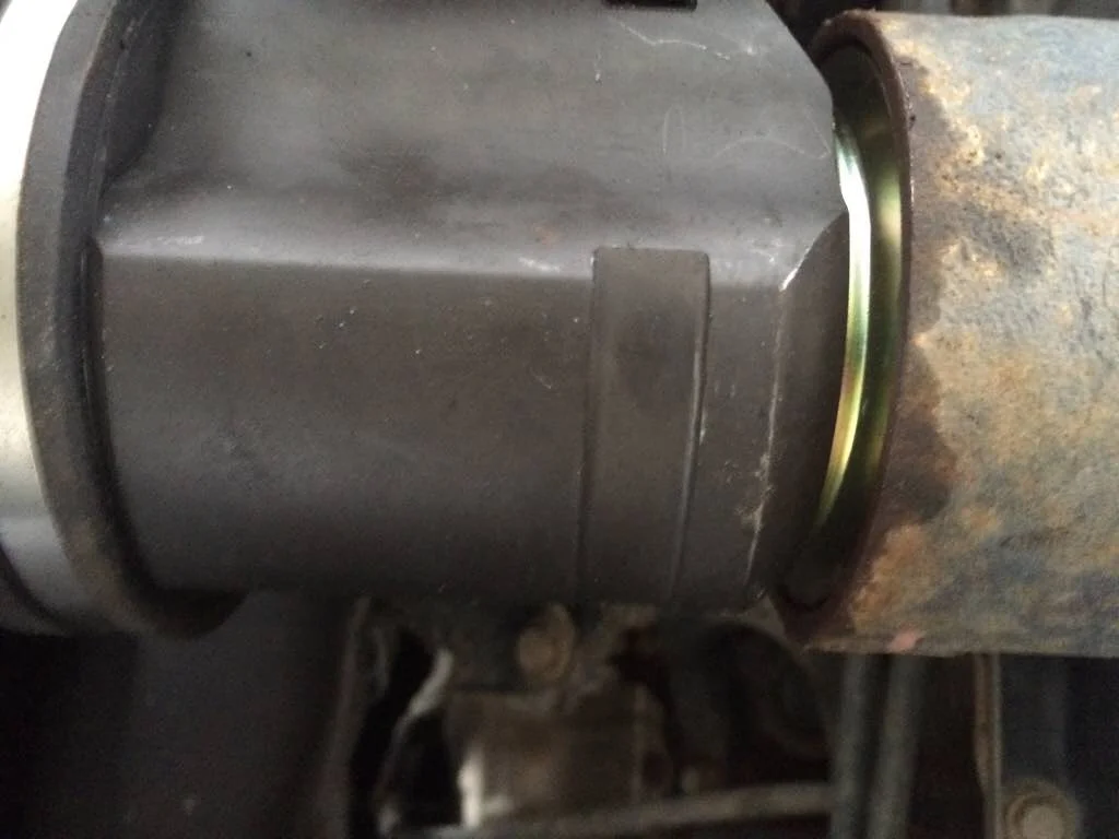

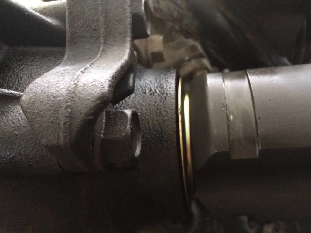

I got the passenger side to slide in without too much effort and seat in. The driver side seems to have popped out a bit:
should the zinc flange be farther in like it is on the passenger side? Is this gonna leak or fail?
You should be fine. My driver side did the same thing. I had it flush with the housing, and after driving a while it shifted out a few mm. The next time I pulled the axle, the spring clip was still fully seated. It was just as much of a pain in the ass to remove the axle, as the first time. If you have driven it around, and you don't have oil residue running out the side of the housing, then you should be good to go.
Great! I think I remember the original axle that I replaced was hanging out the same way. I just wanted to be reassured before our 1000 mile trip to Glacier NP and the salmon river that starts in about 15 minutes.
